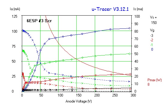

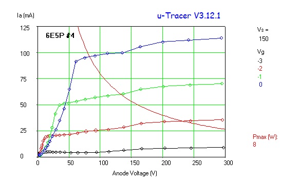

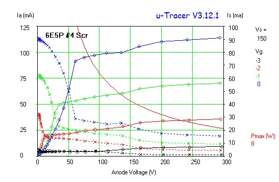

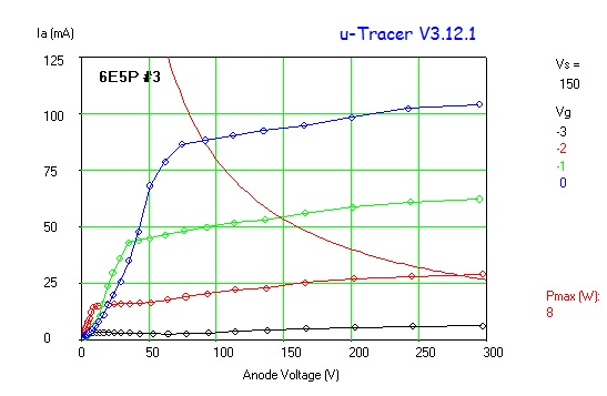

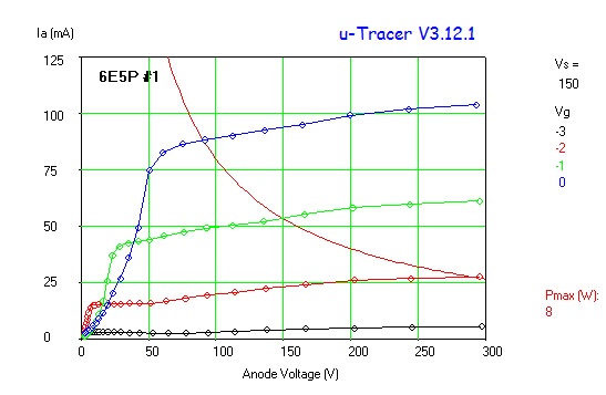

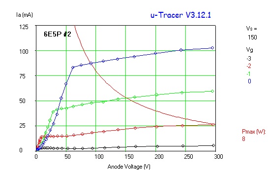

some 6E5P curves
Hi Bigun,
I measured 4 samples of these tubes (tetrode mode) this morning, here they come. The last two are also for sample 3 and 4, but show Screen current as well.
Cheers, Erik

Joined 2009
Wow Erik - that's great stuff !
When I look at, say the 2nd chart, I can see that my measurements are not so far off. At around 230V anode with -1.5V or so on g1 the current should be around 30mA to 40mA. Seems that my tubes are operating same way you are measuring.
You have a very handy piece of equipment there !

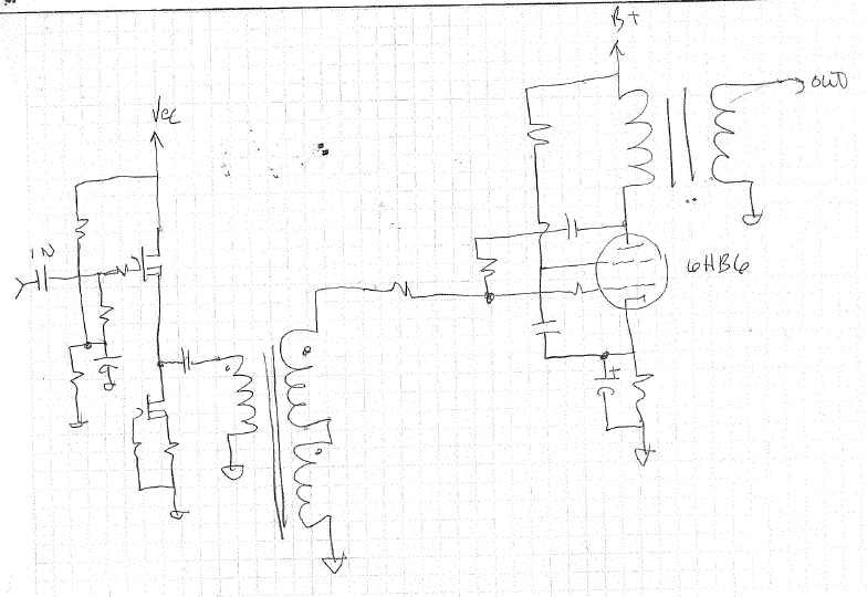

Here's a possible "Spud with Help" using the 6HB6. This could be put together with all three building blocks (follower, XFMR, 6HB6), with just follower or XFMR and 6HB6, or with the 6HB6 alone. An "Almost Spuddy" (certainly minimal) P-P amp could be put together with a transformer with 2 secondaries driving a pair of the 6HB6.
Nelson Pass used a Jensen JT-11 variant with dual secondaries to drive his complementary SIT amp presented at the 2013 Burning Amp. Here the dual secondaries could be used to eke out a bit more voltage gain if desired.
I have all the bits necessary to try this, but not the time, as I'm busy completing other projects already in the works for the 2015 burning Amp.

... An "Almost Spuddy" (certainly minimal) P-P amp could be put together with a transformer with 2 secondaries driving a pair of the 6HB6.
I have some Hammond 1:1 c.t. transformers somewhere that would make good phase splitters for a PP 'spud' amp - that could well be the basis of another project.

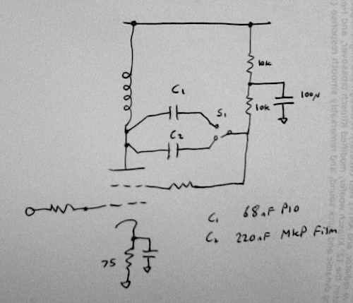

I've been messing around with it again.
1/ Heater: I thought that with me only using it at lower current that I could avoid the power waste with the 6.3V winding and try the 5V winding. Unloaded it measures 5.2V and loaded it's 5.13V. The tube powers up and draws normal current but the cathode is now a dull red instead of a bright red. I'll try it like this for awhile. I'm measuring 2.3V on the cathode, across 75R that's 30mA.
2/ Treble needs some roll-off: I have added a switched capacitor between the anode and g2. It's a kind of feedback, reducing gain and output impedance in the treble. It's a kind of triode-wired-treble.
Listening - the trioded wiring cuts down on the sensitivity, the volume control needs to be at 2/3 instead of 1/3. However, it does work in rolling off the treble to produce a more balanced sound and less harshness all around.

How can you 'resist' such a nice cake 🙂
Well, I'm now listening with this new topology, a 220nF cap from anode to screen grid seems to give the best balance. More tweaking still to be tried.
