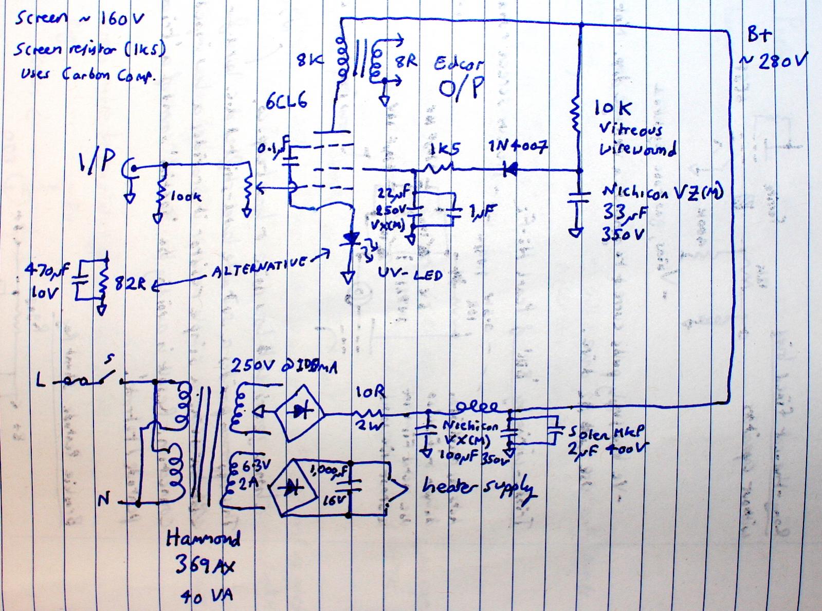

Here we go. From what I've read on the internet this design was originally by a chap called Jef Larson. Seems he was a fellow DIY'er. The schematic was improved on and tweaked by some other chaps, a Jerry Curtis and a Terry G but I think the main approach is what I've captured here based on all the tid-bits I can find. It's simple and looks like a good start.

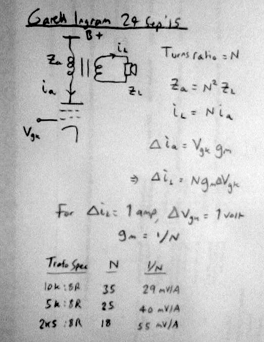

So we have to worry about the transconductance, the gm. How much gm do we need ?
Not sure if my math is clear (attached).
Here's how I'm thinking. I have an OPT with a turns ratio of N between primary and secondary. A voltage signal applied between the control grid and cathode produces a current swing through the anode equal to the input voltage swing multiplied by the transconductance.
The current swing through the anode flows through the primary of the OPT and is reflected into the load according to the turns ratio. For example, a turns ratio of 10 means that 100mA change in anode current will generate 1A of swing through the load.
If I want an input voltage swing of 1V to produce a current swing of 1A through the load then the transconductance of the control grid (wrt to the anode) must be the reciprocal of the turns ratio.
The OPT I have can be configured for 10k, 5k or 2k5 into 8R and from this the turns ratio can be determined. It shows that the tube needs a transconductance of at least 29mA/V.
This is a bit of a simple analysis and other constraints will apply e.g. the voltage swing at the Anode must not exceed the normal operating range for the tube so there will be a power limit etc. so a 1A swing in the load is probably to optimistic. This means that the target minimum transconductance will be lower. If I want 2W(rms) into an 8R load then I need a peak current swing of 0.7A so the transconductance I need is more like 20mA/V and for 1W (rms) I only need 15mA/V.
Does this sound right ?

Sounds about right. Of course the delta V on the plate will be increased by the turns ratio from the load too. Class A pentode SE will get you around 1/3 to 1/2 of the Pdiss of the tube for output likely.

That's the one that caught my eye - I've posted the schematic above.
Given that it's a proven concept it would be a low risk option to build - hence the 6P15P tubes I've ordered - Terry likes them - to be more accurate he has tried the SV83 and likes some of the qualities of that tube, the 6P15P is its doppelganger.
I would consider trying an emitter follower for g2 drive though as a possible change to Jef's circuit.

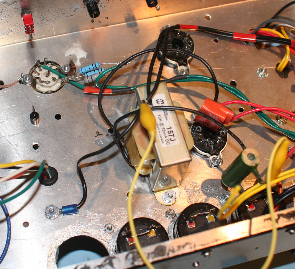

Whilst waiting for the 6P15P tubes to show up in the mail I'm going to see what I can get a 6E5P from my junk box to do.
I've got a Hammond 270DX on my experimenters chassis so I've wired that up. The 275-0-275 HT secondary goes into a full wave SS rectifier made from two Cree diodes (1.2kV rated), then a Hammond 157J choke which is 10H 205Ohm. After that a pair of 500V 50uF caps in parallel.
Power up gets me well over 300V unloaded. Adding a 5k6 load resistor gets me 241V d.c. which is right around where it should be.
I wired up the 6.3V heater secondary to the socket and plunged in the tetrode and promptly measured around 8Va.c. - to high because there is to little loading on the taro. I put around 3R in series with the heater (3 x 10R resistors in parallel) to drop this down to around 6.4Va.c. and saw the tube glow for the first time - nice
Joined 2009

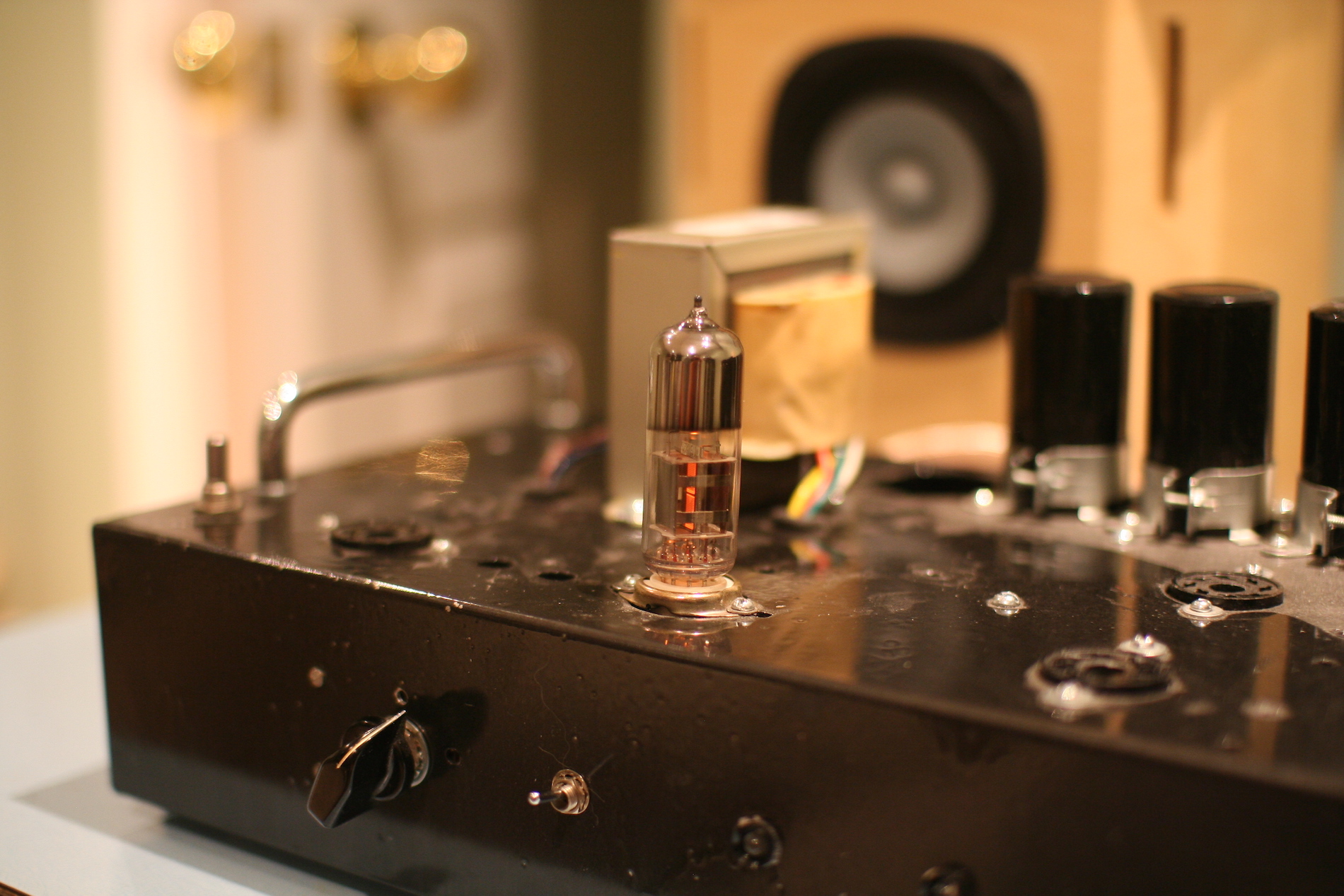

6E5P
More progress. I wired up for the 6E5P more or less as Jef Larson's circuit (no diode in the g2 circuit yet).
I used a 50R pot for Rk and set it at what I thought was 50R but it turned out to be 47R and bypassed it with a Nichicon MUSE 220uF as this was what I had on hand.
I had to string together a bunch of resistors for the g2 supply, total 22k7 from B+ to the socket. I bypassed g2 to ground at the socket using a 47uF 160V cap.
I used a 1k stopper on g1 and wired it to the wiper of a 25k volume control.
Powered up...
The cathode voltage settled out at around 1.57V, implying 33mA cathode current. The screen biassed up around 147V above ground, so around 145V above the cathode. It was drawing around 4mA and dissipating around 0.6W, well below the max rating of over 2W.
The anode was up at around 234V and by deduction the anode current was around 33 - 4 = 29mA. So the anode was dissipating less than 7W, comfortable given that Pa max is over 8W.
So far so good, for d.c. conditions at least.
This tube has a nice open structure, you can see the glow in all it's glory.

It works ! 6E5P in Tetrode
I was just about to get into bed and was halted by a flash of inspiration - I don't remember connecting both leads from the secondary of the output transformer ?!
I just went back down to the man-cave and checked. Yup, the '0V' tap of the output transformer was floating. I quickly soldered it to the amplifier ground / ground speaker terminal. Clearly, what I had been listening to was the signal leaking through the parasitic capacitance between the windings of the OPT and generating a small voltage with respect to ground.
All is well. The amplifier works! There is sound - plenty of volume, bass and all the rest. It's too early to say how good given the limitations of the iPad headphone output + MP3 but now I can go to bed.

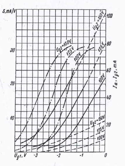

Attached is the limited information from the data sheet that lead me to believe it can be quite linear in tetrode mode. But the tube I have doesn't seem to match with these curves - I'm getting less current than I would expect.
My operating point is with g1 at around 1.5V and g2 at around 145V. I should be seeing a lot more than the 30mA or so of plate current I measured. I have a few more of these tubes so I may try another one to see if it's the same.
