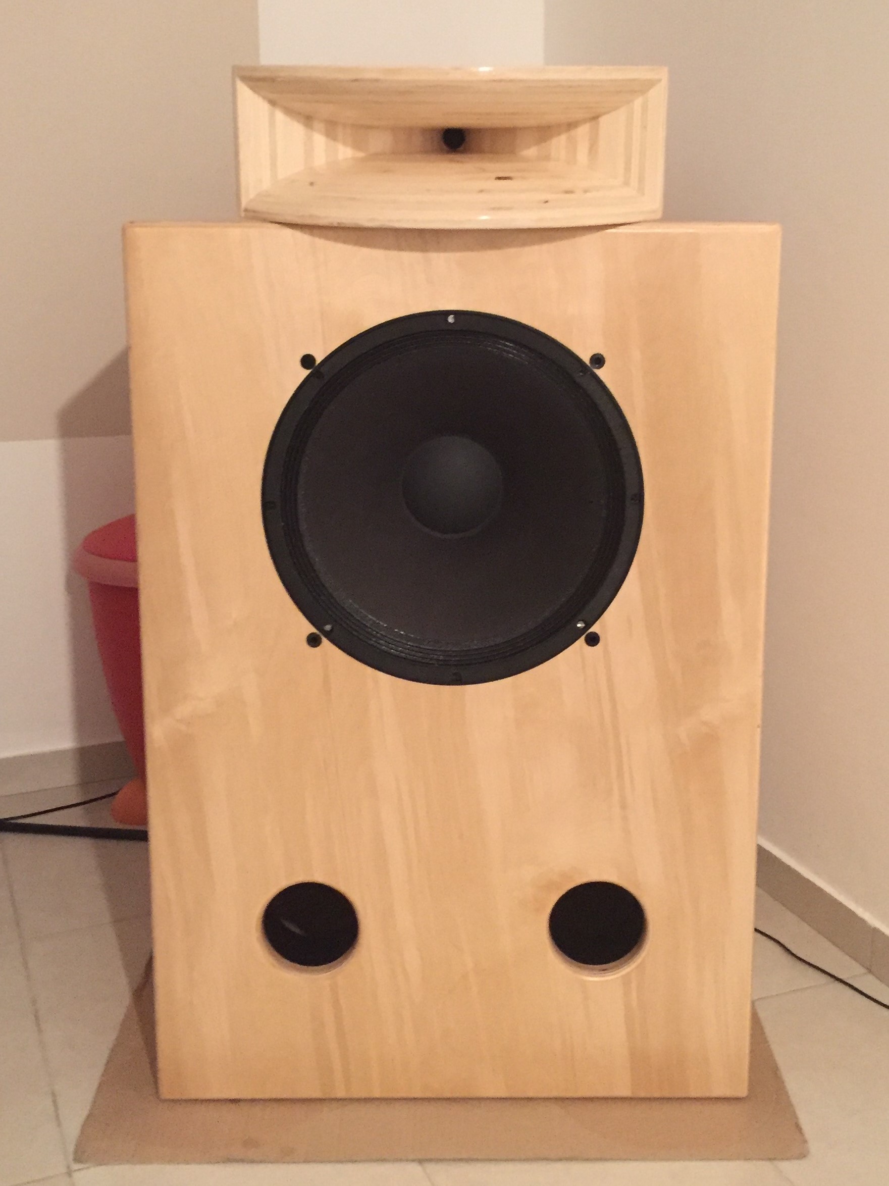

Sorry, I kind of forgot about that. The speakers are made and burn-in slowly. The sound is very interesting, fast, clean, accurate. I am very pleased with this project. I drive them with a single ended 300B, 7W per channel. They can play very very loud, without any restrictions when choosing music (classical, rock, jazz, pop, electronics).
I am attaching a picture of the finalized speakers. In the end, due to the reasonableness of the dimensions, I decided on a bass reflex box, as the Onken would mean approx. 30% more volume, but they are already so huge. I didn’t want to compromise on the bass response and I wanted to drop them as deeply as possible.

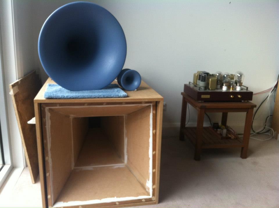

Well, that's a very good question. I didn't try the 1505B, but I did have the 'smaller' 10 cell horn, 805 model. I thought that horn was cleaner/nicer sounding than the 811 and 511 bi-radial horns. Of those two, I definitely liked the bigger 511 horn, especially if using a large format (1.4 inch) driver.
The first horn I built was the Yuichi 290S (with fins). This is a good product and operates very well. I was lucky that my client had invested in expensive Radian Beryllium 2-inch drivers, which made the sound really sparkle. The other three 'modern' horns I've either owned or built into systems are the Azura 340, the Iwata 300 and Jabo 300. All three used two inch drivers, and were crossed fairly low, eg 500-600Hz. I think that is a good way to go.
Of the three, I thought the Iwata had the nicest sound....though I would say it's fairly subjective, as each horn is similar in characteristic/size. The Azura (Australian built by Martin Sneddon) uses the rolled back Le Cleach profile, which is excellent. The Iwata does look funny though...a bit like a bathroom sink!
These three horns were paired with:
Azura 340, Faital Pro HF200 CD, 250 liter ported cabinet with Faital Pro 15-inch woofer, crossed at 550Hz. See pic.
Iwata 300, Faital Pro HF200 CD, Open Baffle with dual AE 18-inch di-pole woofers per side, MiniDSP for bass and passive for horn, crossed at 600Hz.
Jabo 300, Radian 950 Beryllium CD, with Beyma TPL-150 AMT tweeter, plus dual 10-inch AE woofers. Active xover for bass, passive for horn/tweeter, crossed at 600Hz/4,000Hz. See pic (with me posing!). Curved CNC'd birch ply cabinetry. Client had very high front-end, with 300B SET mono block amps for horns, Audio Note 45 valve amp for tweeters...and massive Krell SS for bass. A fun project...not cheap.
Oh, I forgot...I also had Stereolabs 300Hz and 1,000Hz stone/composite horns, plus a rough mid-bass horn. See pic of blue horns.

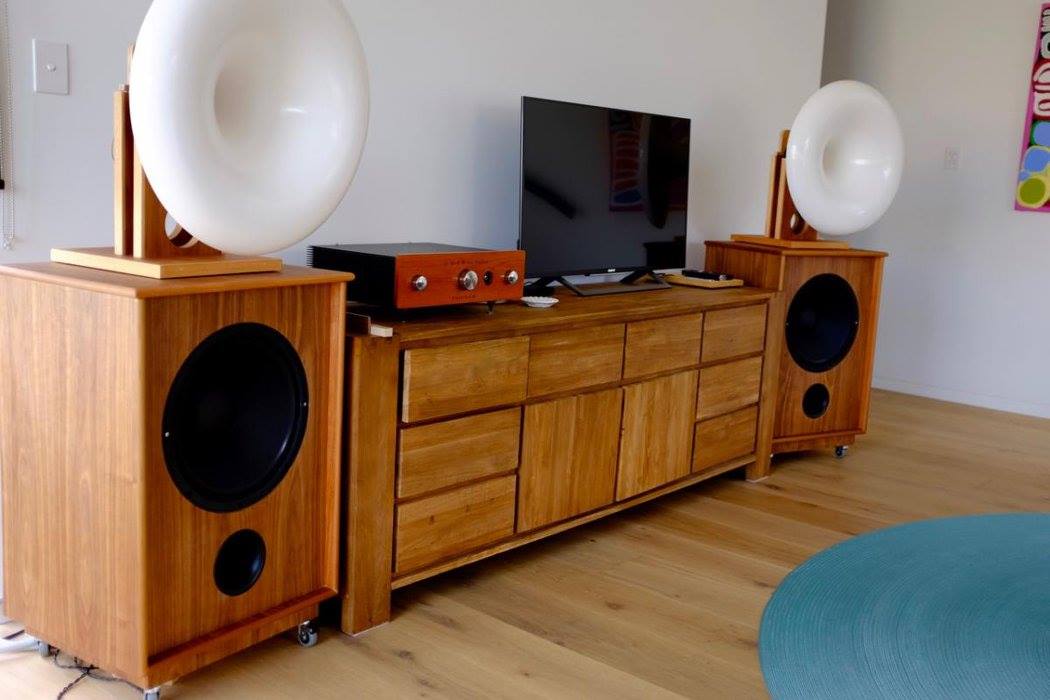

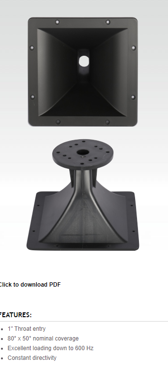

Thanks...though I'm not a horn designer...I'm a horn builder. The Altec 564 Mantaray is constant directivity, which I thought sounded very good. For my new large TV/Channel speaker, I'm using SB Audience CD horns. Their stereo imaging and quality is also very good, given the lower cost nature of that project. (See separate thread.)
https://www.sbaudience.com/index.php/products/horns/horn-h225/

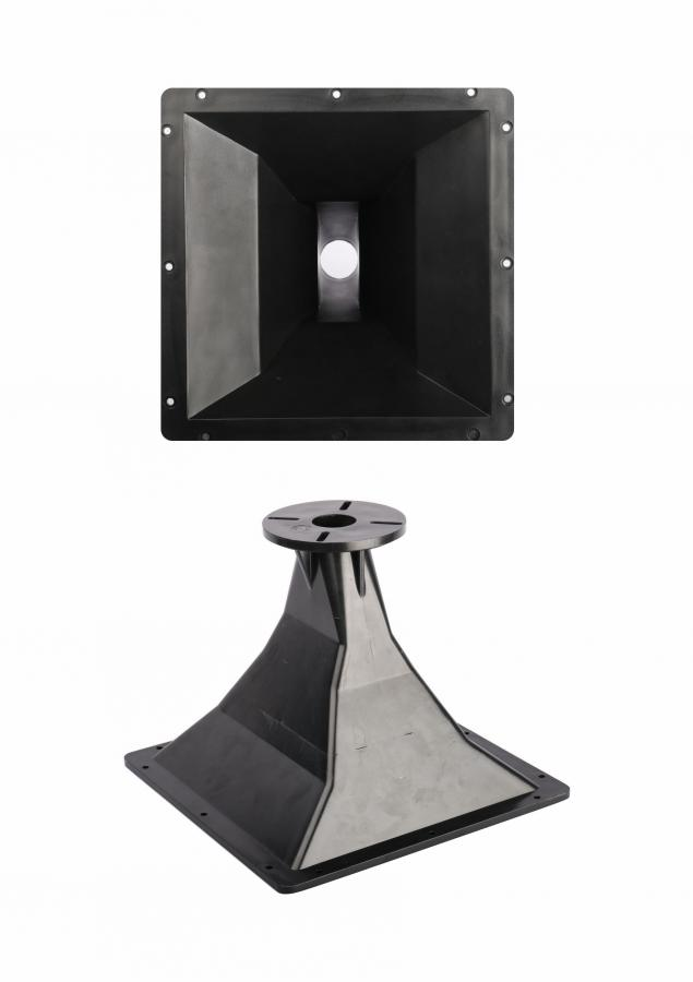

You're probably aware of the 'supposed' drawbacks of diffraction horns?
The Mantaray horns are classics and therefore often cloned. I have a couple of B&C ME60s which is an example.
They sound and work very well above 1000 Hz, below that the reponse ripples increase due to the undersized mouth.
As you may know, SB Audience also sells a clone, the H280.

I'm using the SB Audience Bianco 44CD one-inch driver with 'PEEK' diaphragm. I'm using a first-order passive xover (for now) crossed @ 1,600Hz. This two way stereo system is used as a large TV "centre channel"...so I'm aiming for clear voicing instead of outright critical music listening. Still, I've had many horn systems...and I think my little rig is sounding good.
I've also dampened the horns using silicone on the rear sides.
