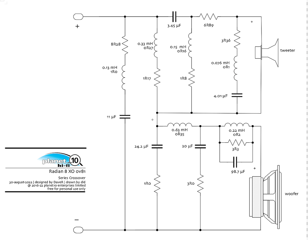

I should note that the odd values came about due to matching pairs from my stash of parts. I try to match components within 1/2% for L/H and R/H crossovers when possible. The measured values of the matched pairs are listed on the schematic.
A few corrections.
L7 is 0.32mH, with .27 ohm dcr (0.33mH, 18 ga air core standard)
L4 is 0.16mH, with .16 ohm dcr (0.15mH, 18 ga air core standard)
L6 is 0.076mH, with .10 ohm dcr (had to unwind a .10mH, 18 ga air core standard) -- sorry the uH "microHenries" probably threw you
C2 is 20.0uF (20uF standard)
R3 is 3.0 ohm (3.0 ohm standard)
L10 is 0.23mH, with .20 ohm dcr (0.22mH, 18 ga air core standard)
Some combinations of standard components were used. For example C7 = 10uF + 1uF (in parallel) = 11uF
Some components measured close to the standard values.

Above diagram updated.
I was going to ask about the 75mH inductor, that would have been painful to source. Most of the errors were forgetting to go back and change the placeholders.

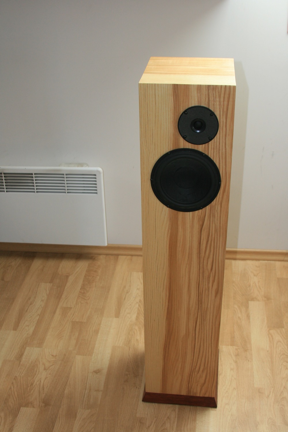

My first speakers where Proac 2.5 clones. Without knowing much about design it’s a good solution to take some others design.

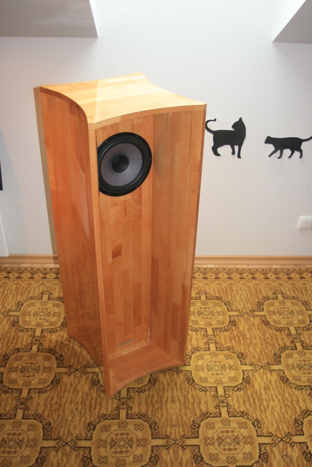

The second was my own first design open baffle speakers in interesting H shape baffle🙂
There is going to be a horrendous amount of diffraction with the FR sitting in a cavity. Is it an FA22 (or its smaller sibling)?
