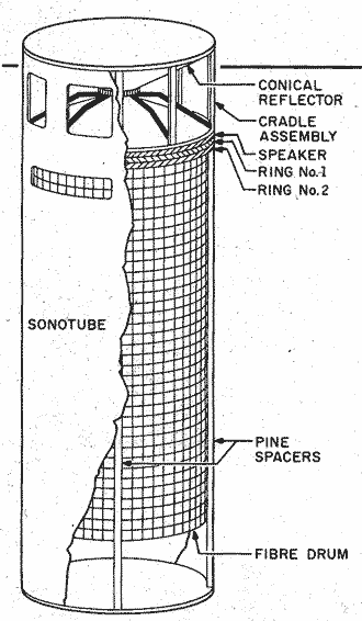

March 2003 issue of AudioXpress about using concentric sonotubes to make a compact transmission line speaker
A redux. More pictures? Drawing?
Speaker Builder (aXp predecessor) Jan 90 had this one:

I remember that one. I had all the back issues of SB.A redux. More pictures? Drawing?
dave
Here's a scan of the article. Hope it's OK to post. I'll take it down if it causes issues.
