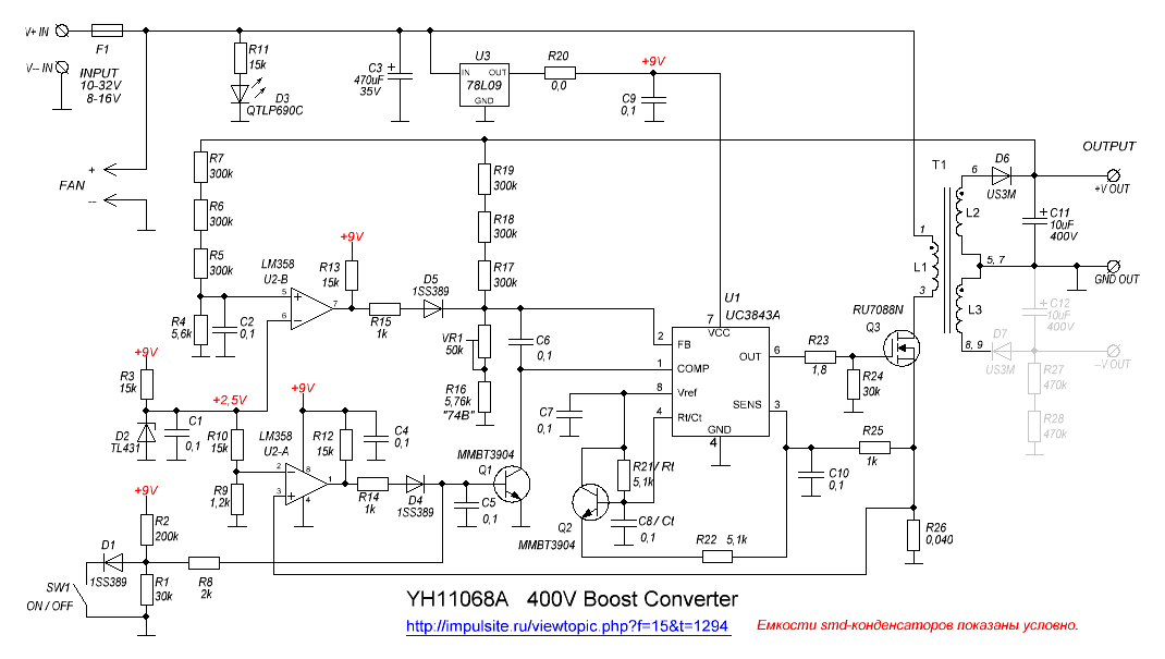

I only recently discovered this DC converter and I have one on the way. I wish to thank the members of this sight for the work already done. I have been working on the schematic and I have attached my version. I believe it to be more accurate but by all means not perfect nor error free.

Bob, pcb version may have changed over the years. As such, if you have noticed differences between your schematic and others then perhaps best to identify the differences, rather than just post another schematic. I quickly noted your schematic doesn't show an input fuse - which may be related to later pcb version, or how your pcb was populated.
Stef, I'm not sure how you conclude that the module 'cannot' be used with tubes ? Perhaps better to identify the serious issues you have noted, and elaborate on why overvoltage protection may be 'sometimes' non-functional.

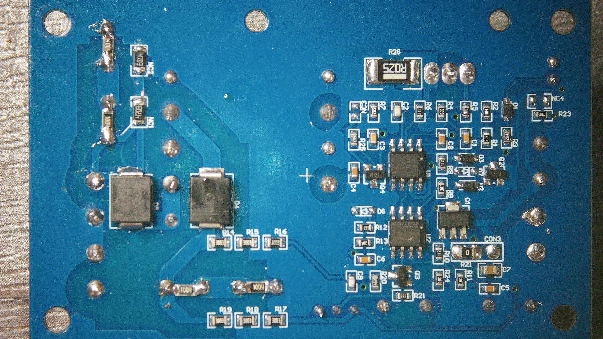

- The PCB is poorly designed. The capacitor of the RC current filter isn't close to pin 3, and the oscillator RC parts aren't close to pin 4 of the UC3843.
- The ground plane is not good, especially around the current-sense resistor and the UC3843.

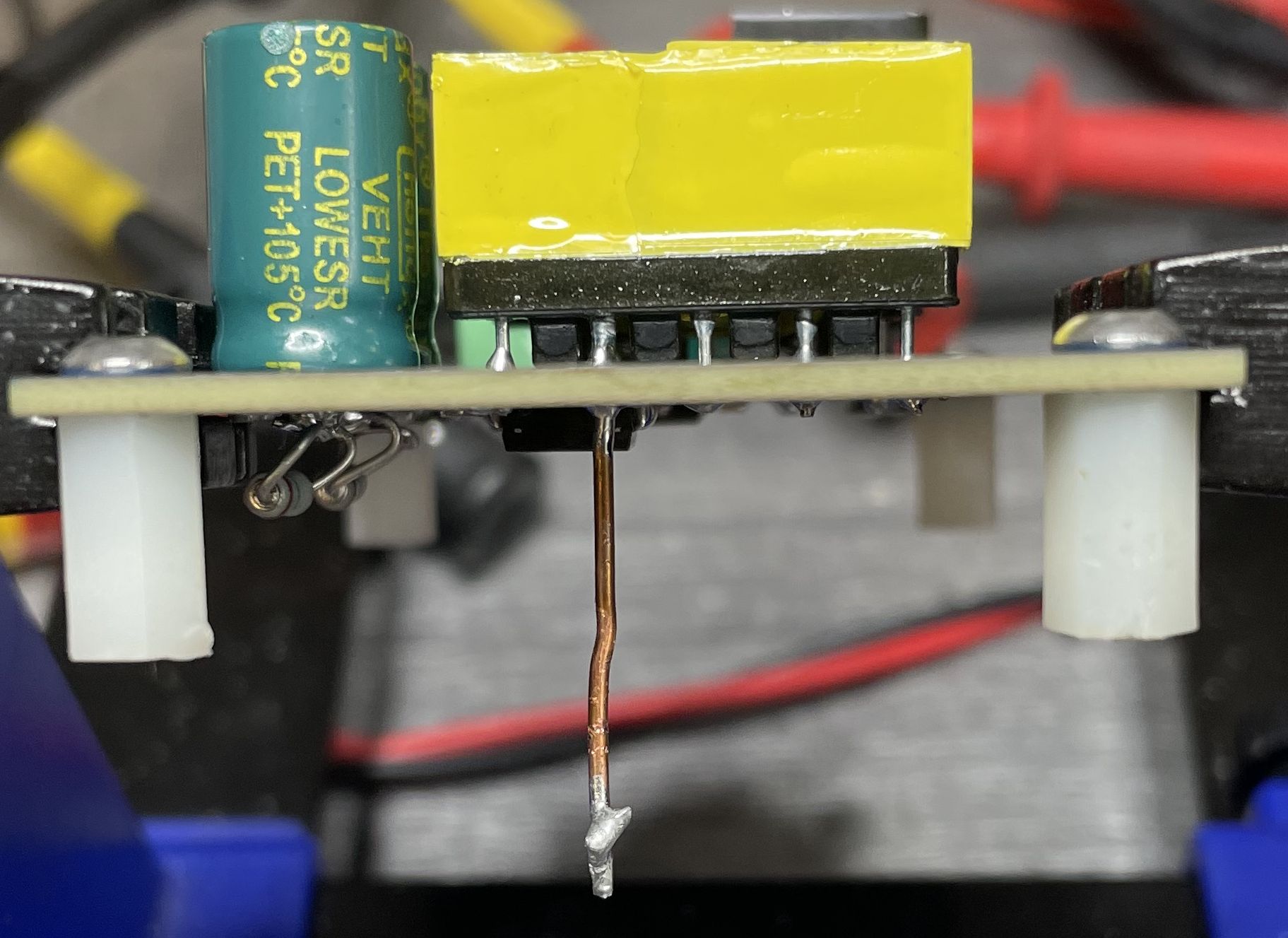

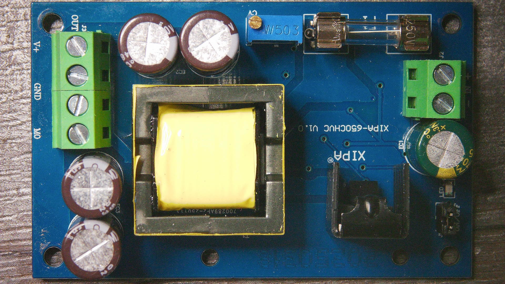

There is another DC-DC module that works better than the yellow one. I call it "the blue module".
XIPA-650CHVC
https://www.lingao.site/laxipa/
It can be found at several retailers on Aliexpress. It is manufactured by the company linked above.
It holds 20/25W (tested at 350V/70mA) and has survived endurance tests (10 hours of continuous operation at 350V/60mA).
The transformer is not the same as the yellow module. The PCB is better made and the components are of slightly better quality. Since it doesn't oscillate like the yellow module, the MOSFET and transformer don't get very hot. However, for some incomprehensible reason, they have scratched most of the component references, but it seems to be a copy of the yellow module.
It basically requires some modifications to improve it. Once done, we have correct specifications.
Result of one of my tests:
Positive output: +350V
Negative output: -125V
Consumption at 350V: 61mA
Consumption at 24V input: 1A
Ripple on the positive output on the load: 210mV (310mV, 4V pk-pk on the scope at the power supply output)
Out-of-the-box in the positive output only version, the ripple is 10V at 350V, which is not great.
Here are some photos.
Stef.

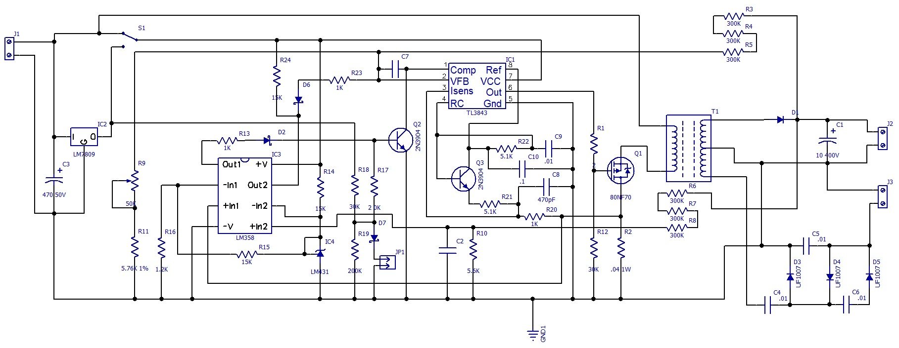

BobView attachment 1451323

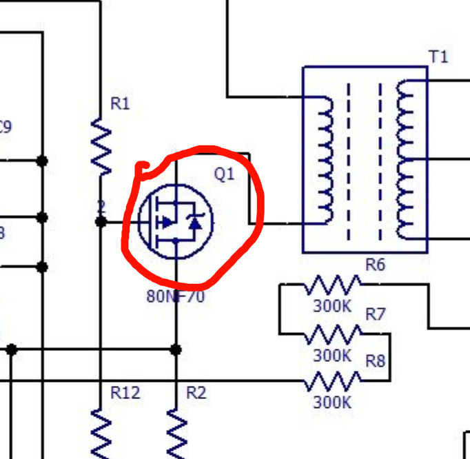

Wrong. Should be a N-Channel.
The STP80NF70 is also NRND.
