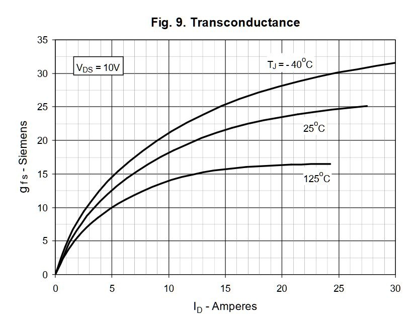

As a point - different manufacturers put a lot more effort into datasheets. Looking at ST's, they never have transfer characteristics under 1A, so it's hard to tell as the curves are too flat. But look at the attached graph of a IXTH20N65X2 from IXYS. They actually insert a graph of gfs vs temperature and take all the work out of it. Too bad they can't all do this!
