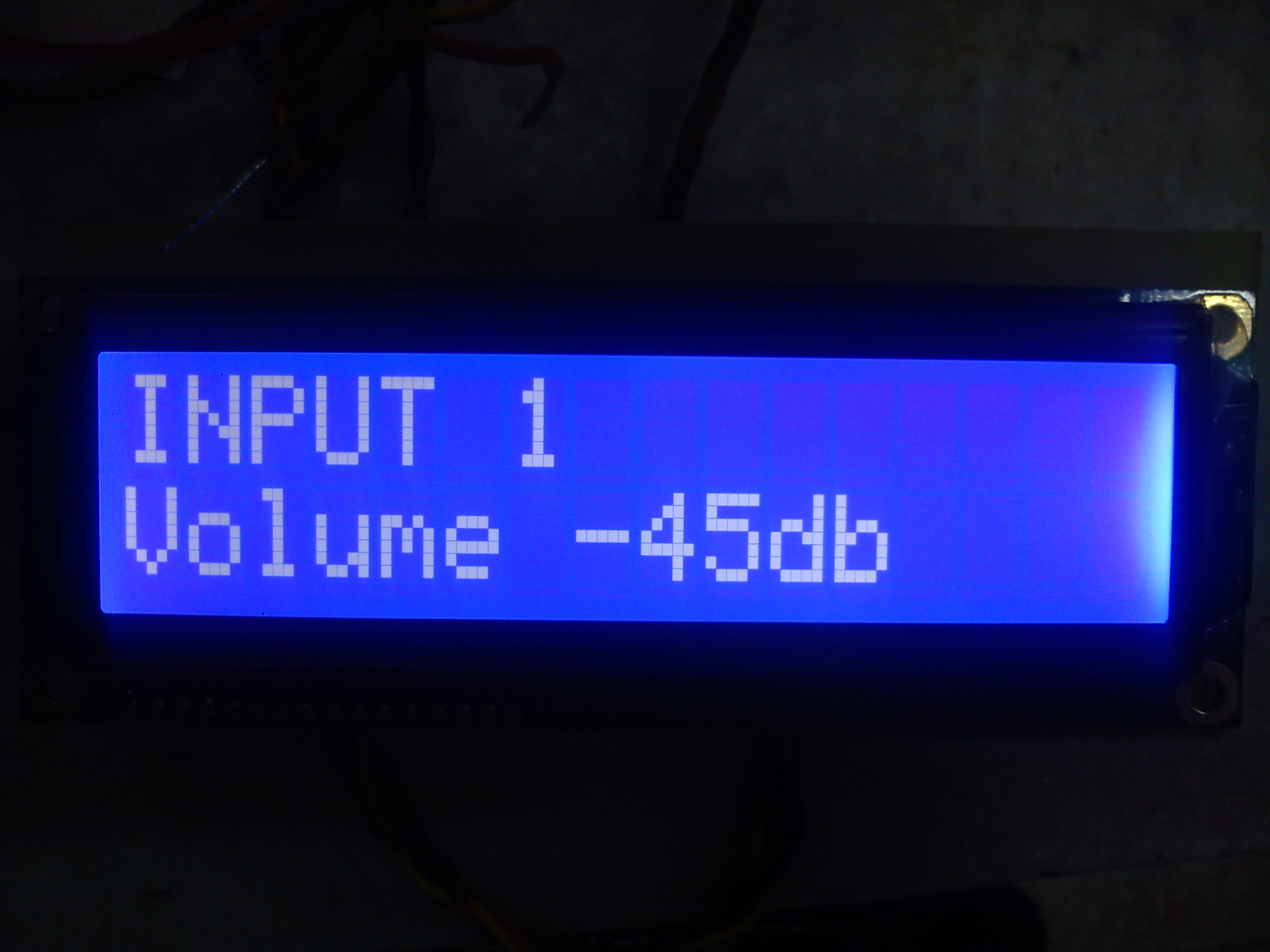

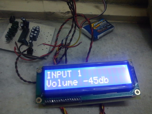

here are some pics of the dthing
Yes if you dont connect 7439
then it dont startup do to the I2C commands for init 7439
Found a error in trible so you have to get the files again from my server
added the new file into old zip 🙂
I see you used Cap for 7439 I plan to use WIMA cap for most
(0.47Uf & 2.2Uf)
here i will use mundorf mkp
this was trial board actuall board when all is done will have the box caps yellow colour box caps, the ones u showed are all dream caps for me,, if i were to get them it would be a nice hole in my pocket which would be like i m buying some low mid range Polk bookshelf speaker in india
FarmTech, yes i have check more then 10 times the components
there is no difference between schematic and board.
i use winstar WH1602L-TMI-ET display with no resistors on A-K for the blacklight
i use 14 V AC is this to high?
Well
14VAC = about 20Vdc
9VAC = about 12VDC
try a lower VAC I think thats why you have heating problems
see datasheet Page 4 Output Voltage
it show max 12VDC for high current use
