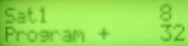

RC5 Remote - code change demo
Here is a sample code to add remote code/commands
to your program and store them in eeprom
Code:
' RC5 remote control code setup for Input selector audio amplifier
' Store new Remote buttons to eeprom and use them in program
' FarmTech 18.09.2010  DEMO to show how it works

Sample code
Here is a sample code to add remote code/commands to your program and store them in eeprom
Hi
Your sample code didnt work for me until I added a couple of strings in your code.
See DarkOrange strings. Now it works:)
Its high time to add this feature to the firmware, but I think that there is not enough M8515 memory...
And one more thing: maybe we should use external EEPROM with 1.000.000 write cycles like AT24CXX or something like that.

RC5 remote tester
Hi :),
Here is a code for RC5 debug
It show:
Address info + code
Command info + code
Easy to reprogram a multi ir remote when you can see the address/command on LCD
I used my ATM16 but eny other AVR can be used
run INTRC 8Mhz Disable JTAG if your chip have it
LCD 16*2
/Kim
@ Edit input text works now auto fill space on save via RC5 allmost finish code :)
