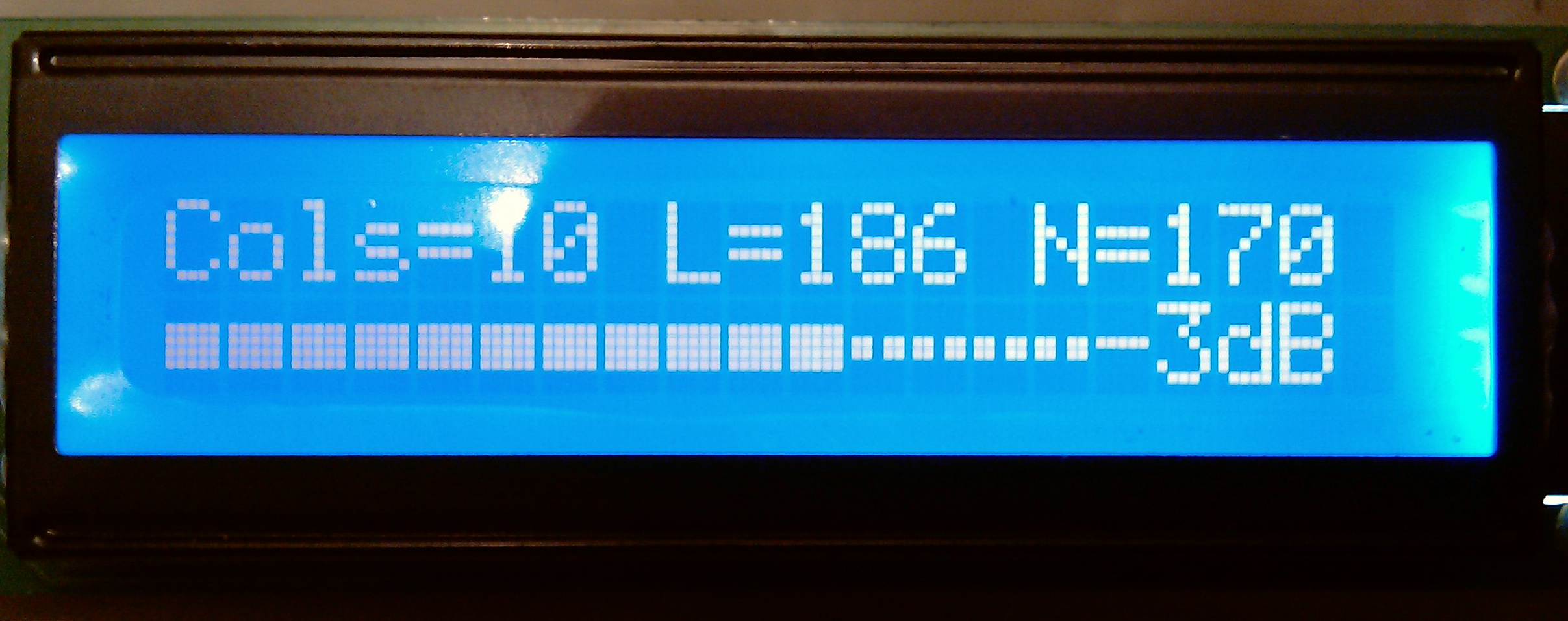

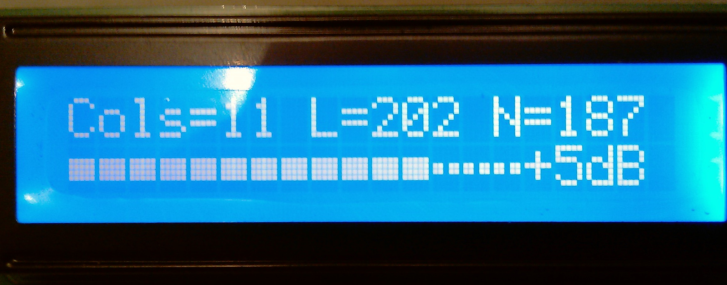

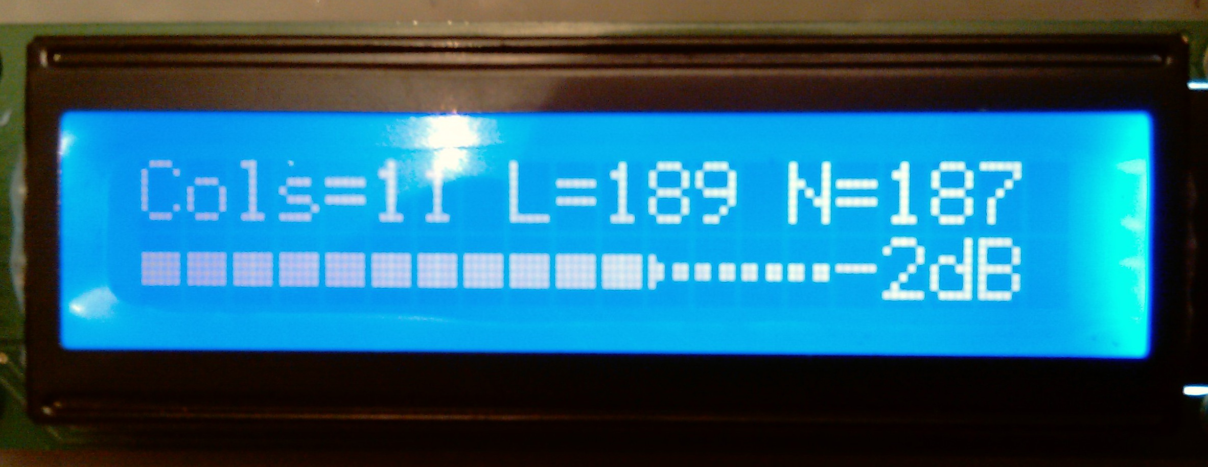

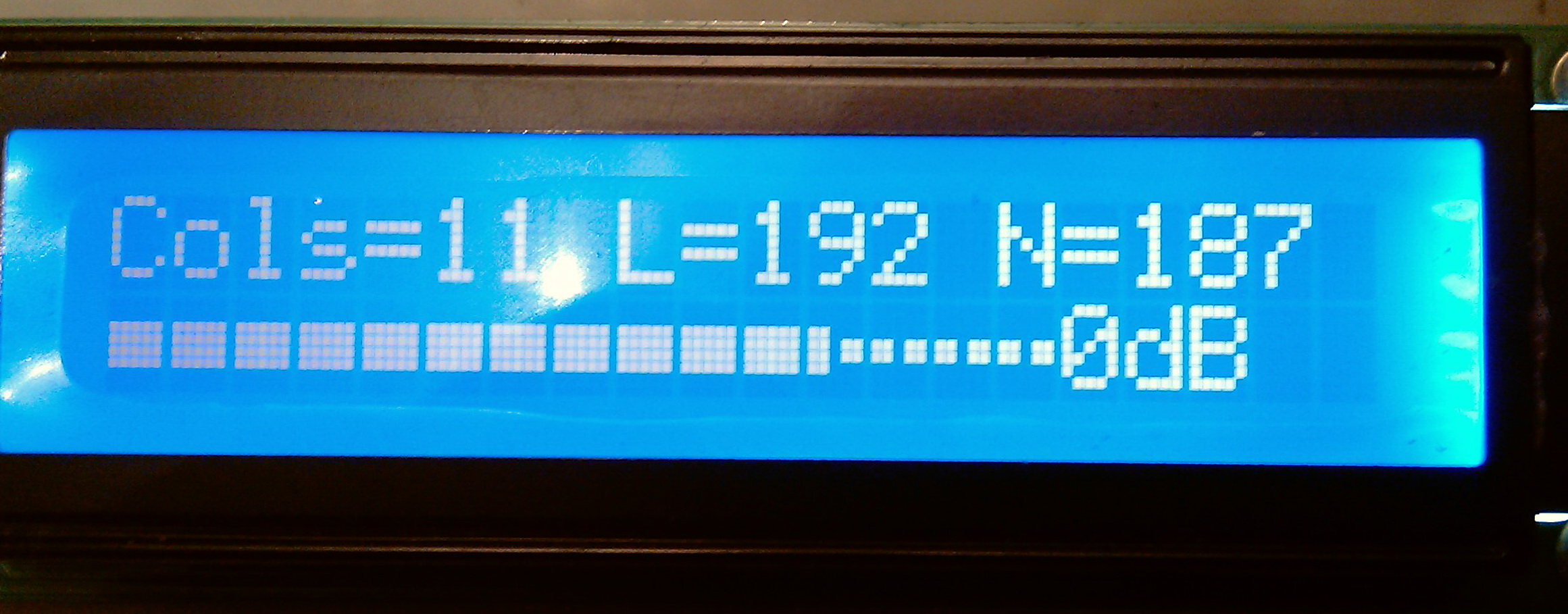

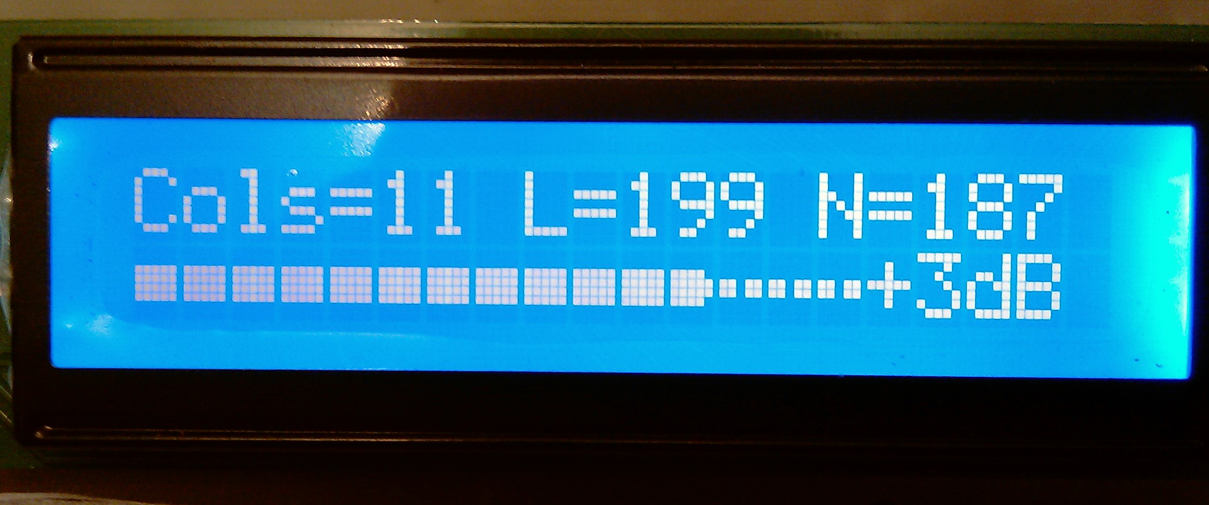

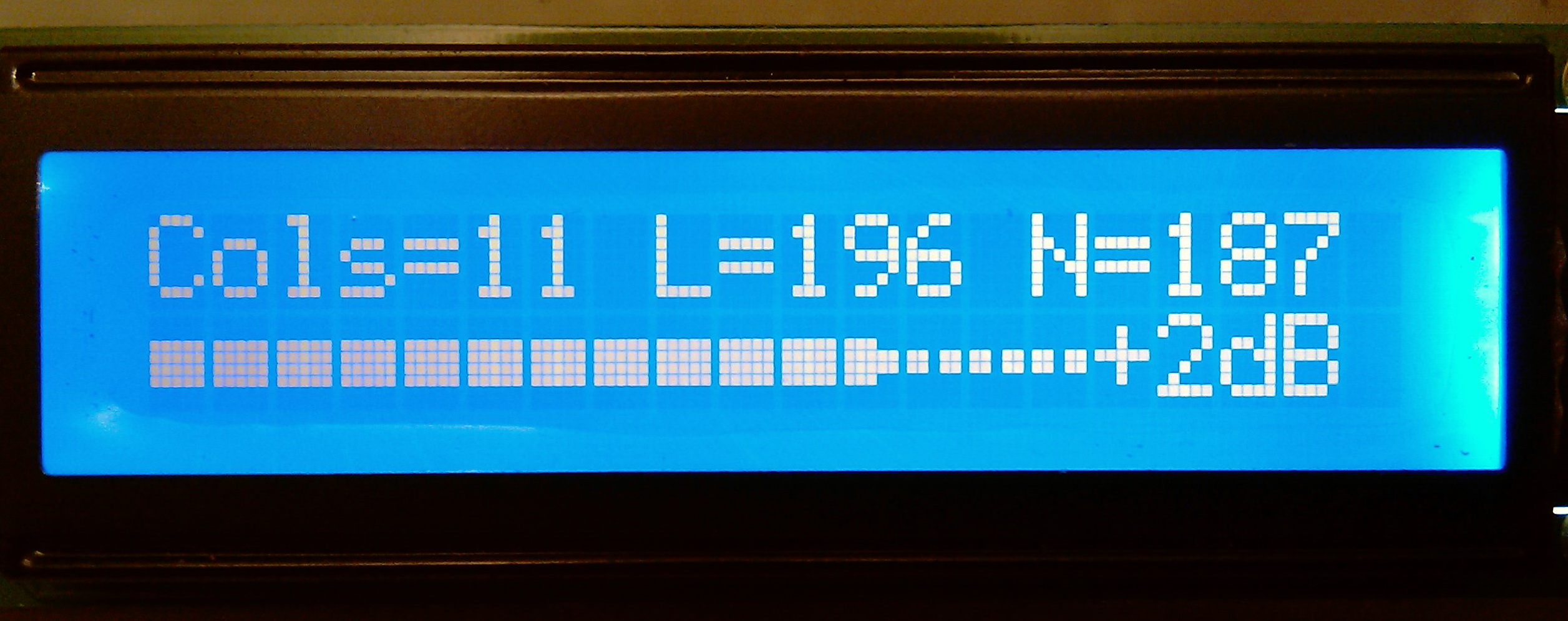

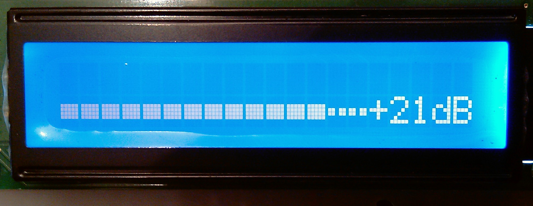

New bar graph version
Hi
I pimped a bit my bar graph version. Now the bar on lcd crawls from one dot to enother (a dot by dot). In previous old version bar moved symbol by symbol (by 5 dots at once).
P.S.: Some test photoes
