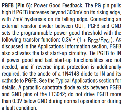

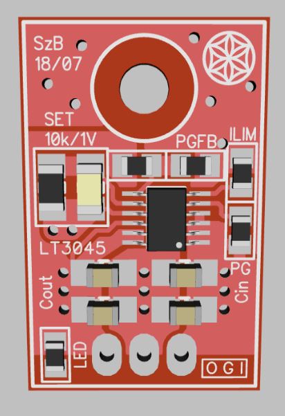

I have ordered a few PCB and i have some questions
On the picture :Yet another ultra low noise high PSRR LDO - LT3042
There are two R = 0 Ohm , one for ILIM and what is the oher one ?
Is it a good idea to have Cin=Cout=Cset ,Murata GJ8 X7R / 1206 / 4,7uF / 50V
What are your advices about the resistor choice ?
Serge
If you do not need current limiting, the ILIM pin must be grounded (0R).
The other is the power good feedback, if you need fast startup you must populate this PGFB resistors (e.g. 450k/50k), please see datasheet!
Murata GJ8 is a good choice, these are reduced noise ceramic types.
For Cset would be a good foil cap (w/o piezoelectric effect) the best, but they are very big...
For Rset use thin-film type, they have minimal current noise (and costs more of course).
Cheers!
For your question....
PLEASE READ THE DATASHEET... PLEASE.... PLEASE....
