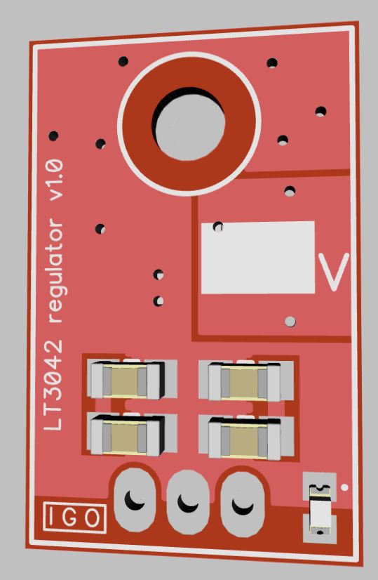

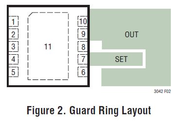

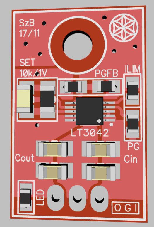

@OlegSH:
"Is there special reason to have a cut out rectangle in the GND on the bottom side?"
Yes, the datasheet writes (see picture too):
"Minimize board leakage by encircling the SET pin with a guard ring operated at a potential close to itself — ideally tied to the OUT pin. Guarding both sides of the circuit board is recommended. Bulk leakage reduction depends on the guard ring width. Leakages of 100nA into or out of the SET pin creates a 0.1% error in the reference voltage. Leakages of this magnitude, coupled with other sources of leakage, can cause significant errors in the output voltage, especially over wide operating temperature range. Figure 2 illustrates a typical guard ring layout technique."

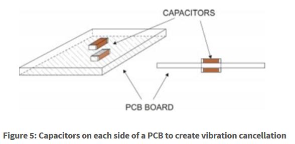

"You can skip the caps on the back side of the PCB entirely..."
There is a noise cancelling methode if you place the capacitors on the both side of the boards, see picture and How to reduce acoustic noise of MLCCs in power applications - Power House - Blogs - TI E2E Community.
@canvas:
Susumu RG semms to be good and has 1206 package too...🙂

Understood about the guard ring idea.
I did not know about mechanical noise cancellation if parallel capacitors are places on the opposite sides of the PCB. I'll note this trick for the future.
General comment: placing the LDO reg on the adapter will suffer from increased noise and voltage error anyways due to added leads impedance, IMO. I think all this ultra-low noise numbers are only achievable if the reg is placed near to the power pins of the device it supplies and if it shares same GND plane with it too.
Oleg

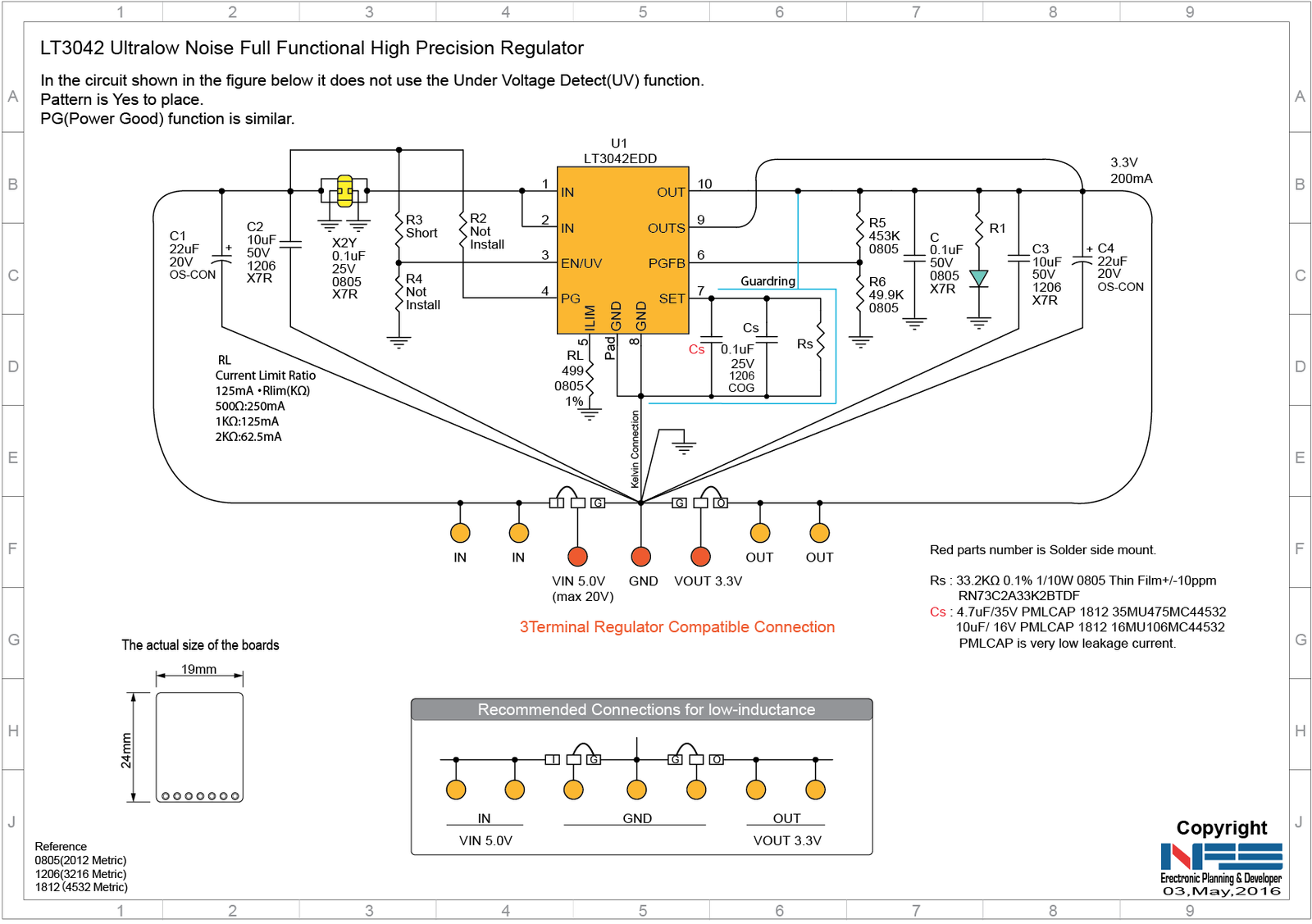

I do care about two things on LT3042. The first would be the support of fast-start up feature. (Need PGFB, and no I-limit resistor)
What values should I use for PGFB resistors?
(Datasheet describes it a little bit difficult...)
It was stated on page 12 from datasheet.
Power good threshold = 0.3V • (1 + RPG2/RPG1)
So: if I want to have good noise rejection below 100Hz, than I need big (up to 22uF) SET capacitor.
Large SET capacitor means anyway an increased start-up time, so I need the PGFB resistors to activate fast start-up function.
I leave PG output floated because I don't need it. It is uninteresting for me the "power good threshold" voltage. All I need is fast starting-up...
What now?
What now?
I think I understand...🙂
I can determine the output voltage level, until the fast start-up (2mA ref. current) should be activated. For example, if I need 5V regulated voltage, I should set the "PGT" value to 4,5 V or so...
Yes. Fast start-up will make v-out to pass PG threshold asap. Otherwise, it may take more than 0.5 sec to reach desired output voltage which could be a problem on some circuits, e.g. Ian's XO board.
So, my final version.
And like interestingness some PCBs from China...
