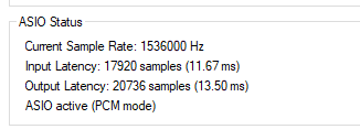

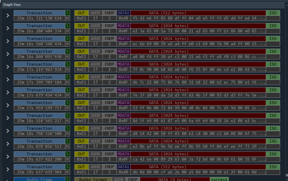

Hi everyone. I just re-implemented the UAC2 in another hardware platform. If you remember my last implementation is based on STM32, which is quite annoying to work with, involving a lot of hacking and tinkering. That project is quite incomplete also as DSD/DoP playback could not (or very difficult) be supported with peripherals on STM32, without core in the datapath, causing very high power consumption and instability. The new implementation is based on FX2LP, almost the stantard choice to communicate between programmable logic (FPGA/CPLD) and PC by USB. The core is completely out of the datapath, all logics are carried on the CPLD including buffering. Currently it can support up to PCM 768k/32bit 2ch playback and DoP detection (not playback yet). The project is still work in progress to be open-sourced, but I would like to share some progress with you.

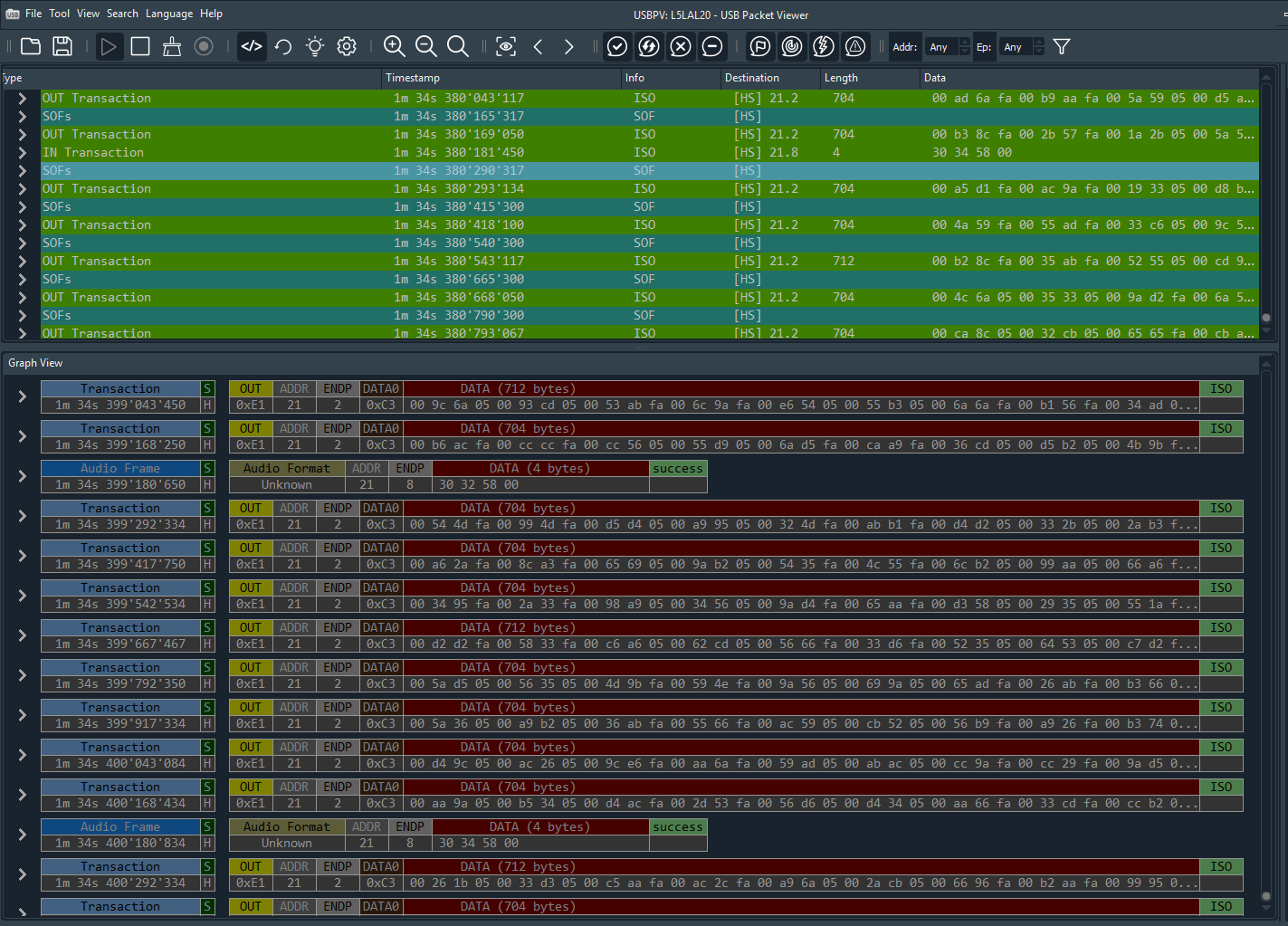

Function usb_PL_DoP_Recognition() is called after start of the stream to determine if it is PCM or DoP. It does not run constantly.

IIRC the DoP data comes interleaved in channel but DMA for peripherals only deals with continuous data, so you have to manually copy the data to two seperate buffers right? This have to be done by the core so I am expecting the power consumption to be quite high. Did you measure the temperature or current the chip is consuming? H7 runs faster but does not come with integrated USB PHY which is a big shame. Also I have heard of some issues with cache mess with DMA in Cortex-M7 devices, have you encouter any problem of this kind?

How do you recognize native DSD streams? I have not dig deep into this topic yet.

Below changes in dsd_master.v make the DOP and DSD work.
assign ch1_out = ch1_tx_reg[31];
assign ch2_out = ch2_tx_reg[31];
STATE_WAIT_DOP,
STATE_XFER_DOP: begin
case (req_count)
3'd0: next_ch1_data_in_reg[23:16] = data_in[15:8];
3'd1: next_ch1_data_in_reg[31:24] = data_in[7:0];
3'd4: next_ch1_data_in_reg[7:0] = data_in[15:8];
3'd5: next_ch1_data_in_reg[15:8] = data_in[7:0];
3'd2: next_ch2_data_in_reg[23:16] = data_in[15:8];
3'd3: next_ch2_data_in_reg[31:24] = data_in[7:0];
3'd6: next_ch2_data_in_reg[7:0] = data_in[15:8];
3'd7: next_ch2_data_in_reg[15:8] = data_in[7:0];
STATE_WAIT_DSD,
STATE_XFER_DSD: begin
case (req_count[1:0])
2'd0: next_ch1_data_in_reg[31:16] = {data_in[7:0],data_in[15:8]};
2'd1: next_ch1_data_in_reg[15:0] = {data_in[7:0],data_in[15:8]};
2'd2: next_ch2_data_in_reg[31:16] = {data_in[7:0],data_in[15:8]};
2'd3: next_ch2_data_in_reg[15:0] = {data_in[7:0],data_in[15:8]};
next_ch1_tx_reg = ch1_tx_reg << 'h1;
next_ch2_tx_reg = ch2_tx_reg << 'h1;
test with es9038q2m DAC
result:
1,DSD test with ASIO driver up to DSD512.
2,DOP test withh ASIO and WASAPI up to DSD256 (DOP512 with noise,may be cpld timing constrains issue)
3,DOP not work stable some times no sound output. there are pop and crack sound output while switch music.
