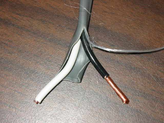

I just purchased a 500 ft roll of Belden High Strand 10 guage exterior rated speaker cable. It has 64 strands per conductor, has a full 360 degree twist to it every 2 - 3 cm and is made of high grade copper.
What kindof jacket and fillers does this use? Is it 10/2 SJ power cord or is it made specificly for speaker cable?

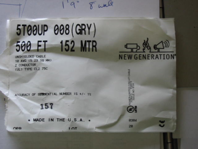

Originally posted by Da5id4Vz What kindof jacket and fillers does this use? Is it 10/2 SJ power cord or is it made specificly for speaker cable?
Here is the label

I’ve seen a lot of the 12ga erosion of the same stuff. Systems integrators don’t like to pay extra for the 10ga unless you push the issue. Decent stuff, and the CL-2 rating is nice if its going to be run through any walls or stuff. Its a traceable specification that building inspectors and insurance people can look at and easily sign off on.
