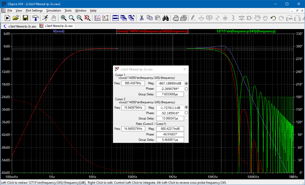

With that new baseline, I've reworked the sinc droop correction filter. It's now a simpler, underdamped 2nd order Butterworth, which gives a sinc droop corrected response that is down less than 1dB at 16kHz (the red trace in the attached plot). The green trace shows the uncorrected output. Full scale output is also now closer to 1 VRMS.

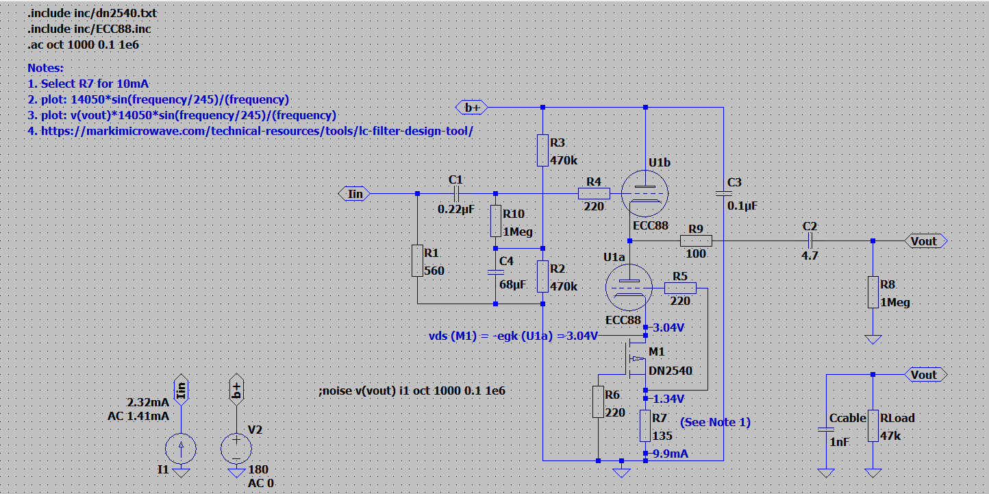

I've changed the circuit a bit since the last schematic was posted.
The cathode follower now incorporates an improved biasing network. Distortion of the cathode follower into a 100 kohm load is acceptably low at about -95 dB for H2 and more that -100dB for H3 and higher at full output. JJ and EH tubes both perform nicely.

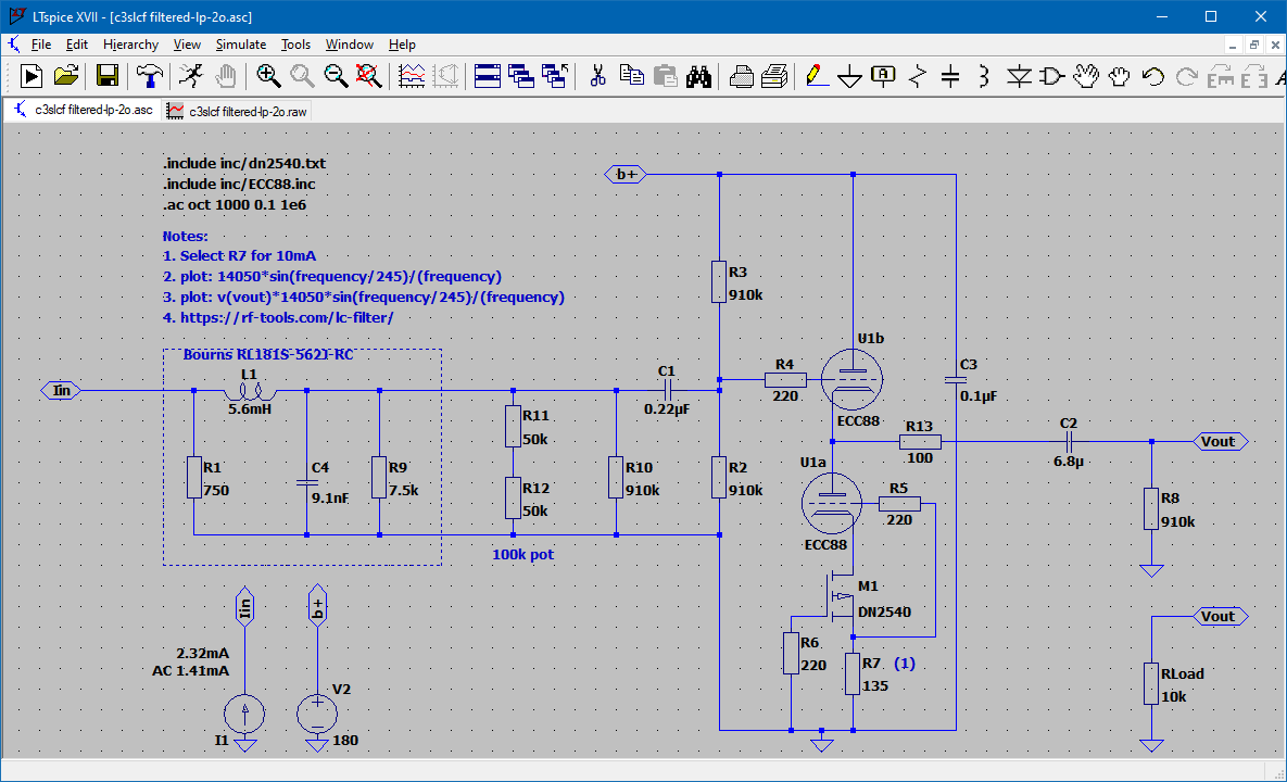

The RLC network has been removed due to some concern on my part that it was having a negative affect on the sound. So the frequency response now exhibits the classic NOS sinc droop and, as a result, sounds a bit dark or rolled off. This issue is not yet resolved for me.
I did lower the value of the IV resistor from 680R to 560R to use somewhat less of the TDA1387's output compliance, as suggested by Abraxalito. With that in place, the output is nominally 0.78 Vrms, which is not an issue for me as I am using a preamp with gain.
