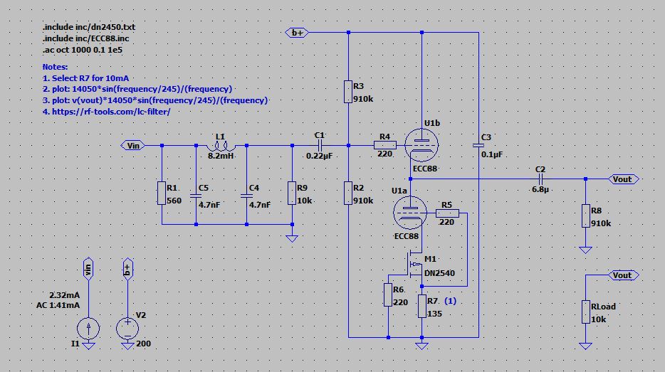

So, I've had a quad paralleled TDA1387 from Tek Products laying around for a few years now waiting for a project and I recently had some renewed interest in doing something with it. After a couple of false starts I've arrived at this configuration - NOS with passive I/V and LP filter followed by a current source loaded cathode follower at the output.

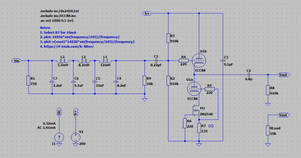

I've modified the TDA1387 board to remove the onboard I/V network and coupling capacitors. The DAC output is now directly coupled to I/V resistors which are located on a separate LP filter board.
The I/V resistor is 750 ohms, which provides the input impedance to a 7th order passive LP filter whose values have been adjusted to compensate for the sinc droop at the DAC output. With the 750R I/V resistor, output is around 0dBv at full output.
Nice simple circuit. Aside from the 7th order passive reconstruction filter, of course. I'm a big fan of passive resistor I/V where the DAC has enough low distortion output voltage compliance. I also like the tube cascode of the M1 current source.
Thanks. I've also done this with a 3rd order filter. Others (Abraxalito) feel that a higher order filter improves the sound somewhat. I can't say that I've noticed much of a difference between the two. Compensating for the sinc droop, though, makes a big difference, IMO.
The 7th order filter I'm using has a considerably steeper transition band than the one you're showing in post #1. That might make a difference.
How did you incorporate the NOS droop compensation into the basic design (which I assume you adopted from rf-tools as you mention them)? I haven't found a mathematical way to do that, I just play around in LTSpice - I'm curious if there are more formal methods to achieve the same.
Anyway great to see more applications of TDA1387 and LC filters 🙂

I'm unaware of any formal methods to do the droop compensation. I'm also just manually adjusting component values in LTspice. Filter improvements are among the items I'll be looking into as I move forward.
Of the buffers I've considered, this one is the least colored by far. Compared with them it has good detail and a good sense of space. The midrange is nice and the bass is solid. It seems to mostly just get out of the way. My goal was a good sounding tube buffer that can drive a 10 kohm load and I'm pretty happy with the result so far. I do feel the shunt regulator is an important part of the buffer's sound.
Other configurations I've considered include a Broskie ACF and SRPP circuits. Ultimately I rejected them in favor of this one.
After living with this for a while now I've developed a clear preference for the 3 pole reconstruction filter of the 7 pole version. The 3 pole filter seems to produce a better high frequency balance, where the 7 pole seems recessed or a little rolled off. It's not clear to me why. They do both have a few tenths of a dB deviation from flat response in simulation, but I don't really see a correlation between that and the perceived sound.
Another difference is that the 3 pole uses a smaller I/V resistor (560R vs 750 for the 7 pole), so maybe the TDA1387 is happier with the smaller value.

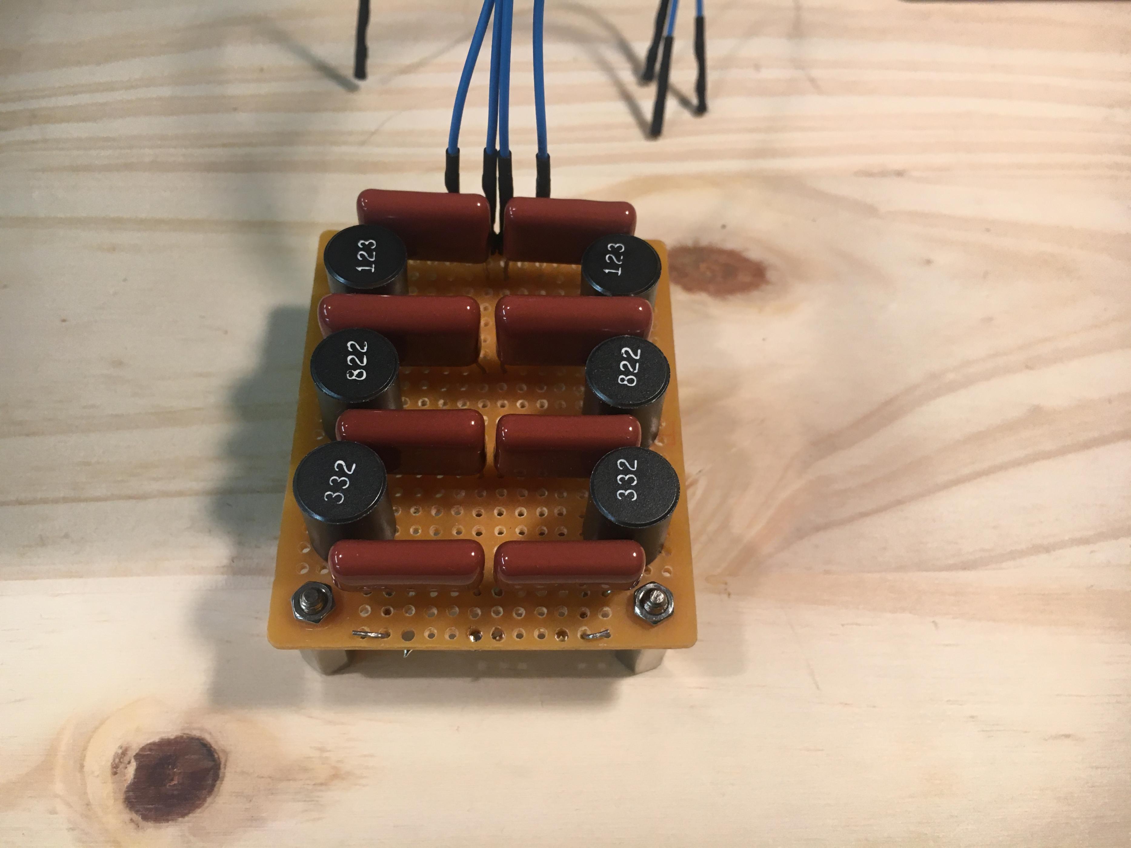

What kind of filter inductor cores are in use? Air core? Ferrite?
What kind of filter cap construction?
Maybe factors other than frequency and or phase response have some effect your preference for a simpler filter?
That's an interesting point. The inductors are Bourns RL181S series, so definitely ferrite core. The capacitors are Panasonic ECWH polypropylene film.
Phase response by simulation is -55 degrees for the 3 pole and -240 for the 7 pole at 20 kHz, no surprises there.

Did you notice a difference with no input filter at all ?
Noob question : why not a single ECC88 with each triode stage for one channel instead ? Not enough current from the TDA1387 VS a TDA1541A (4 ma ptp) for illustration ?
thanks for the shematic, not enough seen those days...

The lower triode section and the FET together form a cascoded current source with quite high impedance. It's usually accomplished with 2 FETs, I just liked the idea of using a triode in that location. It's supposed to be a tube buffer, after all.
Yes, I have tried this with no filter at all and the sinc droop is very noticeable. I'm currently using a 3 pole filter which attempts to compensate for the sinc droop. It's not particularly effective as a reconstruction filter, although it will knock down some of the higher frequency images.
Personally, I find the sinc droop compensation a necessity.
