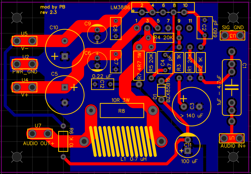

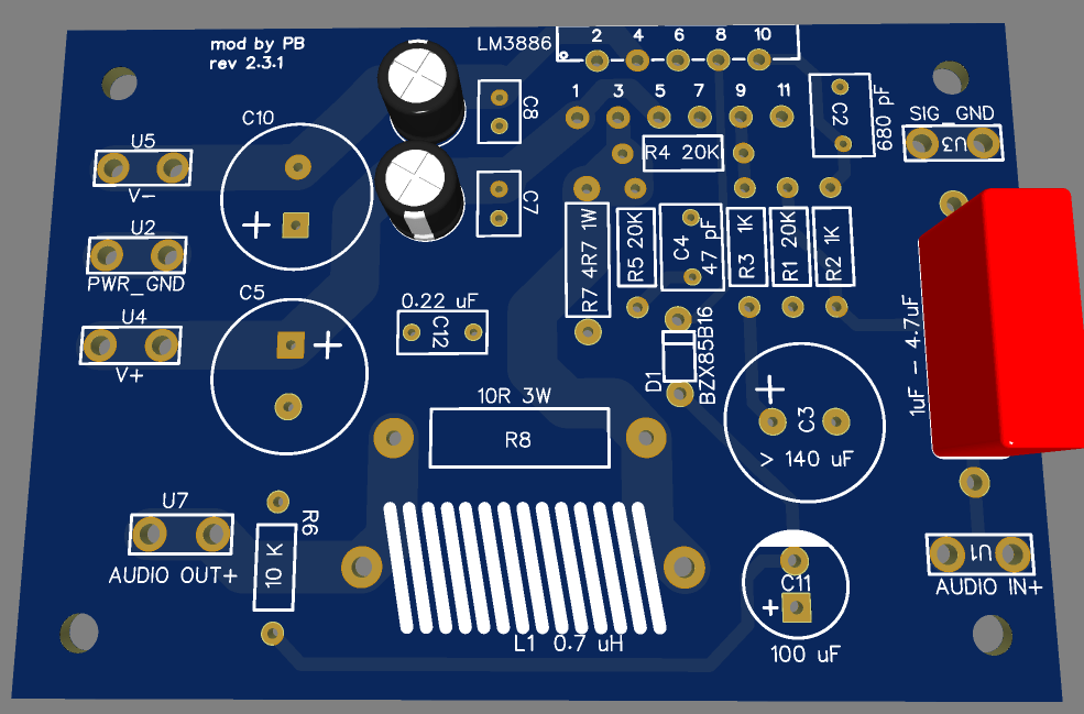

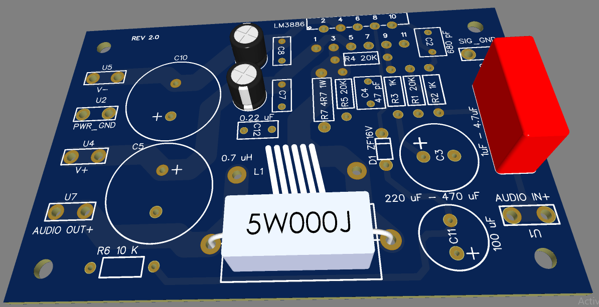

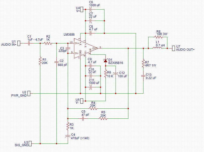

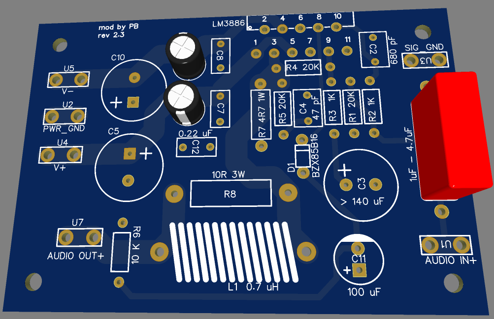

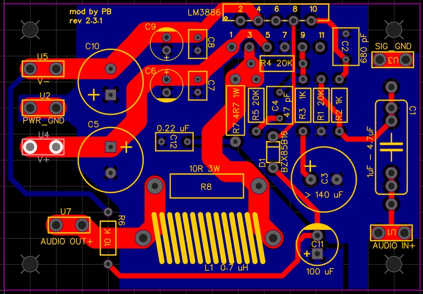

For anyone who is building amplifier with TF version of the chip and can use one screw to mount it to the heatsink, I am attaching latest 9.0 revision PCB. All values for resistors and capacitors were selected based on using LTSpice simulation. Attached also is frequency response graph screenshot.

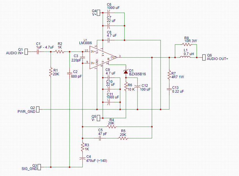

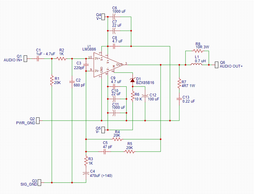

C1 should be good quality audio grade film capacitor - WIMA, Kemet, Panasonic are good value ones.
C2, C3, C5, C8, C9 - can be ceramic C0G or X7R types.
C4 - 220uF or 330uF audio grade electrolytic cap.
C7, C10 - 22uF low ESR electrolytic caps.
C6, C11 - 1000uF generic electrolytic caps.
Gain is set to 20V/V - best overall value for wide variety of input levels.
Needs 3.3 dBu or 1.13 Vrms or 3.2 Vpp input level for the full power output into 8 ohm speakers with +-35V power supply.
L1 is DYI inductor made by wrapping wire around R8. PCB design allows for separate soldering for resistor and inductor.
Gerber files are attached. Great inexpensive site to make those PCBs is JLCPCB

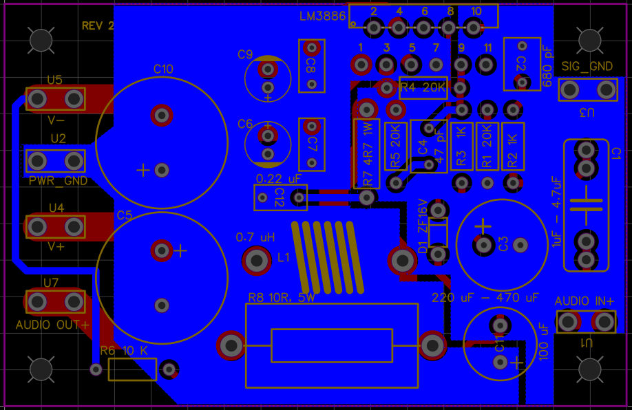

Soldered a big boy 2.2uF film cap with 47k resistor - added more red colors to the PCB lol.
Now just trying to decide on gain - probably will set it to 14V/V. That's +4dBu input line level.
I will be using this amp with Scarlet 2i4 audio interface, and max level for that is rated at 5.5dBu. That is kind of odd, because when I run the amp in simulator, feeding it 5.5dBu is right at the max level, almost clipping with the gain of 14v/v.

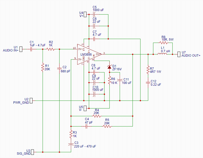

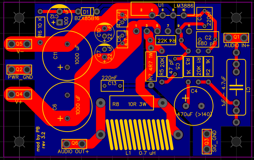

It looks that with single LM3886 and the load of 4 ohms it is best to supply it with +-28V.
On gain:
Set gain to 56V/V for -10 dBV or 0.316227766 Vrms or 0.4472135955 Vpk input level to get full output power into 8 ohm speakers (R4, R5 = 56K, C5=22pF)
Set gain to 14V/V for +4 dBu or 1.227652988 Vrms or 1.736163505 Vpk input level to get full output power into 8 ohm speakers (R4, R5 = 14K, C5=10pF)

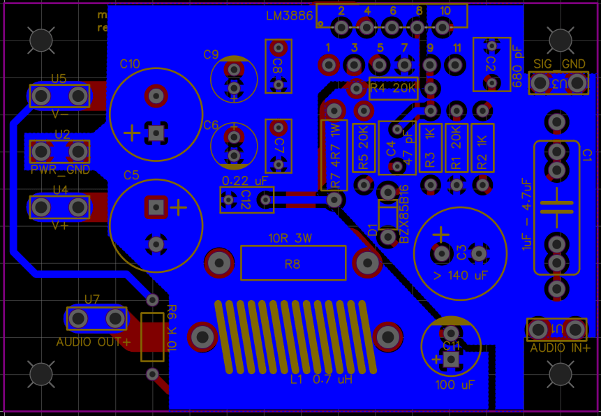

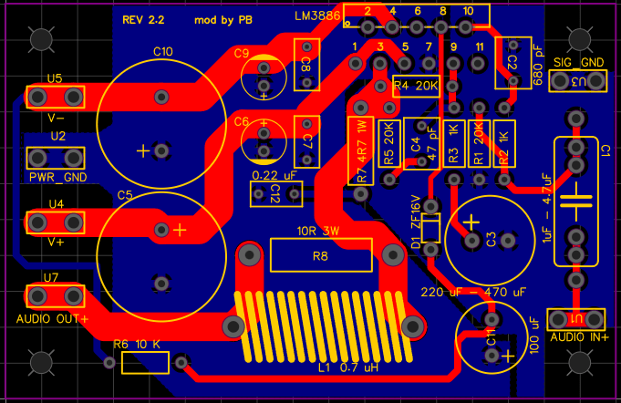

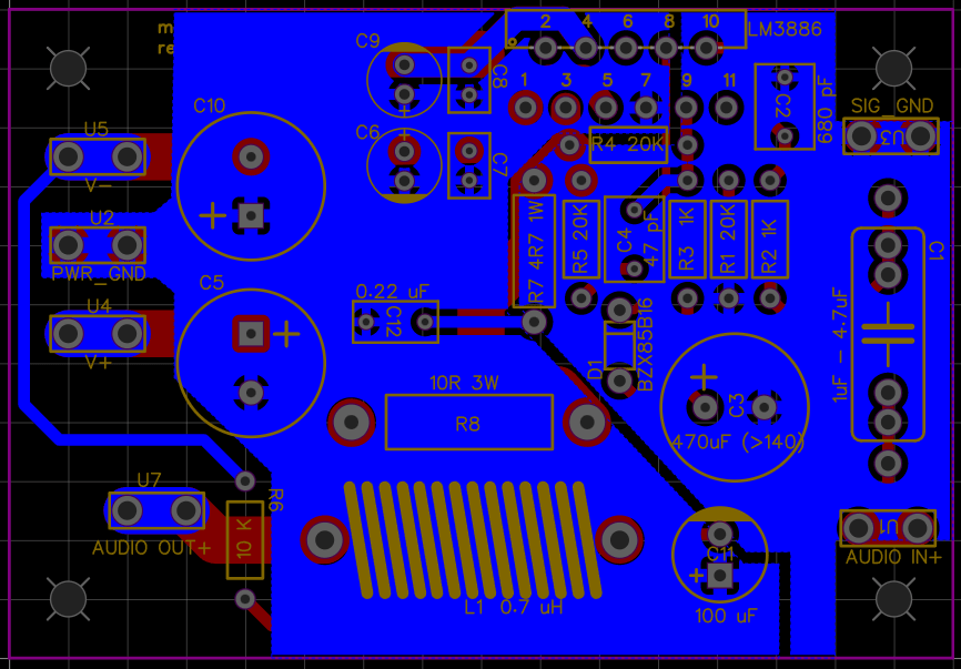

Updated layout with correct resistors sizes.
On gain:
On gain:
Correction:
for R4, R5 = 56K, C5 should be 10pF
and for R4, R5 = 14K, C5 should be 22pF

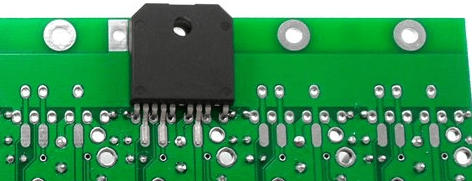

Those aluminium bars you´re using to push the chip against the heatsink look awfully bent.
Hope you didn´t apply that much pressure to get them to this shape!
Pushing against the edges of the PLASTIC package might break it otherwise.
You hardly need more pressure than one can easily apply with their thumb pressing against the chip.
Ideally that pressure is applied evenly over the whole surface of the chip with a flat bar or so.

Those are made from aluminum and bend pretty easy with very little pressure applied. I should've drilled holes closer to the chip.

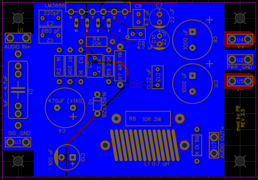

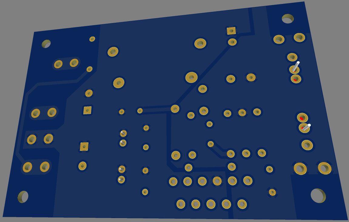

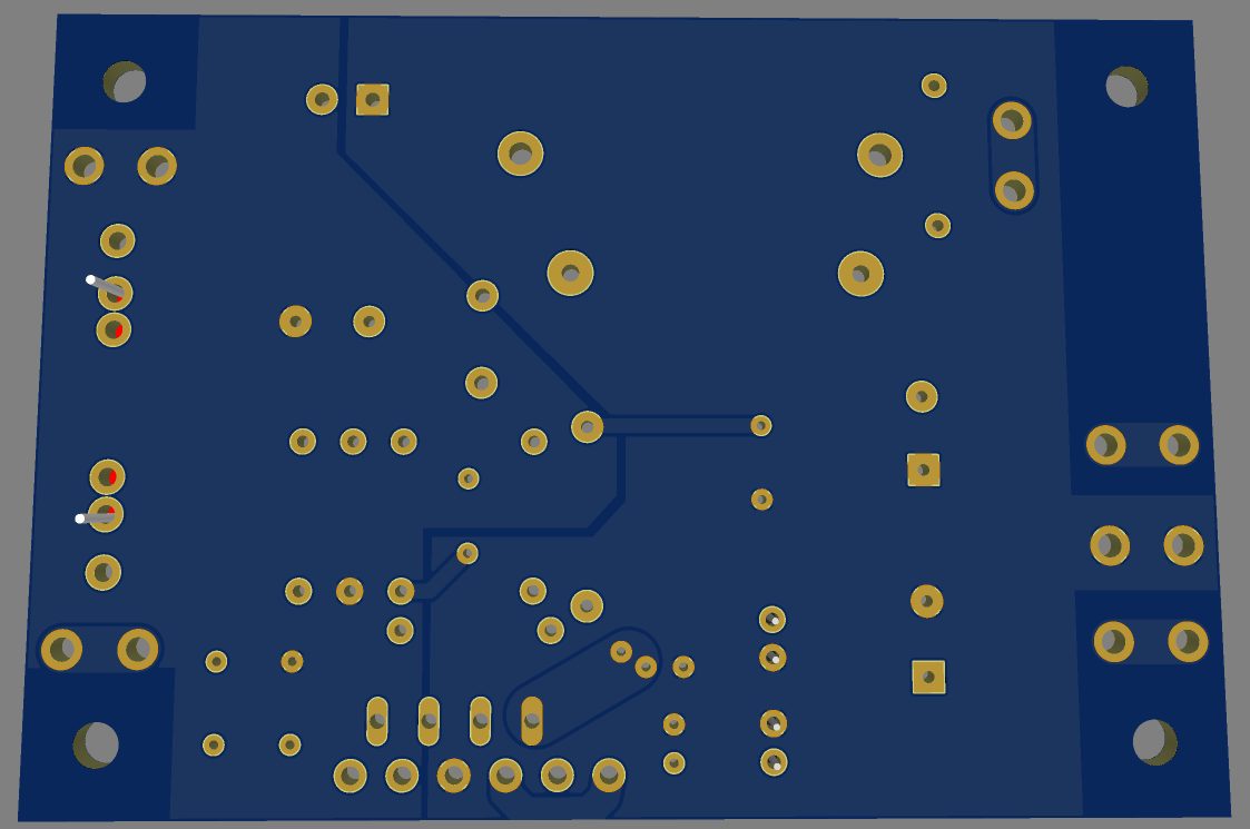

In this revision fixed ground layout.
It is critical for this version for the load to be 8 ohms
Power is +-35V DC
Input level is set to be +4 dBU
Output power should be 50W into 8 ohm speakers.
Power is +-35V DC

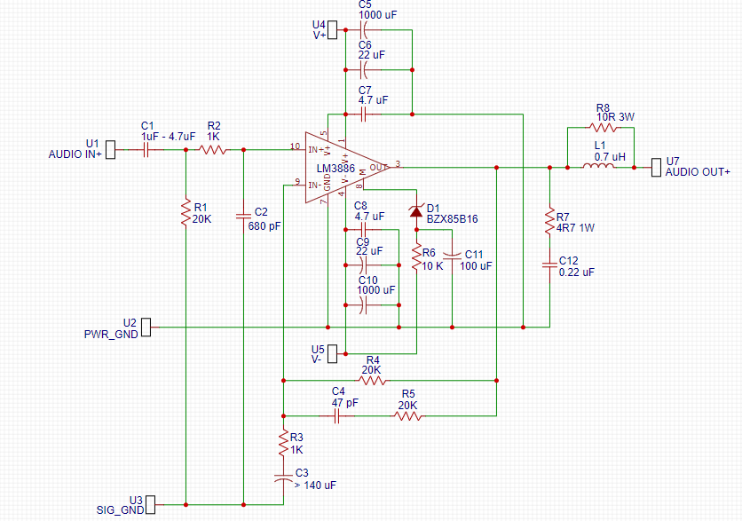

Attached are schematics for different input line levels:
+4 dBU
-10 dBV
Those are for +-35V power supply and 8 ohm load resistance.
Gain is set to 18 or 72 by changing feedback resistors to 18k or 71.5K respectively.
Johnson noise is higher for 71.5K resistor.
It is -106 dBV or -103.78 dBU, calculated over the range of 20KHz, with temperature of 40 degrees Celsius.
For 18K resistor it is -112 dBV or -109.78 dBU, same freq range and temp.
+4 dBU
-10 dBV

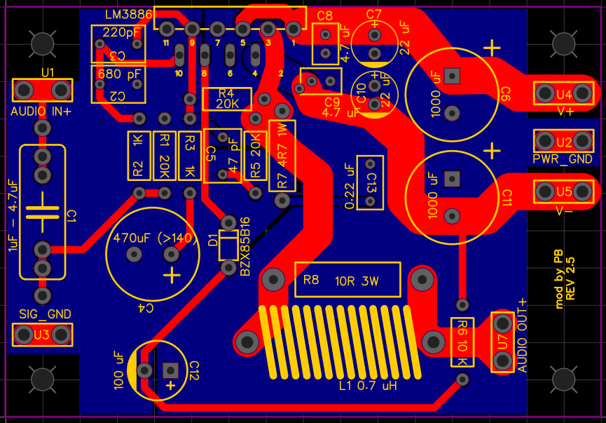

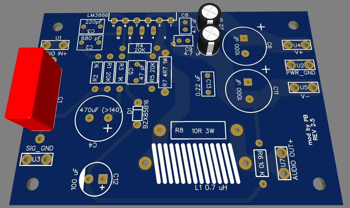

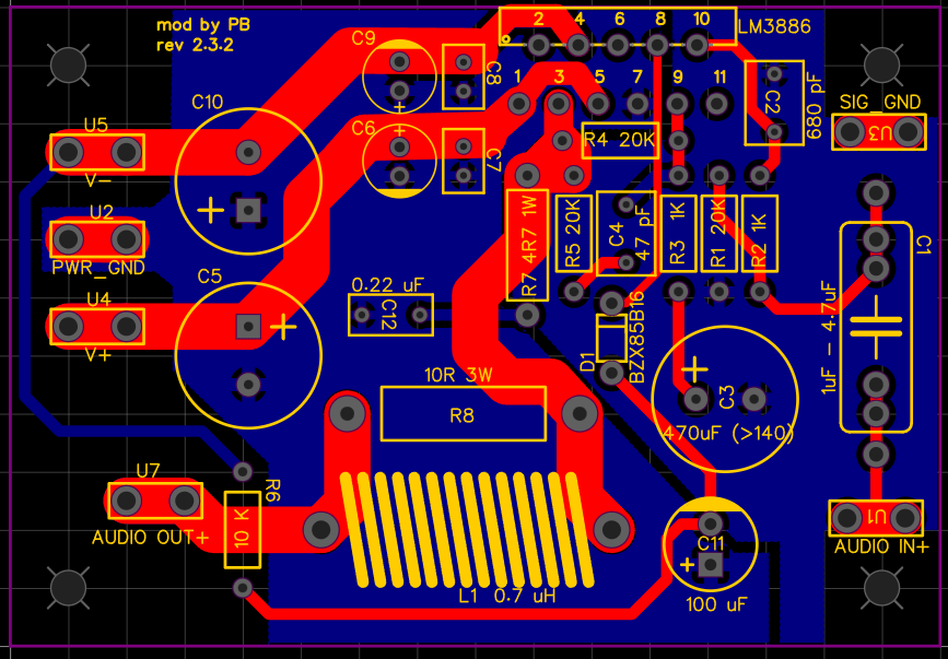

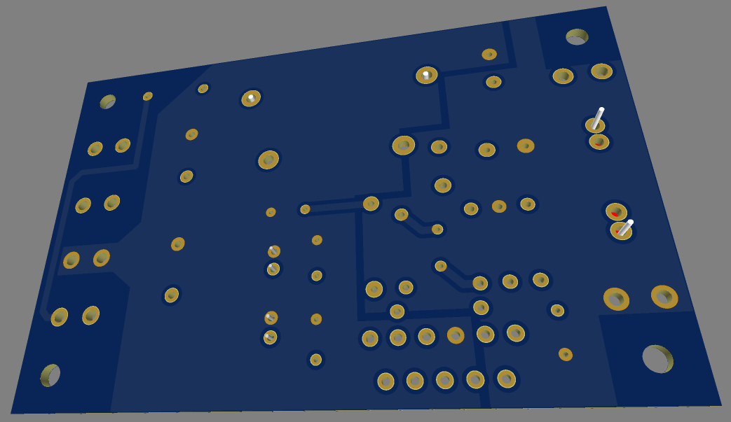

Another revision of the simple gainclone chipamp PCB!
In this revision improved ground plains, added mounting holes on the side of the heatsink, + and - traces are pours now.
