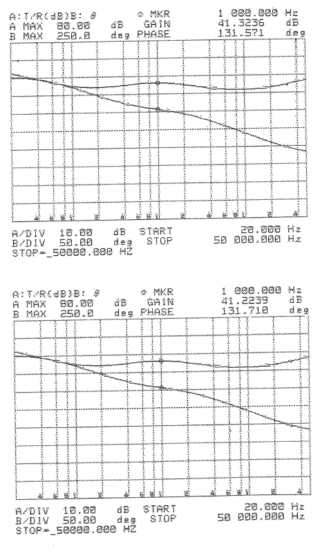

Here's response curves for the RIAA circuit that was posted at the beginning of this thread. The actual board is shown in post #33. Gain matching between the two sides is right on par. This preamp and its accompanying lineamp should have made to Burning Amp last Saturady, but events conspired against me. I'm hooking the box back into my living room ststem tonight to see if I've exorcised all the demons (large and small) that have been plagueing me. I may have to replace the source selector switch, but that's just grunt work.
If you're running an MC cartridge, maybe the extra HF attenuation makes a difference. I've still got the Grado Gold, which is probably between an MC and the usual MM cartridge in terms of response. It's easy to short across the extra resistor in practice, and I may try it once I get other pressing concerns out of the way. What I want to do at this point is wire in a new selector switch to my preamp box, as the one I'm using flat doesn't work (or is intermittent) for some reason. Once everything is running, I'll want to take some time to get used to the new box, as I've already had some indications that It'll change the sound of my system yet again, probably for the better.

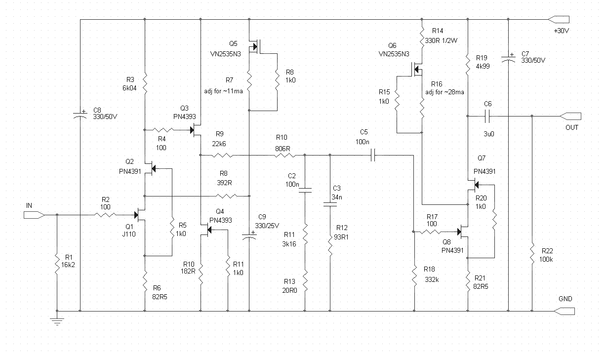

The attached schematic shows one side of another module I've just finished based on the "current boosted common source" principle introduced in the "All American" thread, reiterated here. It's a somewhat simpler version of the All-AM, as it uses a PN4391 jfet instead of a ZNN3306A mosfet in the second amplifier stage, making biasing a bit more straightforward. I also omitted a source follower in the output stage, as it is going straight to a 50k pot. You may choose differently. I originally was trying to use the PN4391 in both the input and output stage, but found the J110 fet a little easier to bias in the input stage. I chose a J110 matched pair that required relatively high bias current to keep the distortion down.

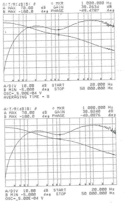

I tested the gain-phase of both sides, and they matched to within 0.5dB - not as tight as my last effort, but still ok. I'll post the scan results when I get back to work Monday, as I didn't get the chance to scan the paper results into the computer. I suspect that the difference is one of absolute gain between the two sides rather than tracking differences between the two RIAA filters, as the filter components are matched very well.
The power supply used is different than the one shown in the beginning of this thread, using a current mirror loaded 2SJ74 diff pair and LED voltage reference instead of the zener-based reference shown at the beginning of this thread. This will be a test of the supply as well as the amp circuit when I load it into my preamp box.

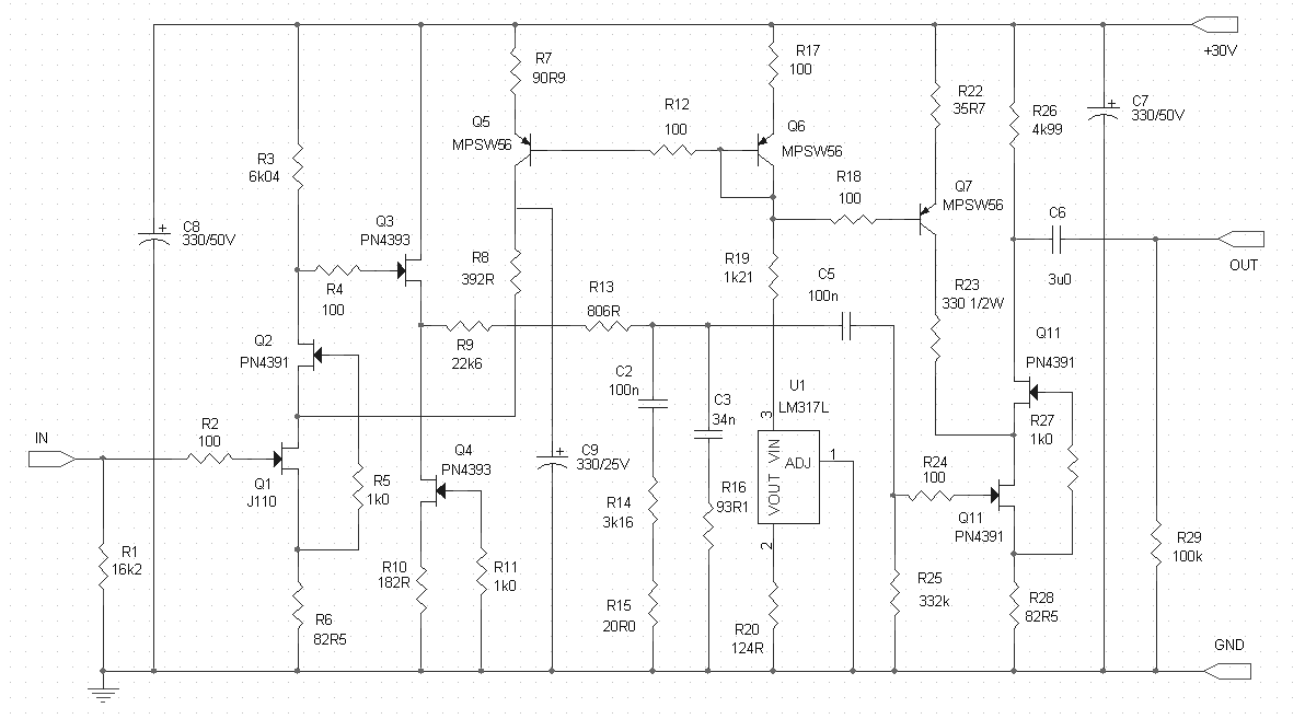

I've updated the schematic a bit. I replaced master current source Q9 with an LM317 current source, polluting the precious bodily fluids of the circuit with a nasty IC. However, it was more a accurate current source and had a higher output impedance than the fet I was using. When I find my stash or buy a new bunch at Mouser, I plan to replace the LM317L with a Supertex TO-92 depletion mode mosfet, which should have decent output impedance.

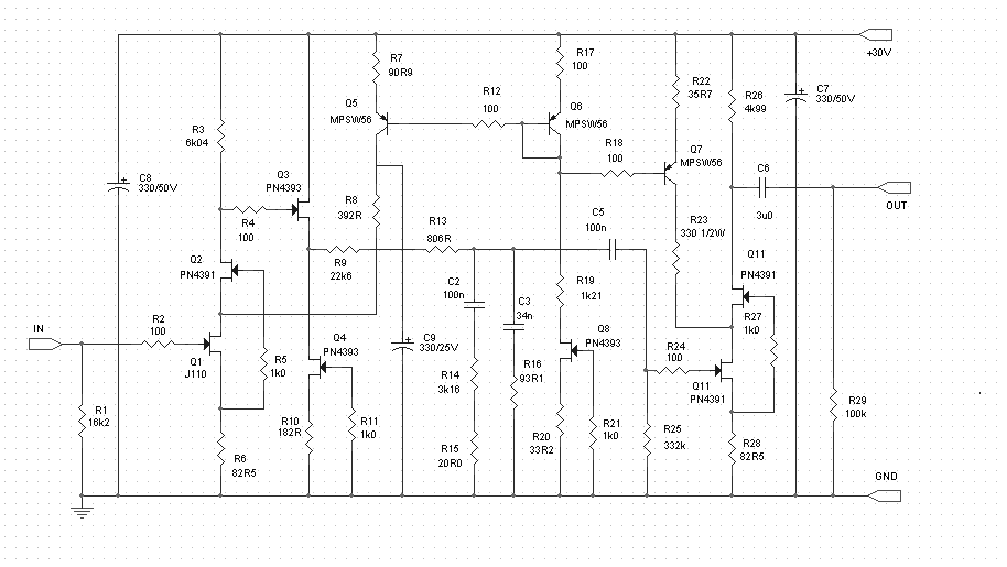

Anyway, U1/Q9 is the master current source for the circuit. Q5-7 are current mirrors that multiply the output of U1/Q9 and direct it to the drain of the gain fet for each stage, Q1 and Q11. Resistors R7, 9, and 22 scale the current going to each stage. I may revamp the circuit to use two separate depletion mode mosfets as current sources, one for each stage. It's fewer (but more expensive) parts, and I would appreciate a little less clutter. It also modularizes the design, making it easier to separate and bring up each stage.
I don't know if the added current does anything to the PSRR. I could try wiggling the VCC voltage in simulation, but that may not be terribly conclusive. Best to assume that the cascode pretty much trashes the PSRR due to the current divider effect between the high impedance cascode fet drain and the load attached to it, and try to arrange for as quiet a VCC supply as possible. This is a good approach anyway - if you don't track dirt into the house, you don't have to sweep it out...
