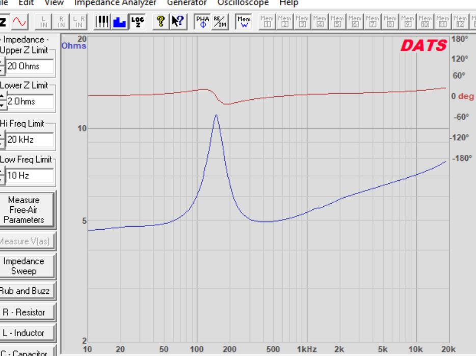

BTW, yes, couldn't work without impedance plots...the one below is all 24 drivers in the straight box together, a little higher in freq than i hoped
Impedance plot looks good! No problems there.
