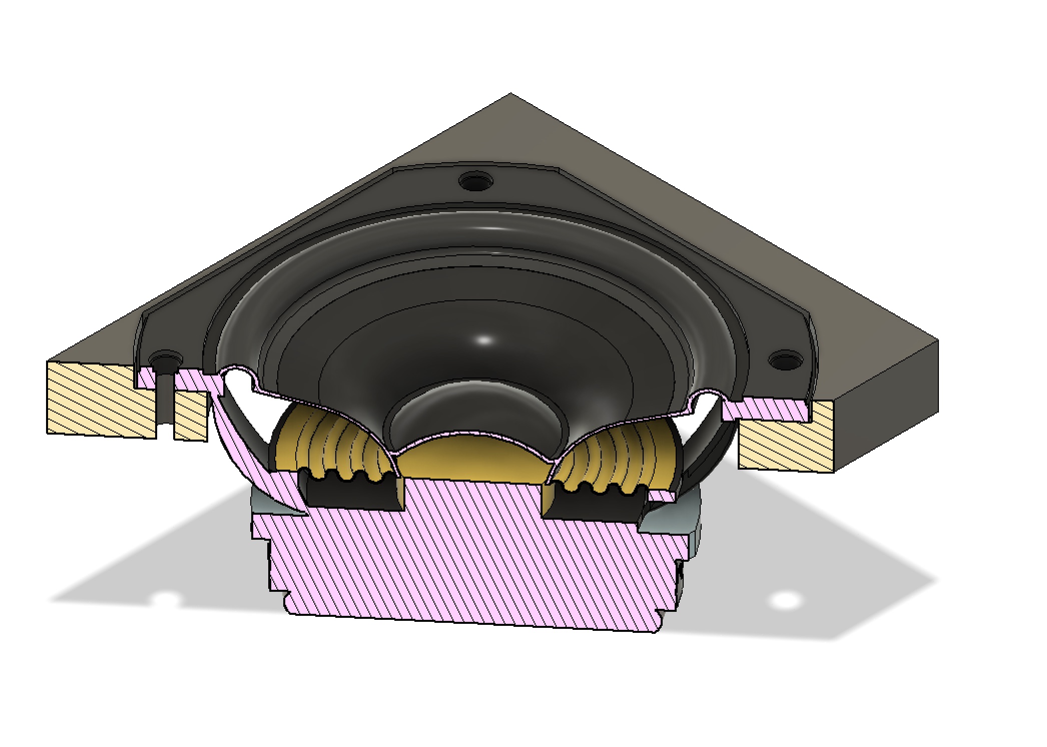

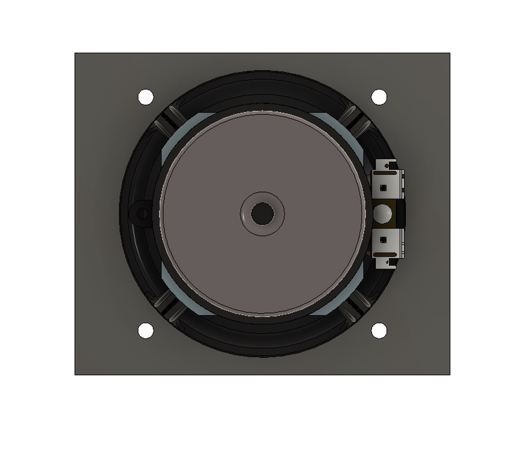

I have a basic idea of the size of the speakers and a minimum baffle width. Once I get my samples in, I will decide whether I need to remove more material from the back around the edge as he did.
Am I correct in assuming that the narrower the front of the enclosures are, the better things will be?
As noted by Roger Russell in his Audio Express article, you will need to make a couple of small notches for where the terminals on the speakers pass through. Depending on the baffle thickness perhaps this won't be a problem.

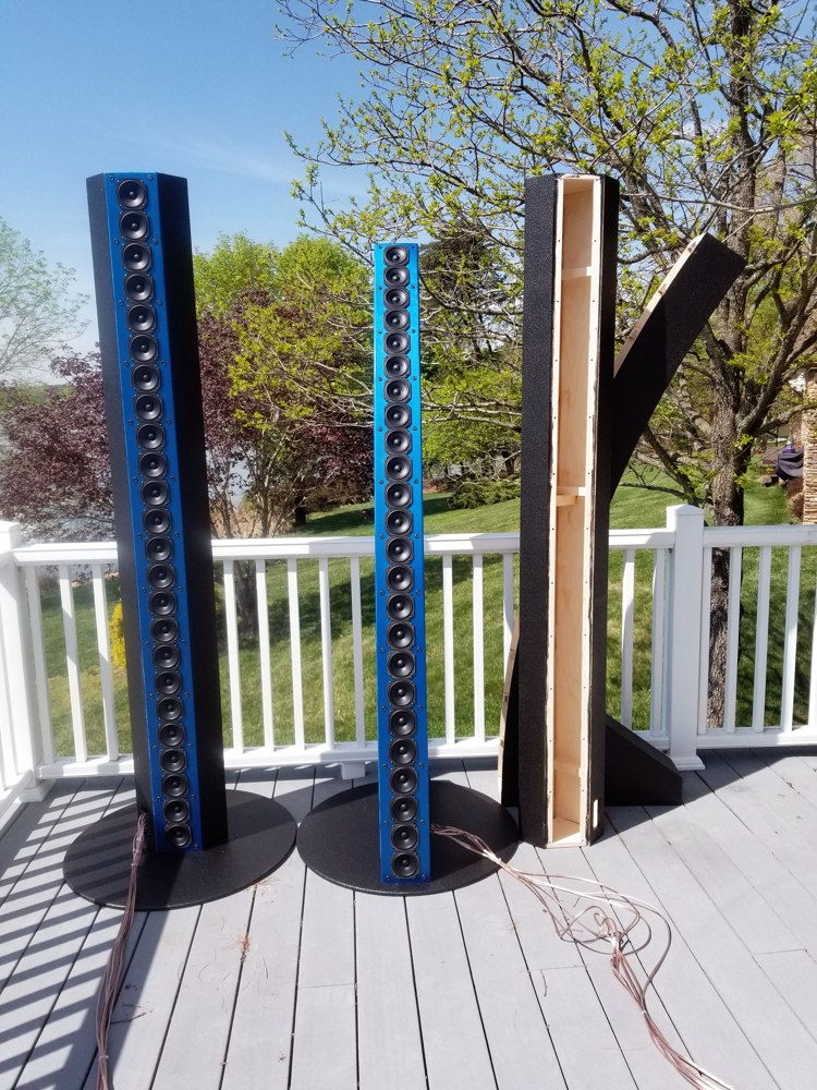

Hi Anchorman,
I went with about 2L per TC9 and no internal baffles. Simple fiberglass stuffing running top to bottom.
I didn't see any need to to randomize anything inside, and so far measurements don't seem to show any particular resonance issues.
Box picts below. (Driver baffles fit either type box, I'm testing one of each right now and thought you might like to see empty box)

I did a quick cad drawing of the basic shape tapered shape in the original IDS-25 speakers, and without internal baffles, it comes to about 31 liters inside, which works out to about 1.25L/driver. Surprisingly small?

Thanks for the pics! Are these meant to go flush in the corner of the room?
I tried to stay as narrow as i could too, just because 'why not?'
And i at least managed a 1/4" roundover on the edges.
Beyond that seemed impractical to chase for my goals.
And honestly, I'm glad I didn't try to do more there.
From experimentation so far, I think driver size and spacing have one or more orders of magnitude more impact, than potential diffraction issues.
But don't let me be a downer when it comes to overthinking...it can sure be fun, huh?🙂
I've just kinda turned into a old guy whose mellon gets tired and wants to know "what works? .... what matters most, and in what order?" LoL
Oh that's waay cool about the BB. I get what you're saying about the grading.
If I couldn't get 8 ft BB I like , I would use some other good 8ft material....would hate to get into splicing...
Yes, they are meant to go flush in the corners. I have interchangeably bases for them, freestanding vs corner.
