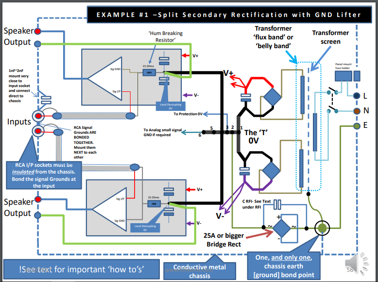

I'm not sure what you mean by heater circuit configuration. All I know is from Blencowes book: twist, keep away from sensitive circuits, cross at right angles, jump straight over at the sockets, maybe elevate and use DC if you have to. Going for AC for now. Detailed design/implementation in a layout will come after this grounding thingy.

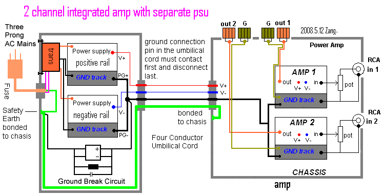

Later in the thread TG linked is the attached image. That looks good to me.
I have a single chassis, but that's no deal breaker.

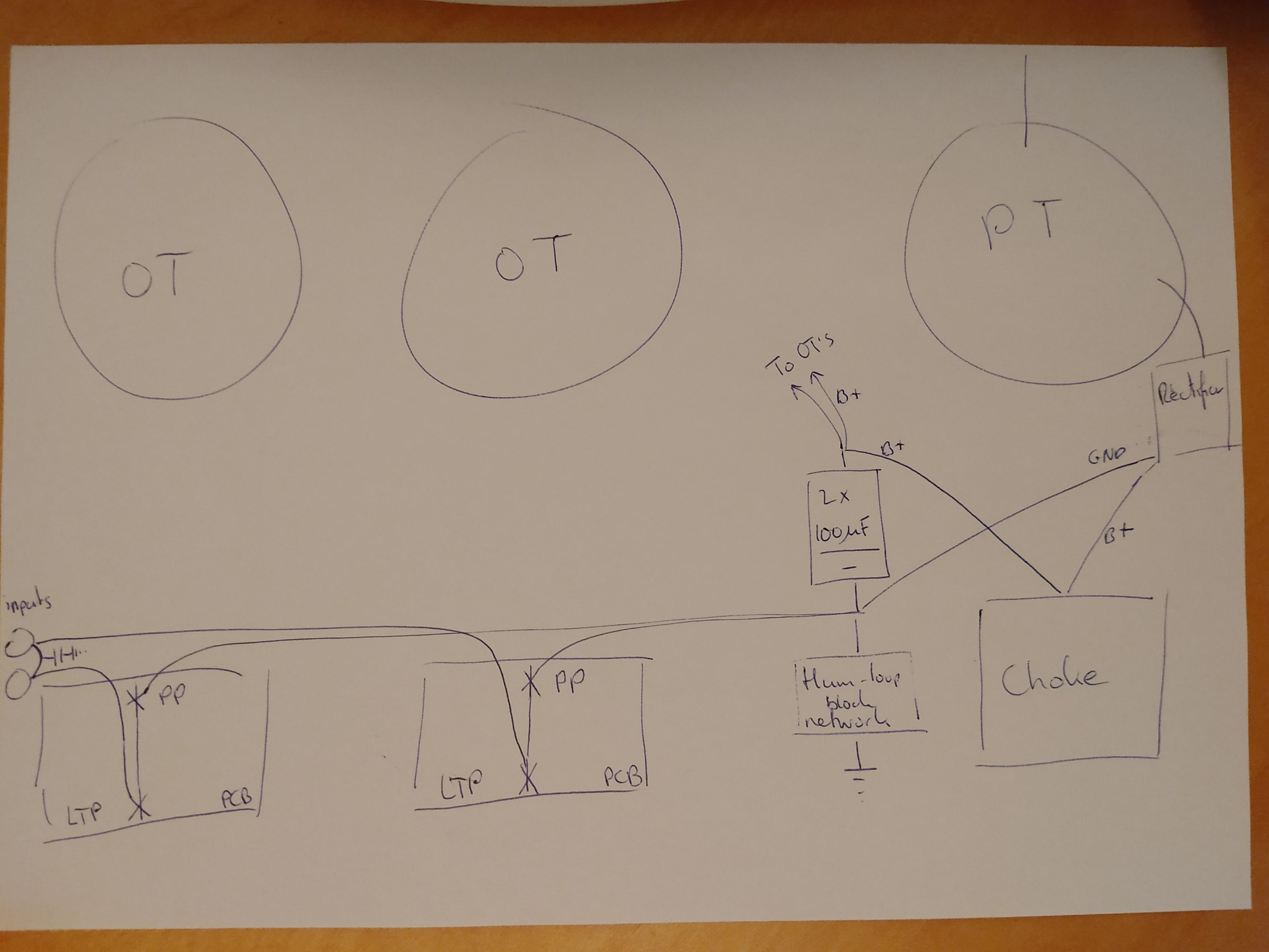

Here's another go at it (attachment).
PCB has two connected local star ground. So a true single bus is not possible. However, I think I made effectively single bus by routing the grounds in one line, with the input ground jumping down alongside the pcb ground trace between pp and ltp. I had to move the inputs to between the input and output tubes. It has to cross a heater; no free lunch... The inputs are tied together and connected to ground via a capacitor. Connection of ground to the chassis is via a hum-loop block network. Pretty much the hifi sonix way. Safety ground is near the iec input.
I'm still thinking about where to put the hum breaking resistor.
And again: fire at will!
Ok so now you are considering a total system including external signal sources - are those external signal sources identifiable (eg. a preamp, or cd player or ...) ? Have you looked at how they manage their grounding?
One aspect of the hifisonix presentation is that it is focussed on solid-state amplifiers, where the influence and mix of hum and noise sources can sometimes lead to different control methods being more influential than other available methods, especially with respect to the order of magnitude (or more) difference between input signal impedances. When or if you get down to testing your amp to a level where you can identify hum and noise levels (ie. a spectrum plot that goes down to the noise floor of the equipment), then it can be helpful to be able to step through individual changes to how your amp is set up and gauge any differences. For example, if the input sockets are a combo where the grounds are solidly linked, then you don't have the easy opportunity to split the grounds.
