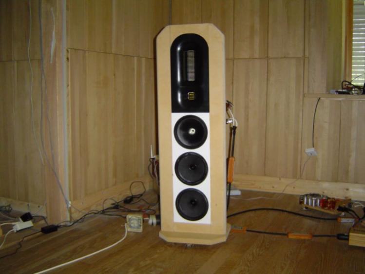

Picture shows the first prototype with AMT "midrange" and AMT "super tweeter" in a CNCed Corian waveguide, and three 8" drivers in a combined CNCed Corian baffle / basket..
hi Raymond
your prototype amt speakers looks amazing. How does it perform ? where do you cross the amt to the cone woofers ? Will you develope a bass amt later on ?

300 or 500Hz (6dB/oct series filter). Bass AMT diaphragms and parts was developed and made more than three years ago - but never assembled.. Since then a lot of new products / technologies have been researched, developed and prototypes made.. Production, marketing and sales are not my "cup of tea" and time and cash then only allows for prototypes and pre-production items for my own use...
