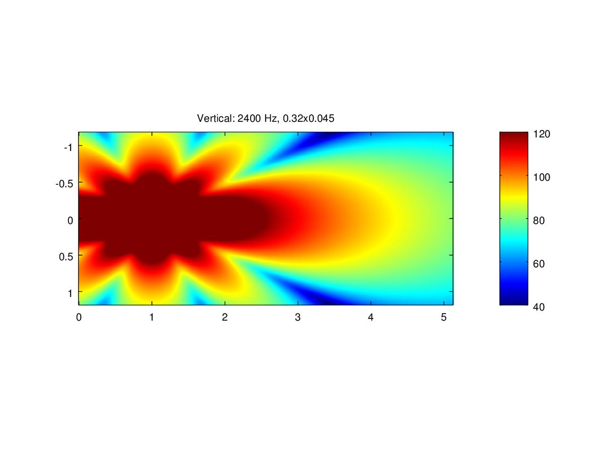

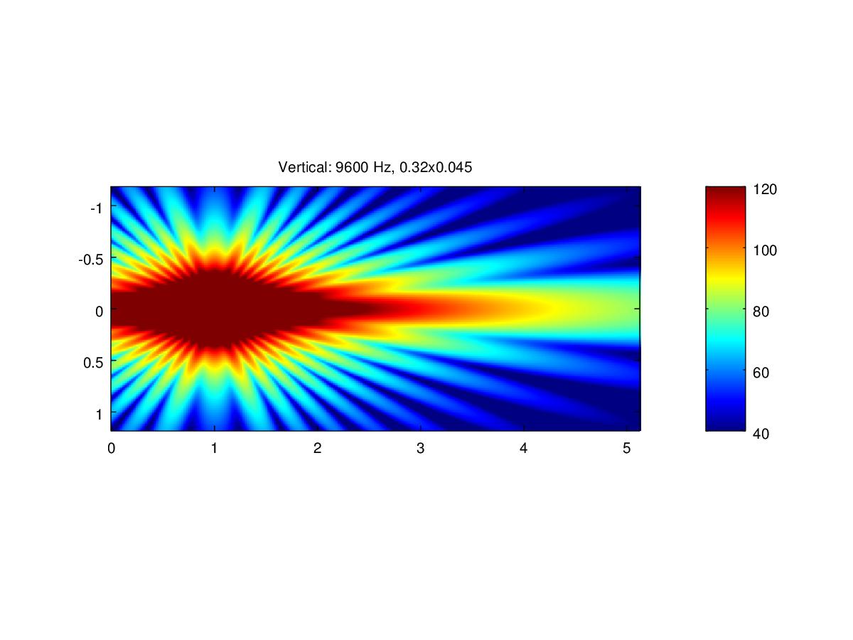

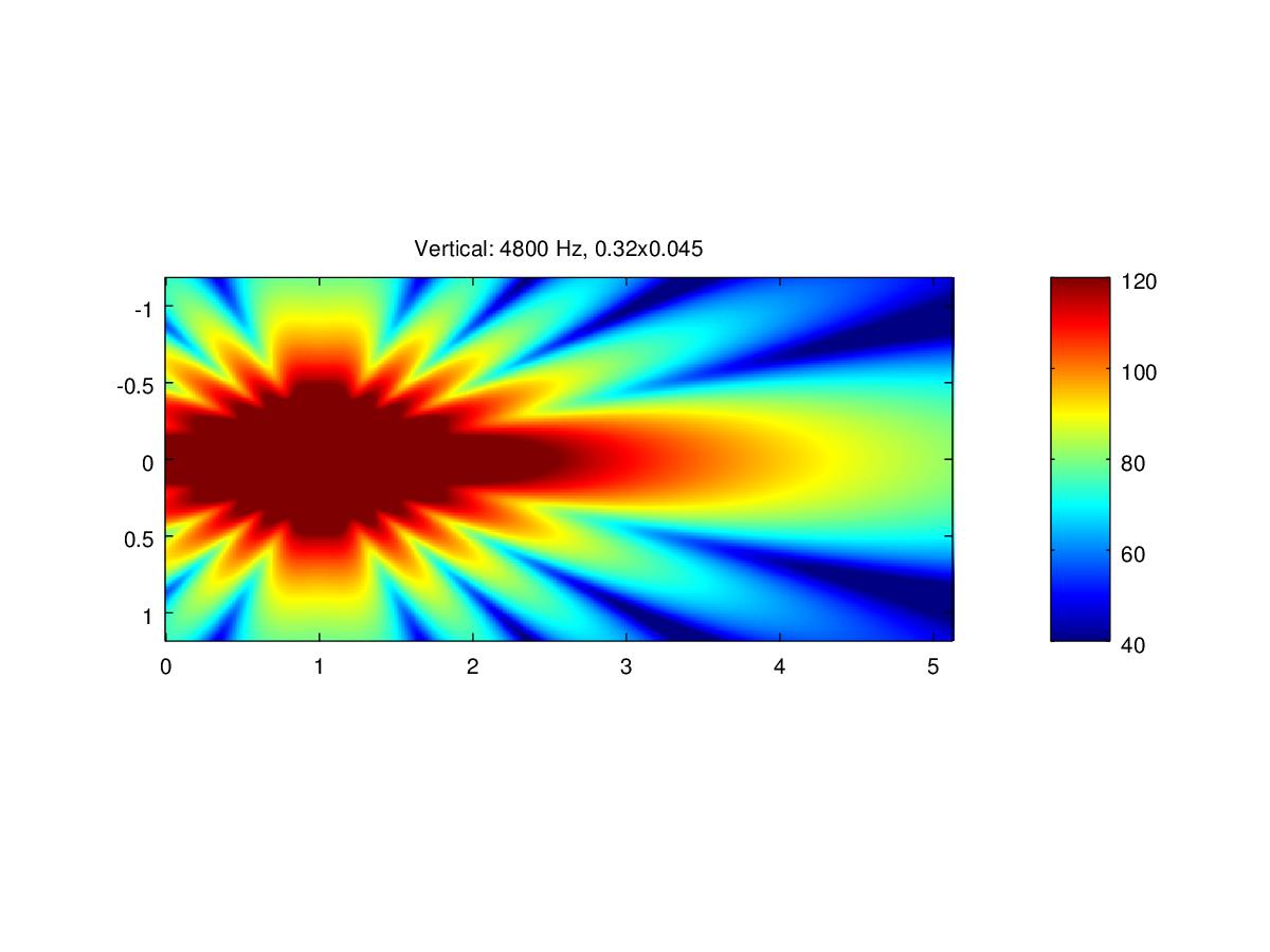

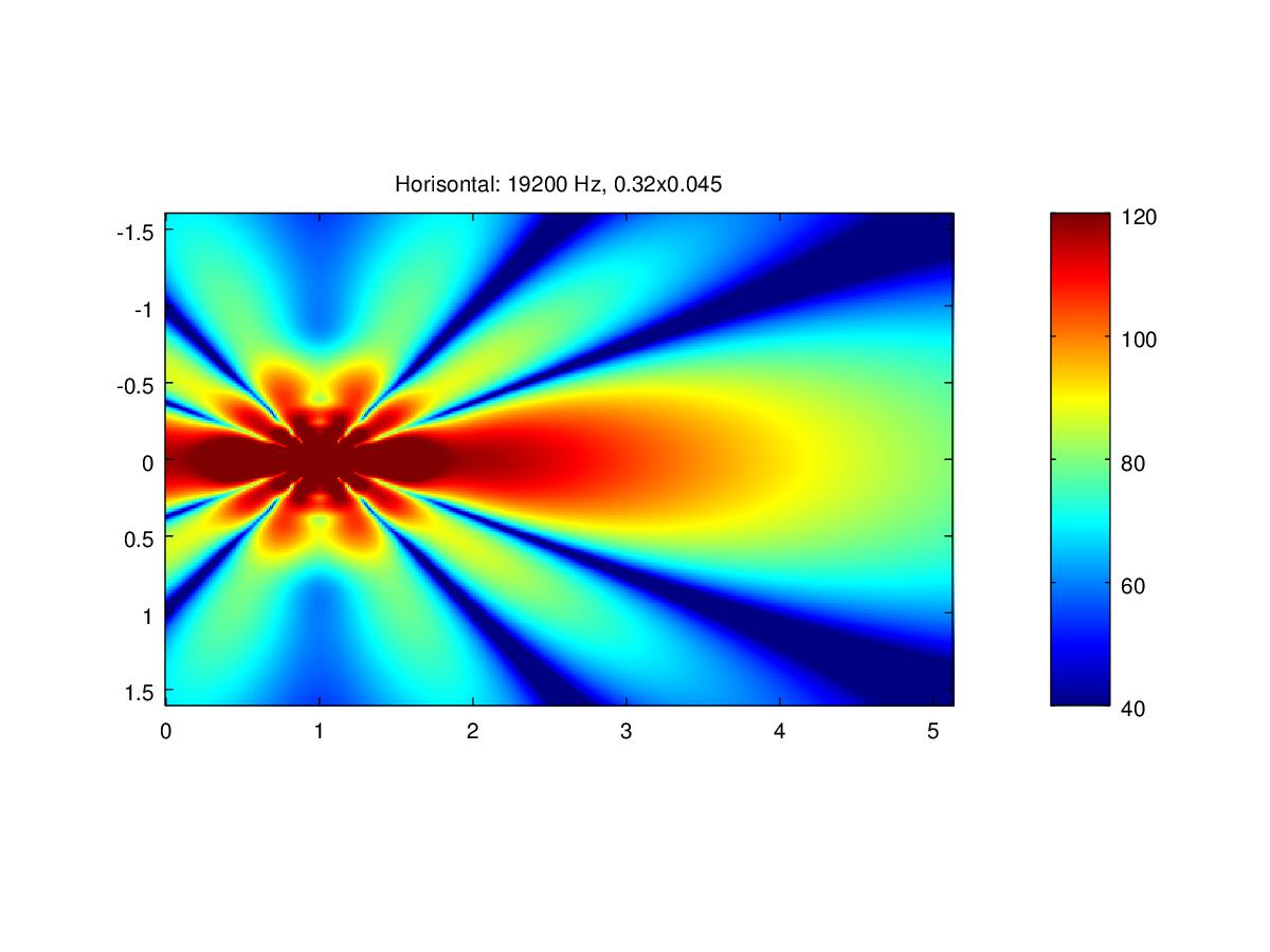

So how to interpret this then?
The higher the frequency the longer the way in a cylindrical radiation pattern and thus only dampened with 3 dB/DD (DD being Double Distance).
The lower the frequency and shorter the distance the radiation pattern ( - 6dB/DD) will be spherical.
The AMT is 32 cm high, so the radiation pattern type changes based on frequency and distance.
At frequencies lower than 3 kHz we have the same radiation pattern mixture but above that it'll be more and cylindrical pattern the higher the frequency is.
So measuring at 1 meter or even worse 50 cm and then EQ accordingly will result in a different frequency response at the sweetspot; too much treble.
Best is to have the same radiation pattern type for all frequencies from the speaker to the sweetspot.
And that usually means a point source (spherical radiation pattern) or a long enough line source (= cylindrical radiation pattern).
It is hard to make a point source out of an AMT.

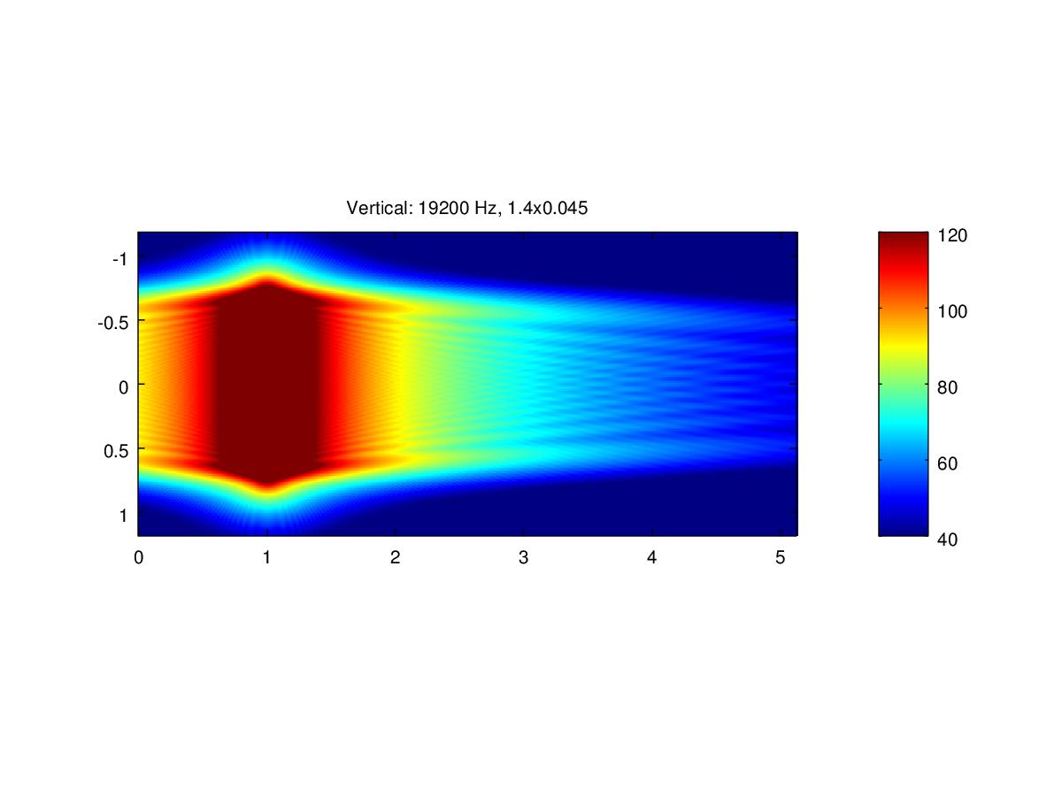

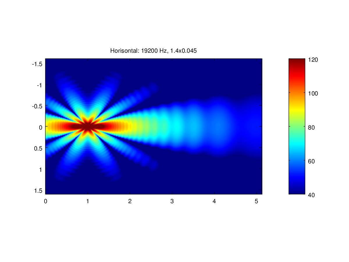

If I can't go pointy with an AMT, I'll have to go longy.
Some simulations are coming up soon.

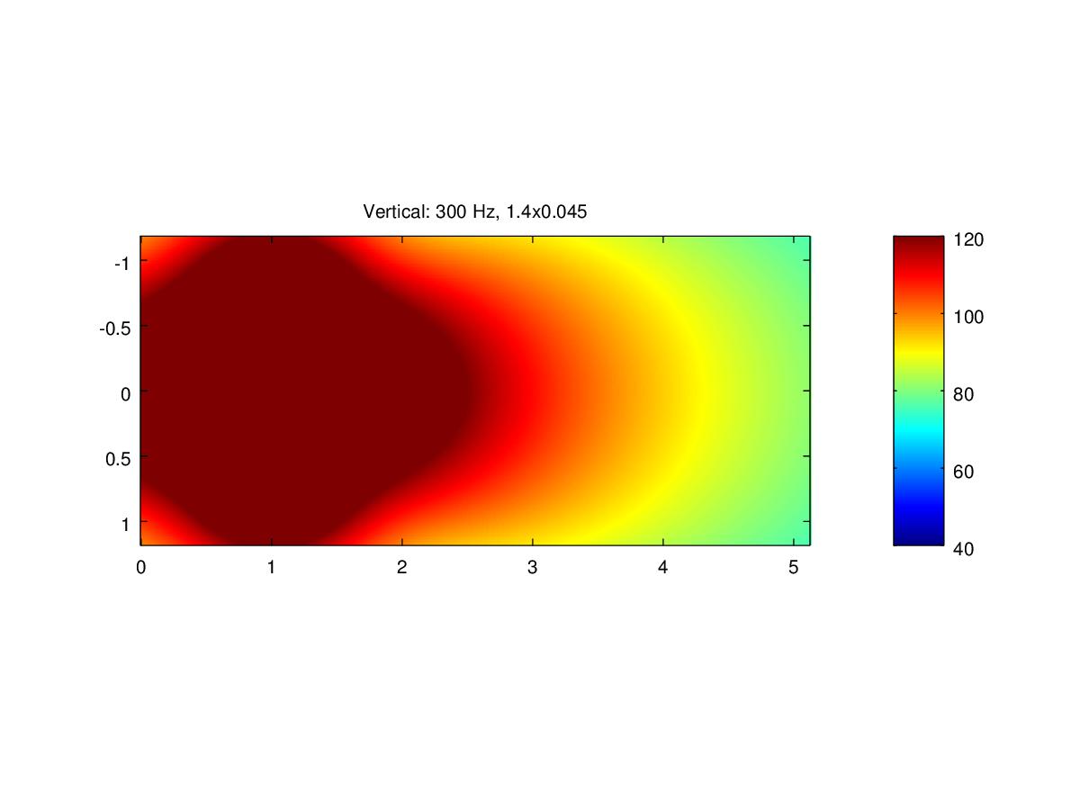

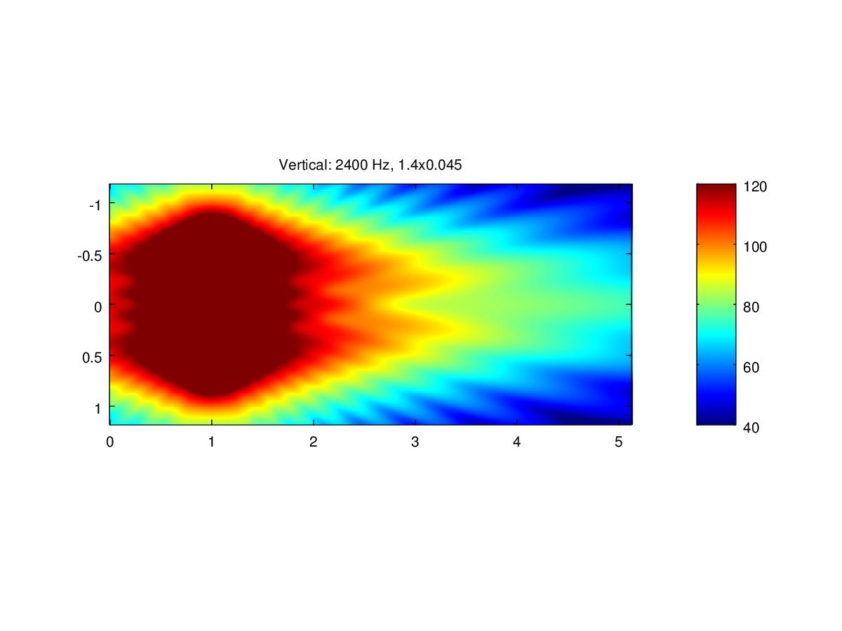

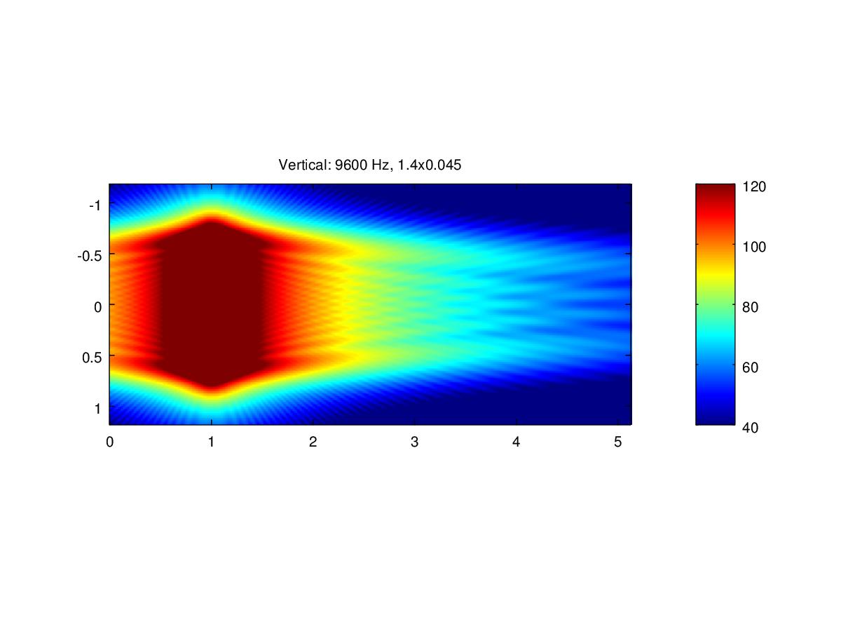

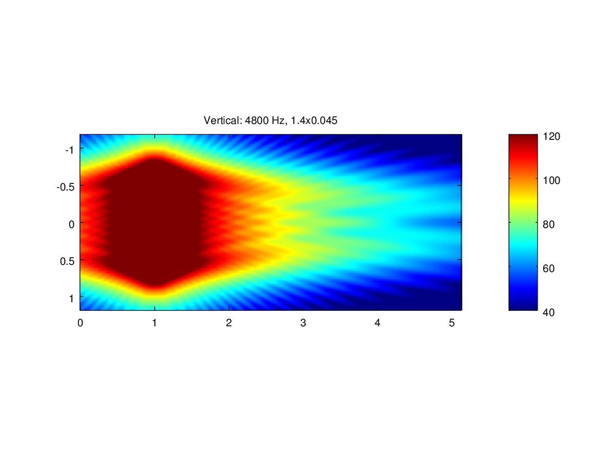

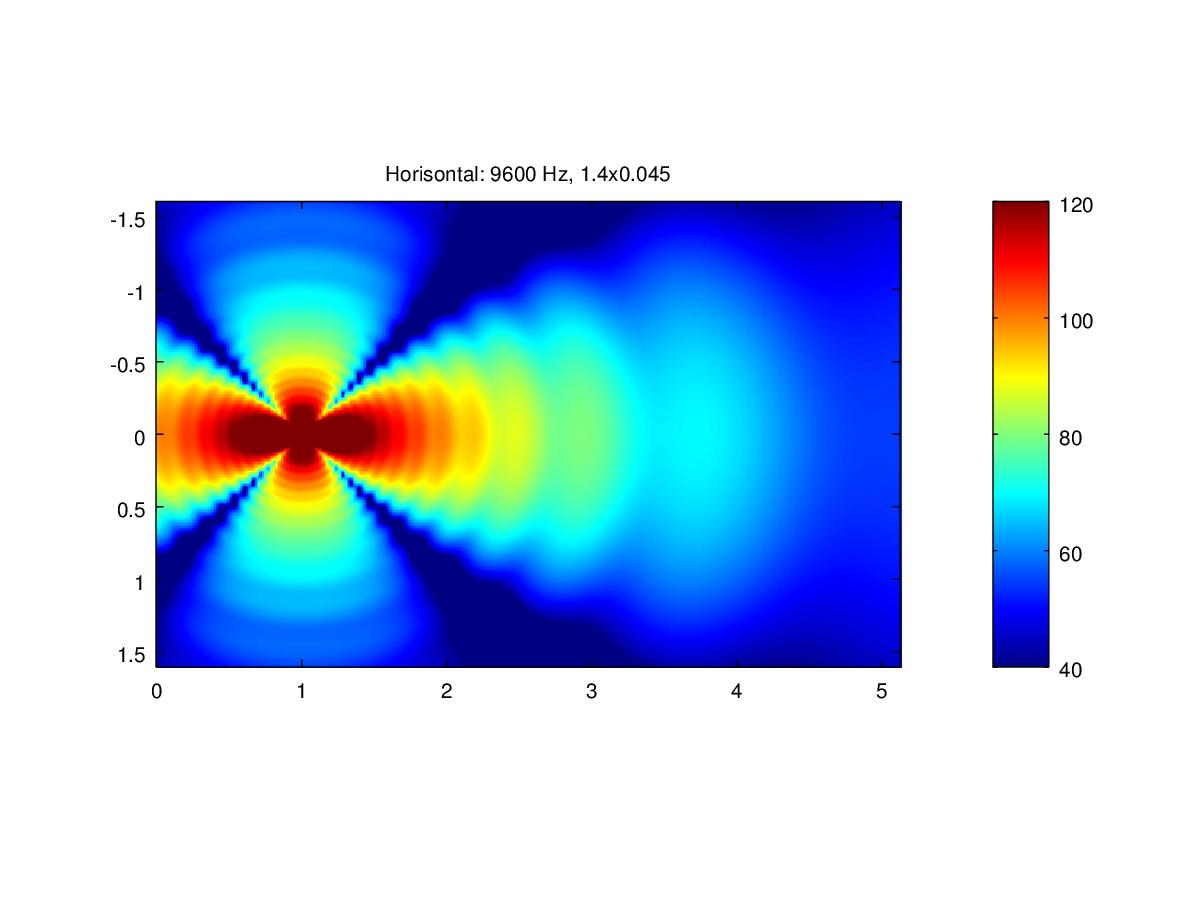

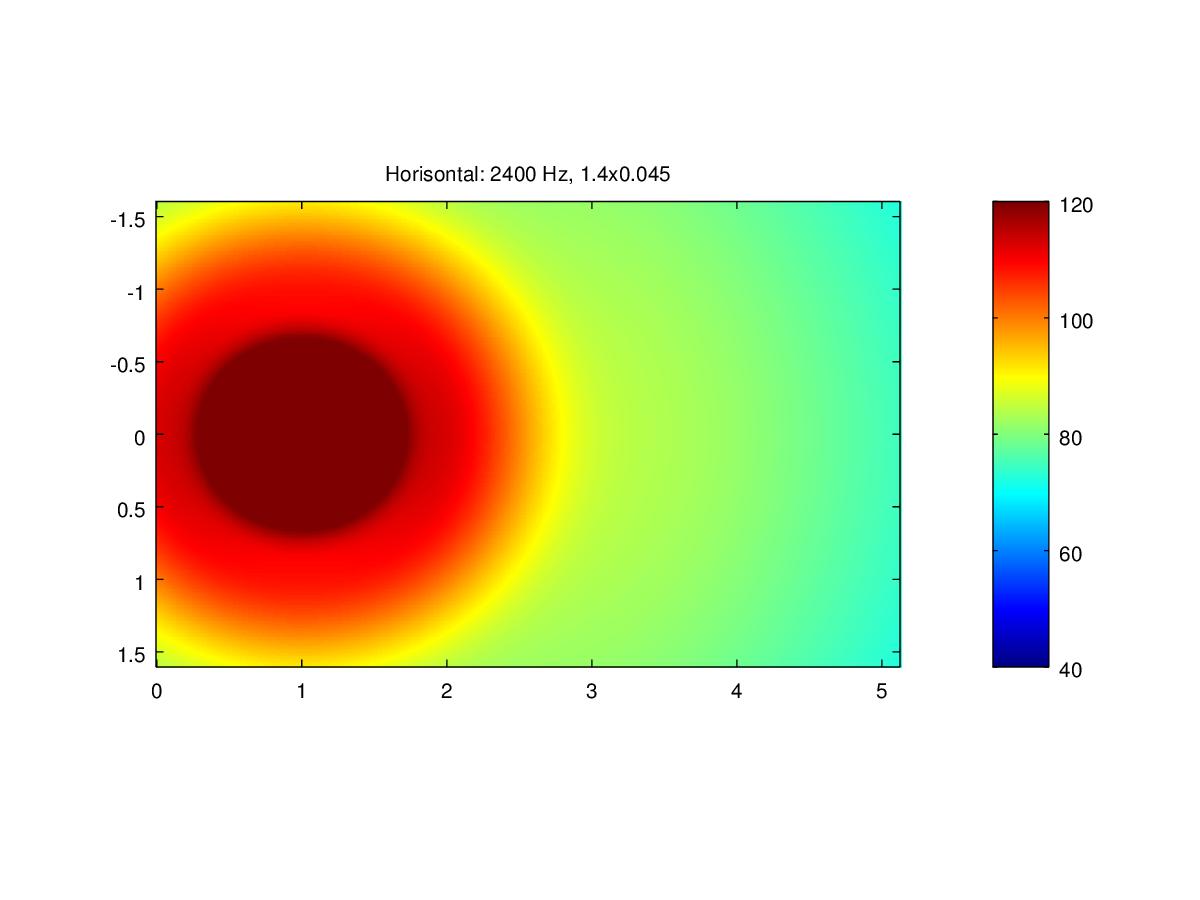

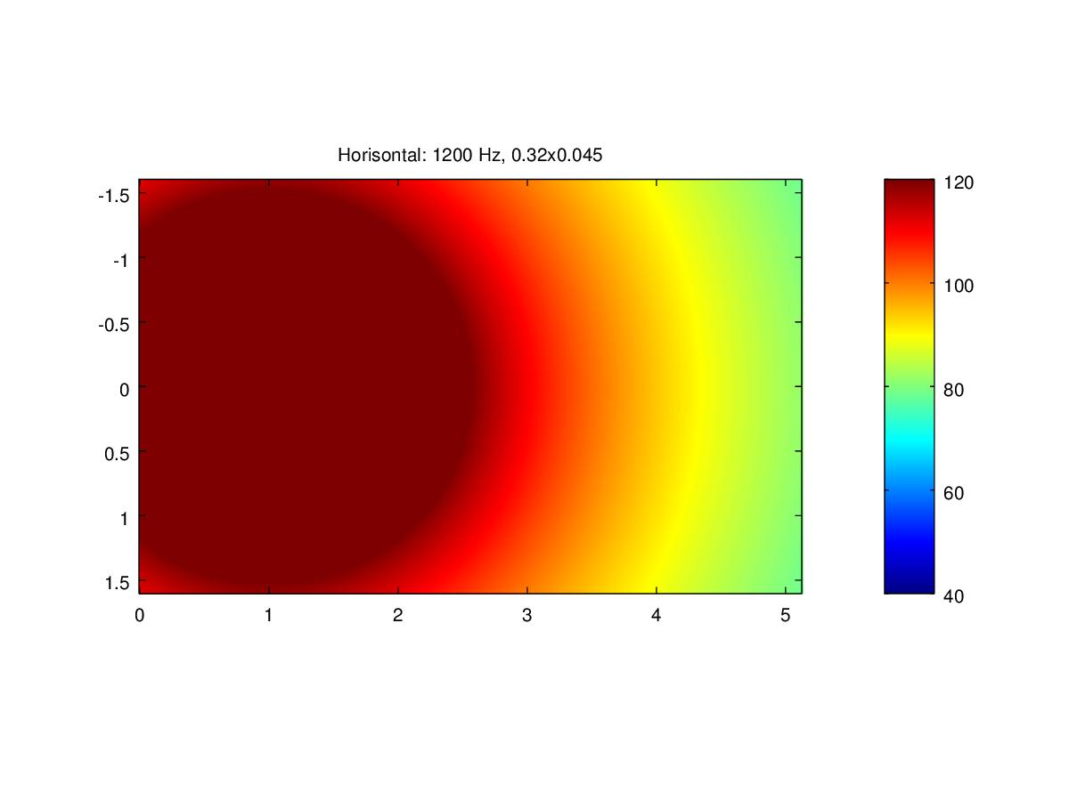

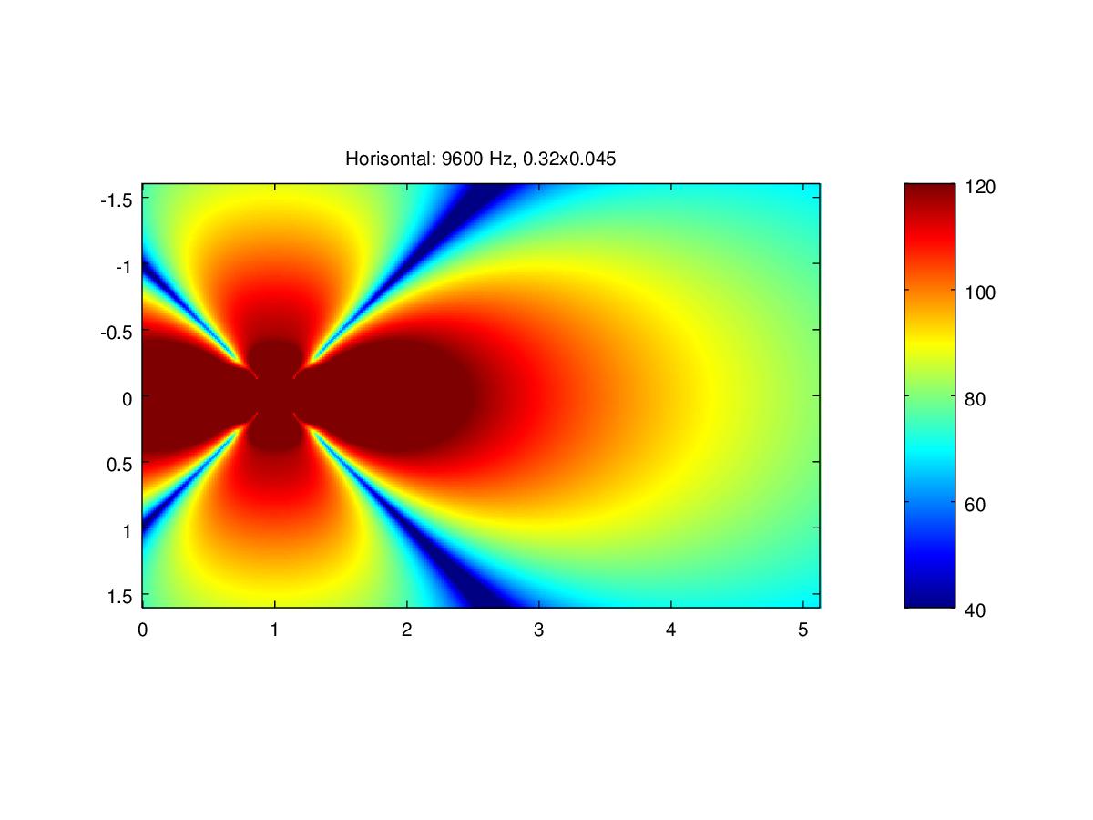

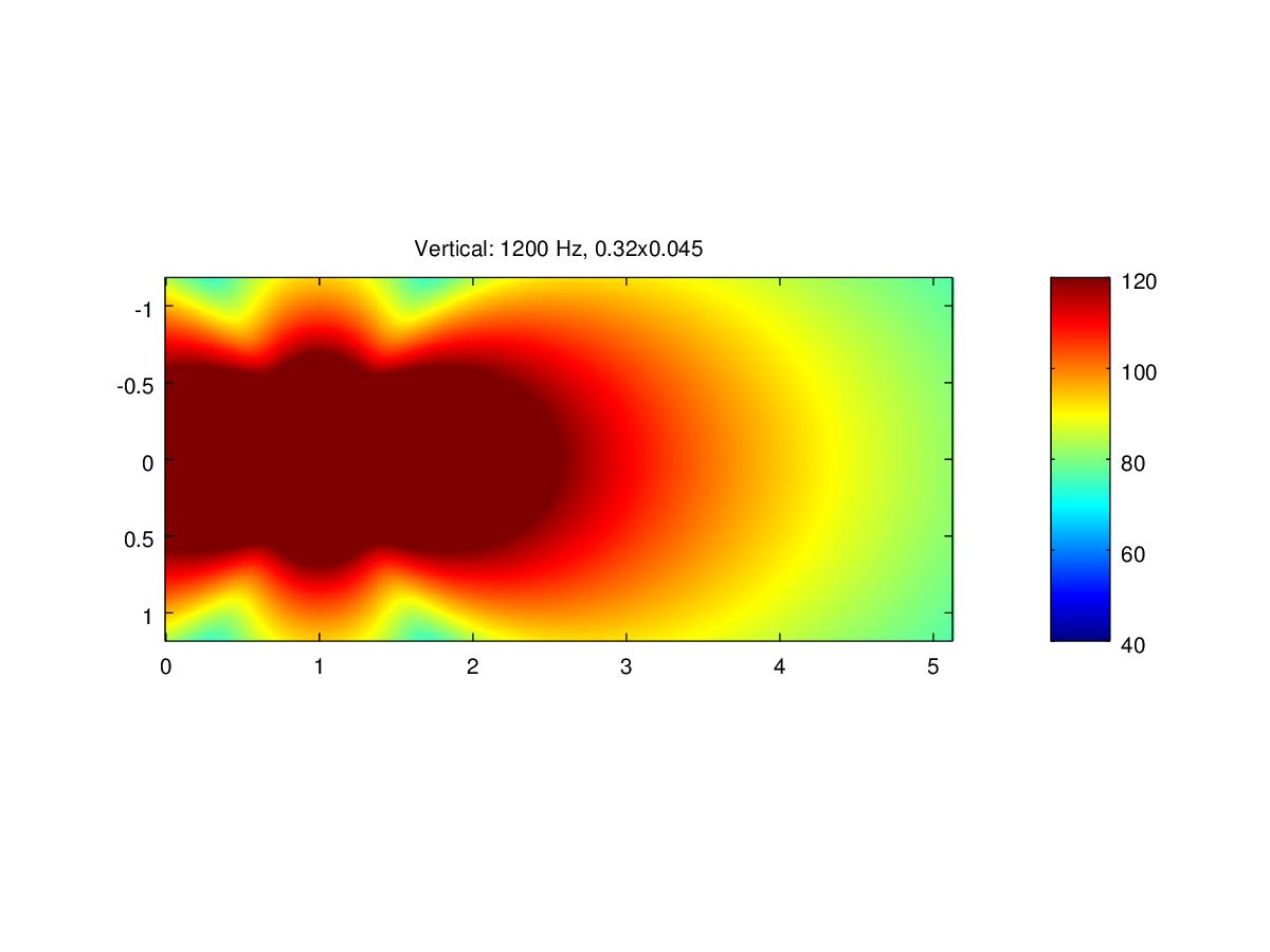

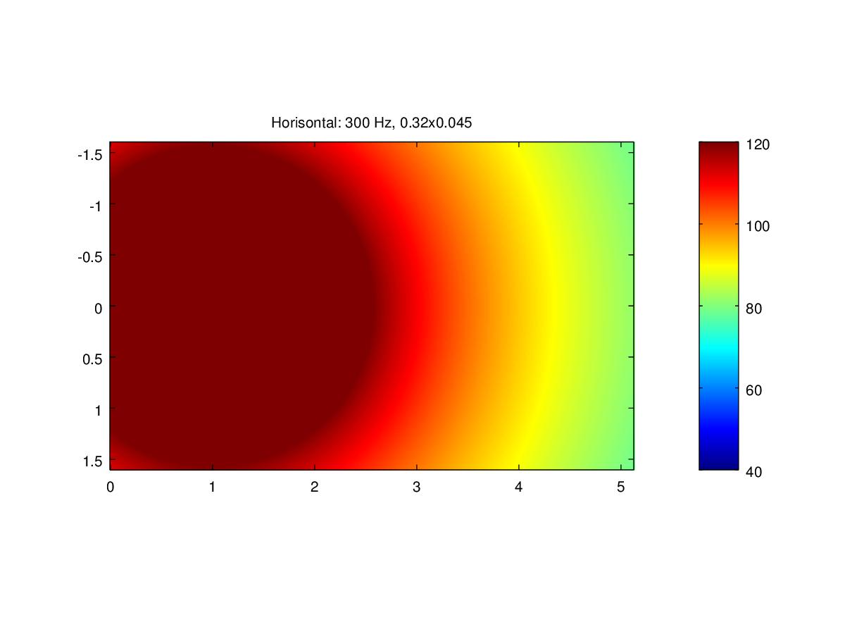

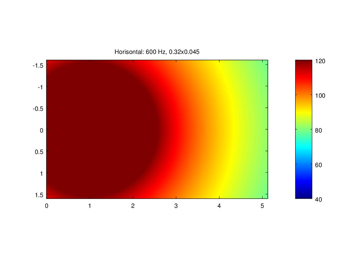

Here's an example of simulation of vertical and horizontal dispersion patterns at 2400 Hz for the 32x4,5 cm AMT:
The AMT source can be seen as a black dotted line around one meter from the front wall to the left.
Sweetspot is a small white dot at 4 meters.
No reflections from the walls, ceiling or floor are considered, neither is any baffle.

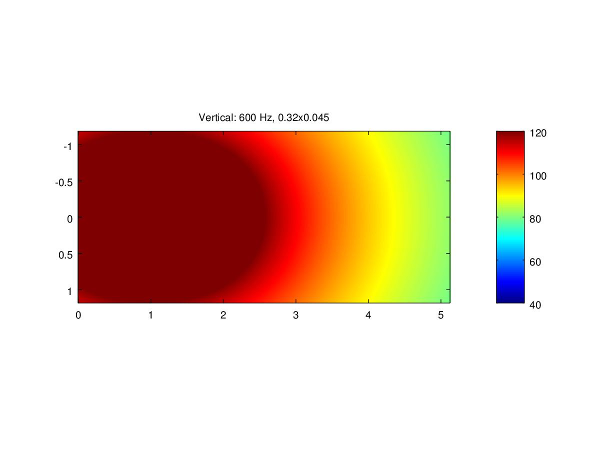

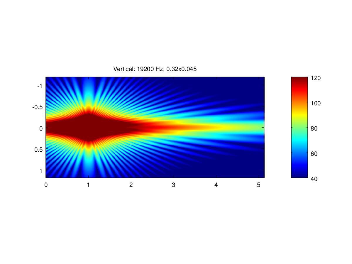

Vertical dispersion patterns for the 32x4,5 cm AMT.
Source and sweetspot are according to above; couldn't them into the file.
Horisontal dispersion patterns for the 32x4,5 cm AMT.

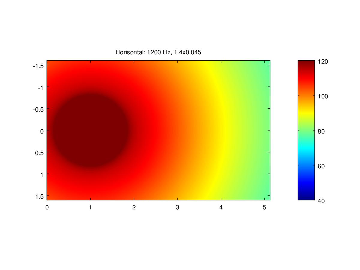

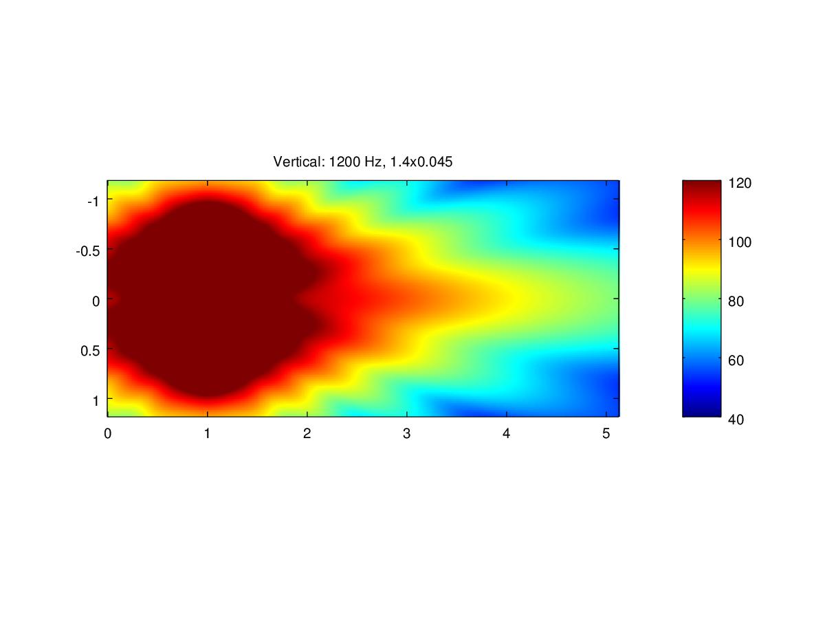

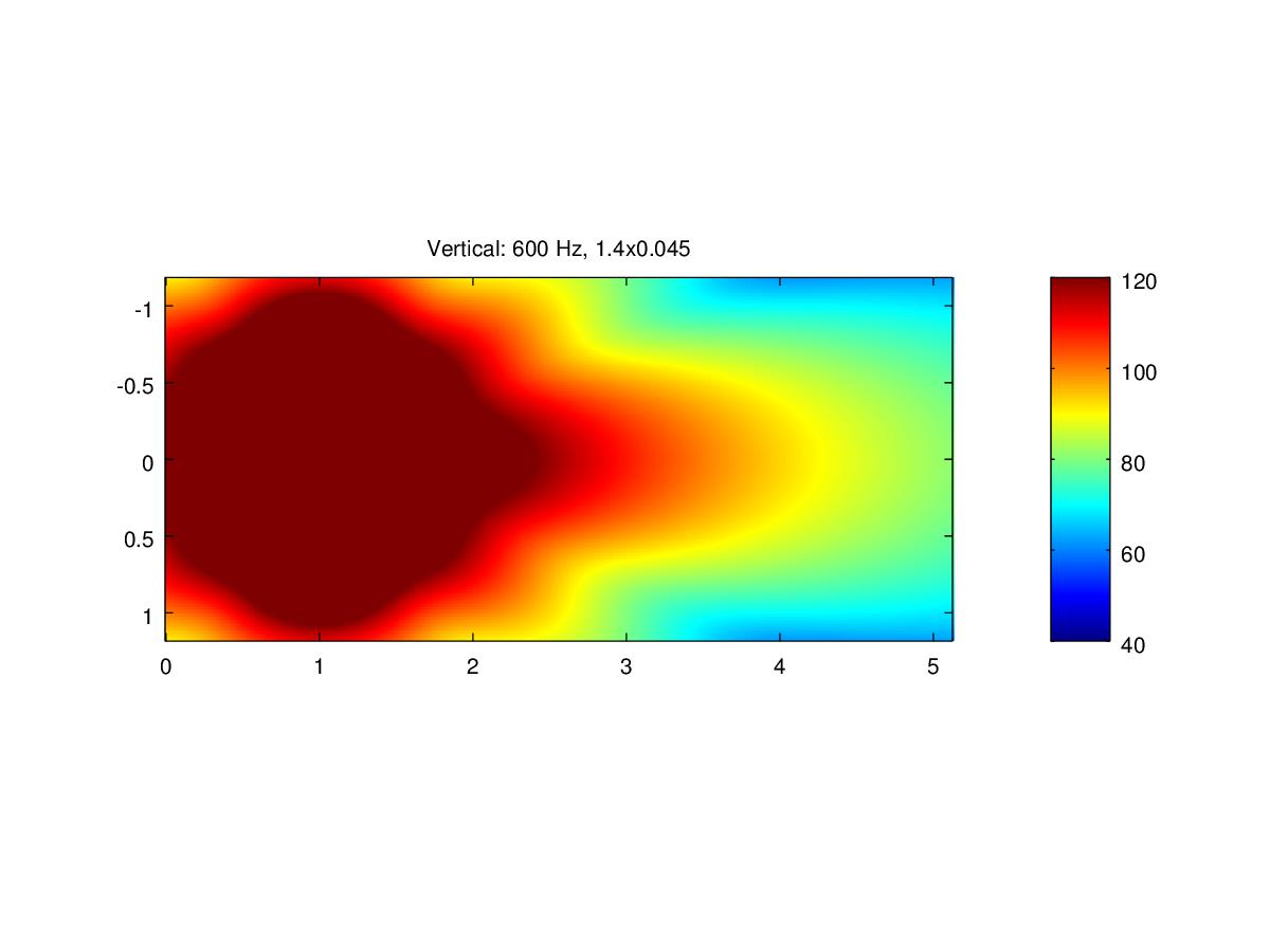

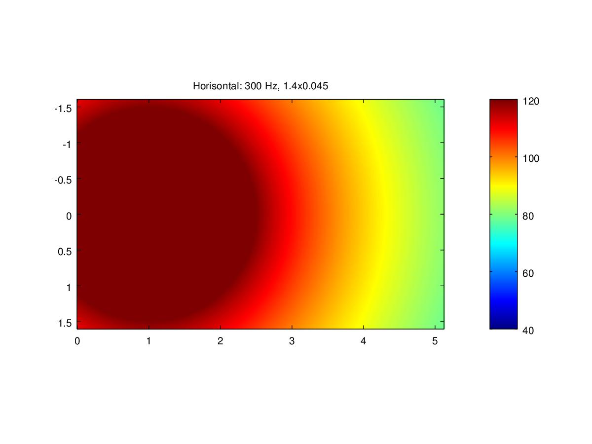

Vertical dispersion patterns for a 140x4,5 cm AMT.
Horizontal dispersion patterns for the 32x4,5 cm AMT.
