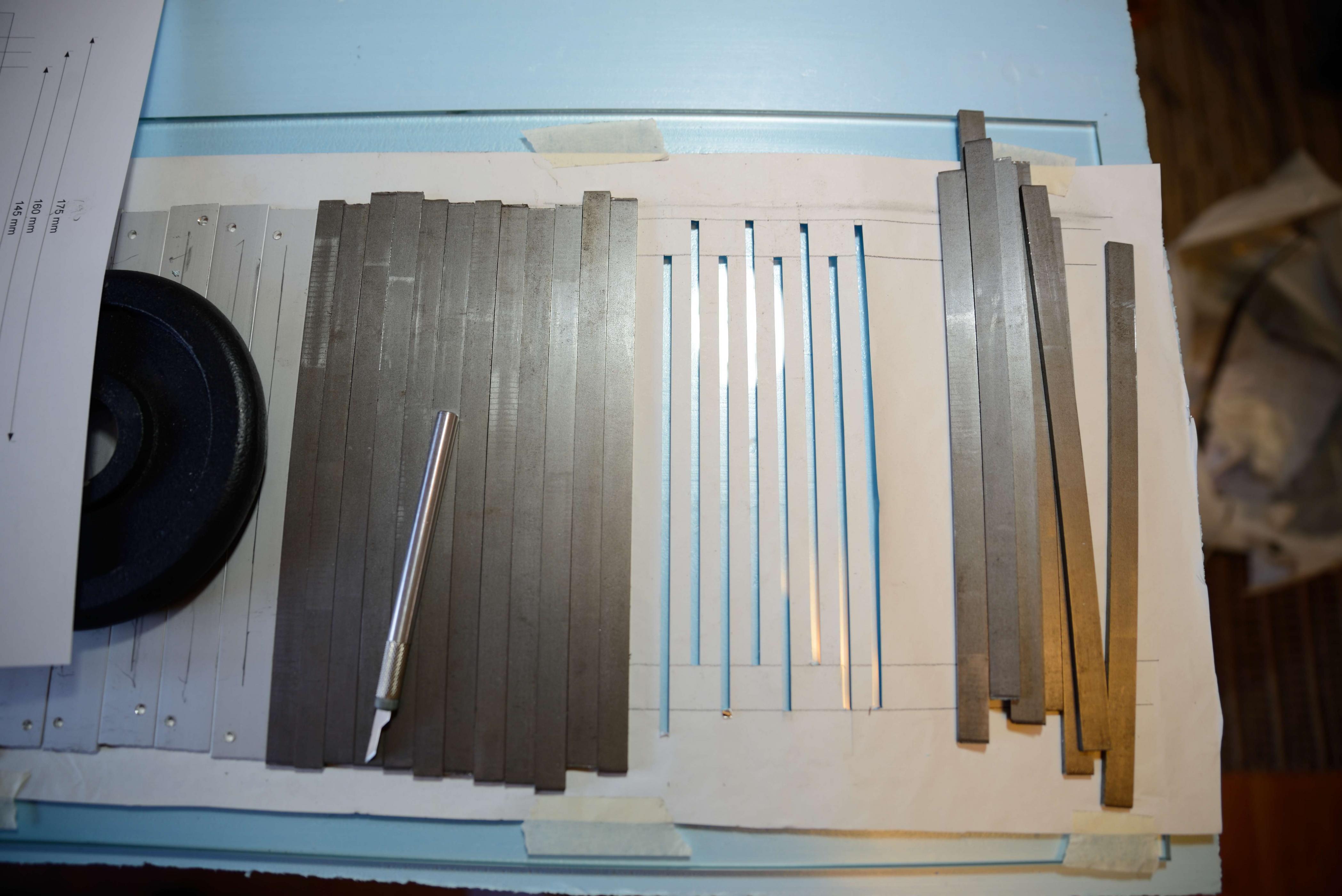

How to make a membrane, first attempt.
So here´s an idea on how to do it.
First I put some 200x800 mm alu/paper on a piece of glass with alu down:
  1. Tape at the edges
  2. Draw the voice coil traces on the paper side
  3. Cut according to the traces
  4. Remove the alu residue
  5. Cut the edge tapes
  6. Place a second glass over the first one
  7. Flip over
  8. Remove the top glass
  9. Tape at the edges
  10. Apply the polyester film, 160x600 mm
  11. Tape horisontal stripes at 30, 70 and 120 mm height (might be omitted)
  12. Cut the edge tapes
  13. Place a second glass over the first one
  14. Flip over
  15. Remove the top glass
  16. Tape at the edges
  17. Remove paper from alu/paper
  18. Cut bottom and top edge tapes
  19. Put cotton thread in every fifth fold
  20. Apply polyester film
  21. Cut out the membrane
Fold and bake.
Comments?
I dont think it is good to cut at glass ,but I have not tried it.The knifes have to be wery sharp,or alu/paper will be ripped.
Bernt
we used to cut at glass, back the building apogee clones 😉
yes, sharp knife
but not only that
blade edge have to be 100% smooth without any trace of 'roughness'
using only very light pressure
knife should cut almost by itself
but its still ... :headbash::smash: but you know that better than anyone by now 😀
I´ve always used glass since I first started to cut foil for the ribbon speakers.
So for me glass is the natural choice.
Of course I then used a rotary cutter because otherwise the alu would have been torn as you say, båndsei.
Cutting from the paper side though provides enough friction to avoid tearing.
It works perfect.
I´ll try to make a fifth of a membrane, that is 120 mm, first to prove the process.
Well the double knife didn´t work out.
But I can fairly easy make cuts 3 mm apart with a single knife using the same rods I used when I built the motor; they are 3 mm by 10 mm.
So I have the spacers for doing two 3 mm parallell cuts, 10 mm apart.
@båndsei: After wetting the paper, does one only carefully peel it off?
I make half of the cuts and tape them ,cut the rest ,tape them and peel the taped alu/paper off the cutting plate,powder the alu side,wipe the rest of the powder away.
Place the 3m tape with the adhesive up,and place careful the taped alu/paper with paper up.
Rub careful,turn it over and rub again from the other side.
I go to the kitchen and pour a little water in the zink,ad a little dishwash soap and pce the diaphragm with the paper down,wait a minute ,turn it over and the paper and microporre tape is easy peeled off,in one piece.

Conclusion
I will try to follow this scheme:
  1. Cut between inner left and outer right
  2. Cut between outer left and inner right
  3. Repeat 1 and 2 until finished
  4. Lift up membrane and put it away (membrane is still in one piece)
  5. Powder the cutting table
  6. Place the membrane with paper side down on the cutting table (no need to wipe excessive powder away)
  7. Apply film (the film is applied and not a delicate membrane.)
  8. Flip membrane (paper side up)
  9. Cut out membrane along membrane left and right
  10. Remove paper with water and :soapbox:
  11. Place the membrane with film down (optional)
  12. Apply threads (optional)
  13. Apply film (optional)
  14. Fold and bake
I think that this scheme is safer but I will be grateful for any caveat.
You dont mention taping ?
First, I tape the alu/paper to the cutting plate at all sides.
Powder has to be on the alu side to make the tape placed on the cuttings less sticky.
I cut all left-right tape them, turn and cut all left right tape them.
If you look at my pictures you might see it.
Bernt
I think i see your idea.It is not the same way i do it.
You say film,do you meen 3m tape?
I think it will be wery difficult to aply the film to the cutted alu/paper.
I apply the cutted, taped and powderet alu/tape to the 3m tape,wich is taped to table or cutting plate.
The 3m tape gets electric charged and wery difficult to handle.
The cutted taped and powderet, I use, is easier to handle.
Try a small scale test!
Bernt
Looks good
You pin pointed the dilemma I will be facing: film to membrane or membrane to film.
I think it is a higher risk with the latter as the membrane is quite large.
I´m used to the film to membrane technique since when I made my ribbons.
Yes, film = 3M 74 tape.
Small scale test? I don´t think so.
Small scale test = small scale problem.
Real scale test = real scale problem.
