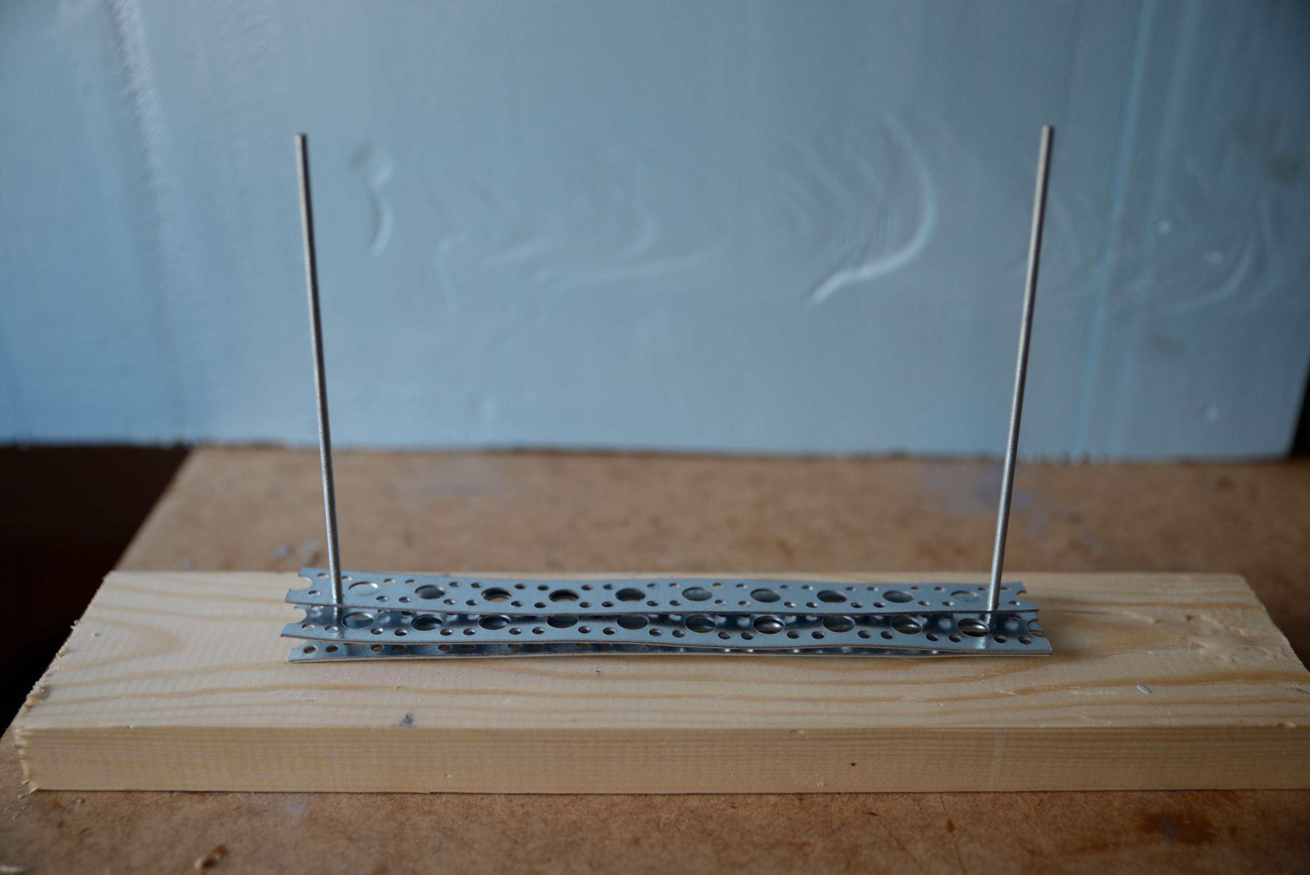

My first attempt with nail strips didn´t work out so well.
They are impossible to get straight and are also too thin.
I need some sort of rod, capable of 170 degrees Celsius, 1-3 mm thick and 6-8 mm wide.
In case of 1 mm thick, I´d have to use 2 or 3 of them between each fold.
Any ideas on the material?

Folding tool, mk II
So I never got the tolerances correct for the drilled aluminium rods.
I also suspect that it´ll be hard to get the membrane out of the tool once it had baked.
I had to come up with something else where I could rely upon any materials intrisic dimensions as far as possible.
I had figured out that in order to have a 8 mm deep membrane, two 20 mm rods need to be 32 mm in total if they overlap.
So I took some U-shaped aluminium and screwed them 160 mm apart, the height of the finished membrane:
Build two sides:
Mounted them in the Us:
Made some spacers from the 20 mm rods:
Placed the rods and spacers,
and started to fold:
If I need to adjust something or just take a rest from my folding, I can put a temporary stopper at the top:
Once the membrane has baked, the tool should easily fall apart if I remove these screws:

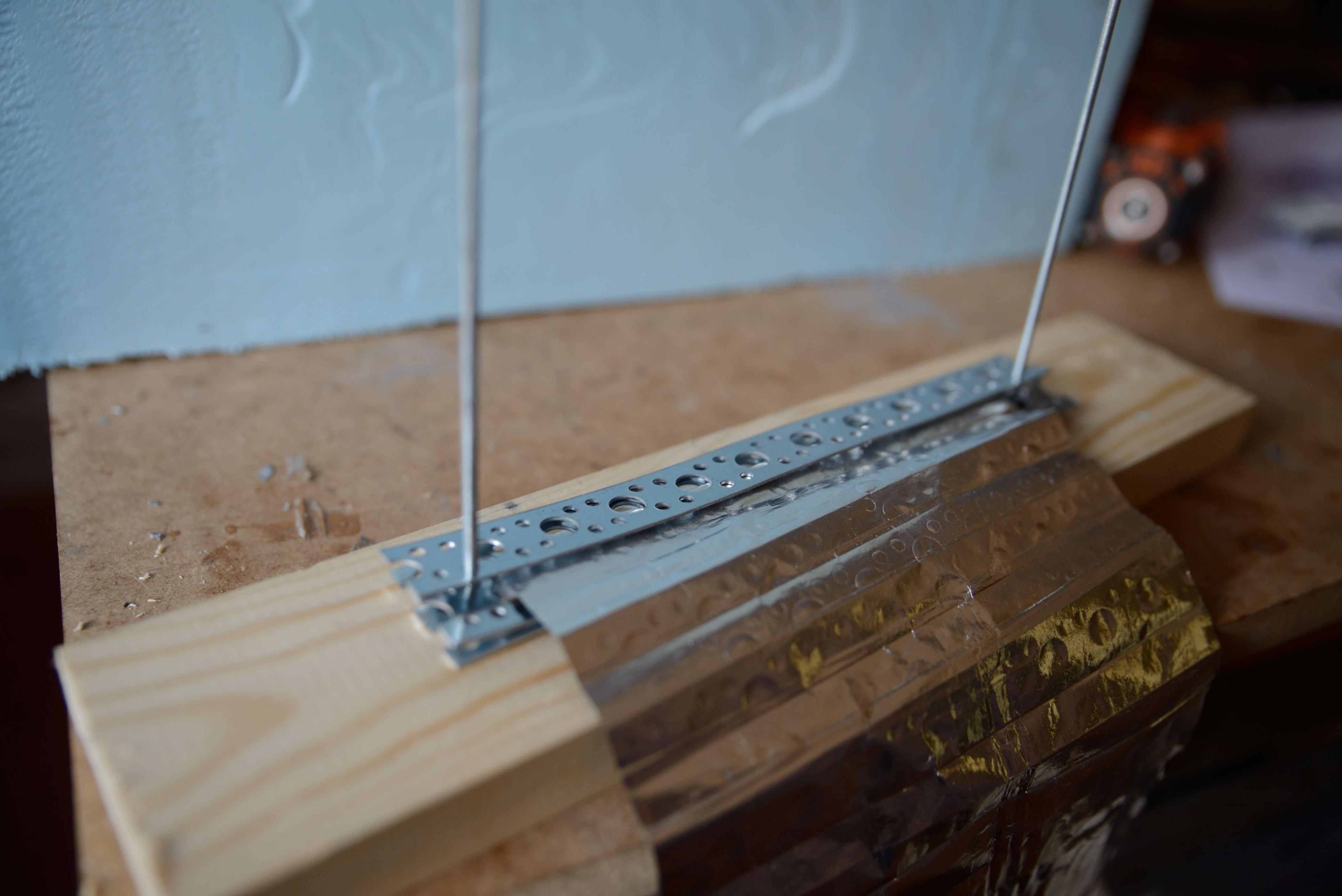

Now it is time to cut some aluminium foil.
The aluminium foil, if I have calculated it correctly, is over 7 meters long in all.
So I have to make the strips as wide as possible, considering the thickness of the foil (7 um).
I consider making a full dummy membrane with a 80 um paper like the one in post #51 in order to get a general feel about length and the tool handling.
That paper is 80 um thick. The alu+paper is 30 um and the polyester film is 20 um but it should do.
Then I need to correlate it to a piece of the real membrane as you suggested.
You have to remove the paper from the alu/paper .
It is easy done with water and dishwash soap.
To ease the removal I powder the diaphragm with "kartoffel mel" and remove leftover´s with a cloth.It is done before it is placed at the 3m tape.
Bernt
When you have cut and taped the alu/paper ,pell it off the cutting board and place it with the alu upwards.
Then powder with the potato starch,to prevent the adhesive from the microporretape to stich to the 3m tape.
Make a sample to test it.
