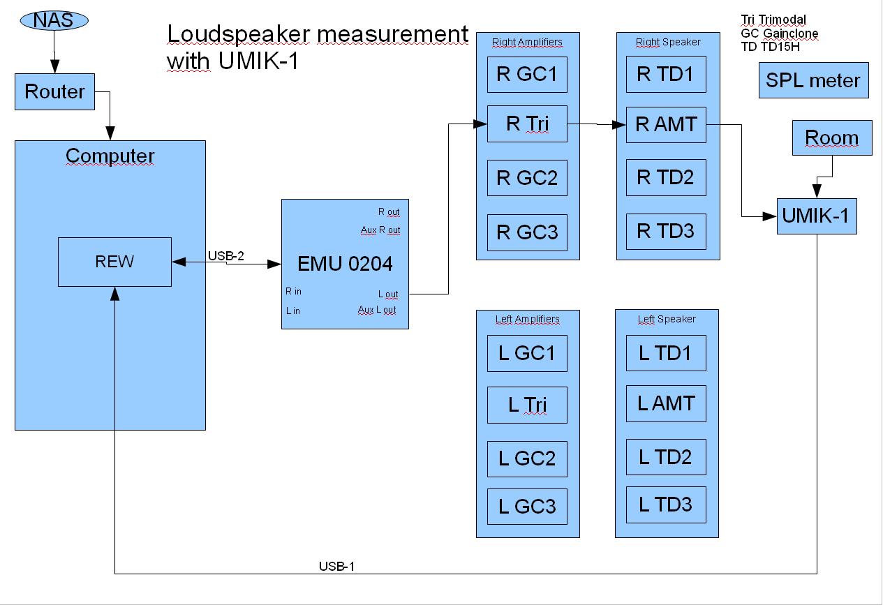

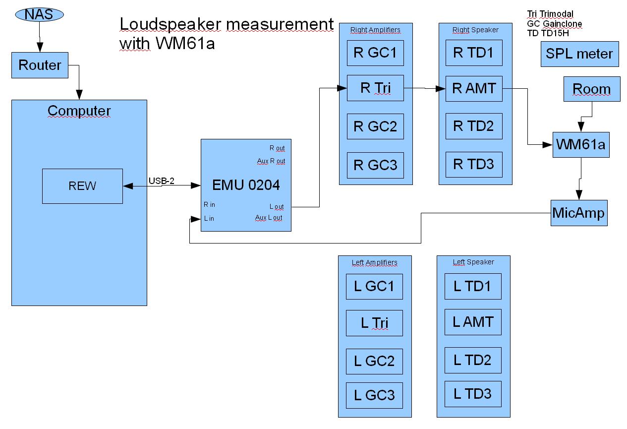

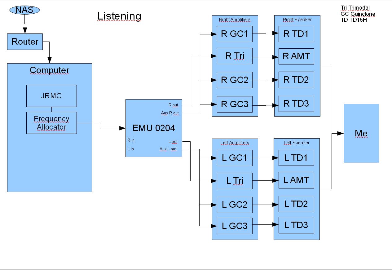

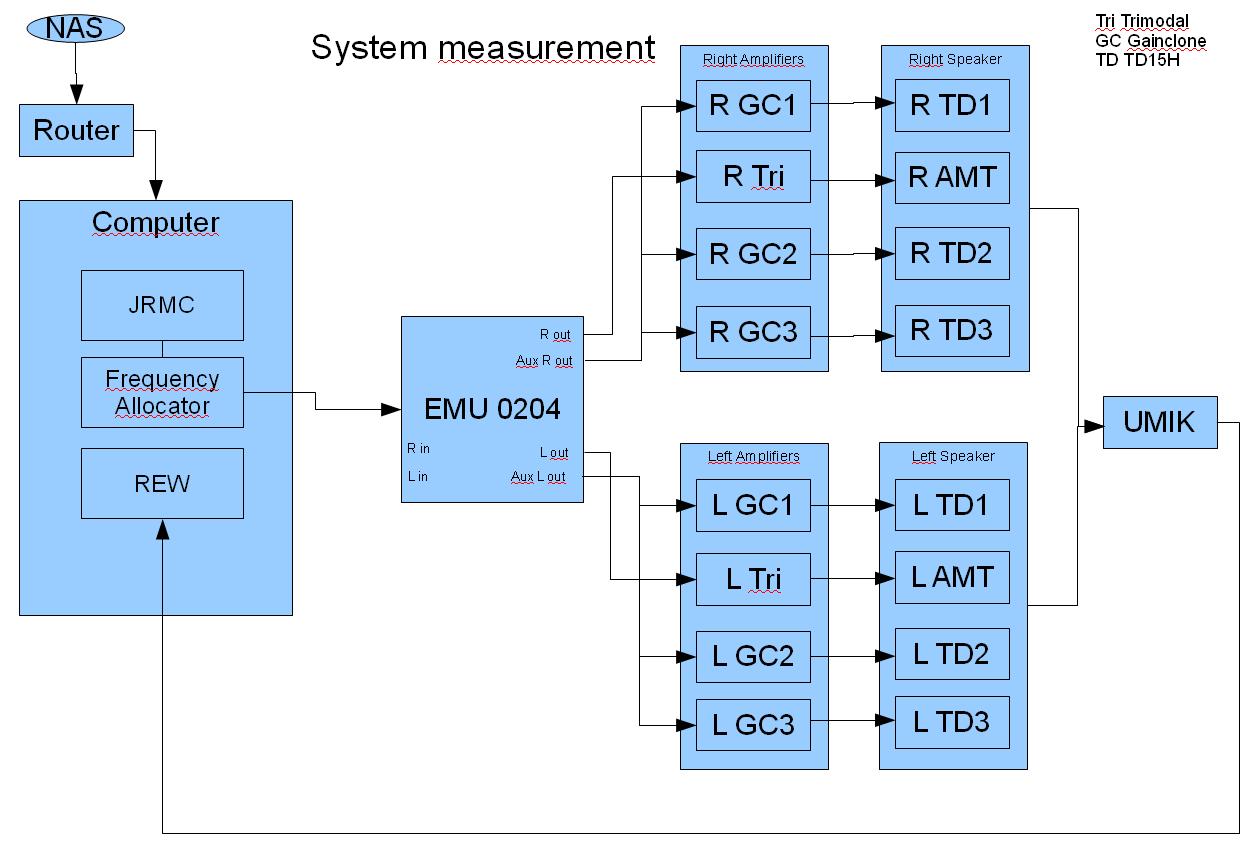

My setup is only PC with software, USB DAC, amplifier and loudspeaker.
The USB DAC has two ADC channels as well.

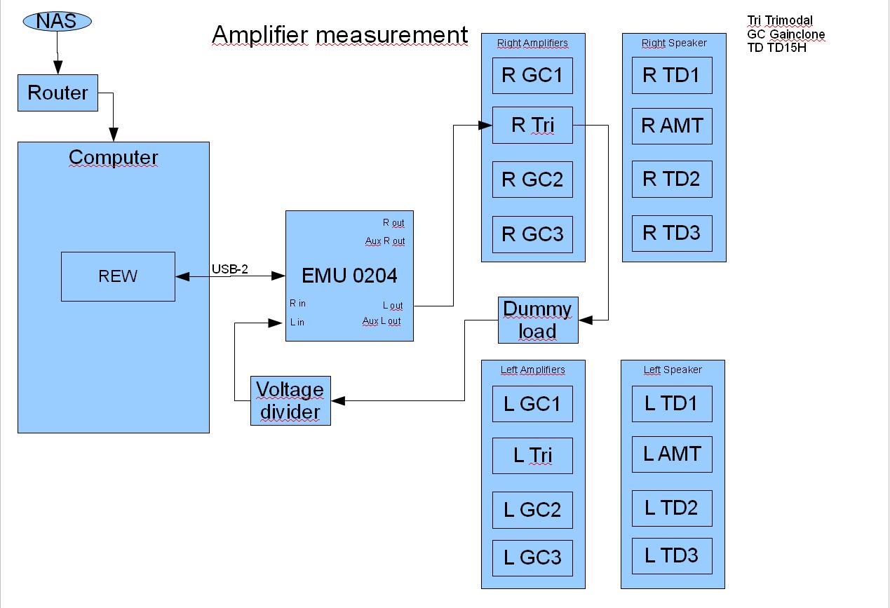

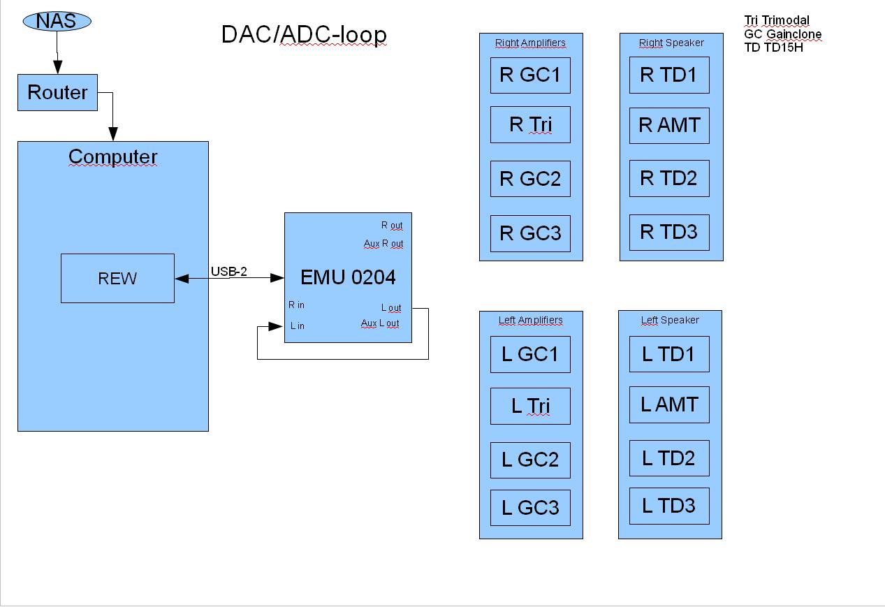

These are the different setups:
Listening:
DAC/ADC loop:
Amplifier measurements:
Loudspeaker measurements with WM61a:
Loudspeaker measurements with UMIK-1:
System measurements including crossover and PEQ:

DAC/ADC loop:

So I have started to use REW since Holm is not supporting Windows 10.
Good is that with the calibrated UMIK, I'll get all microphone measurements with the correct SPL!
Note that all distortion levels are in dBr, that is relative to the fundamental. Just like Holm did.
So you should not do any math, subtracting the levels.

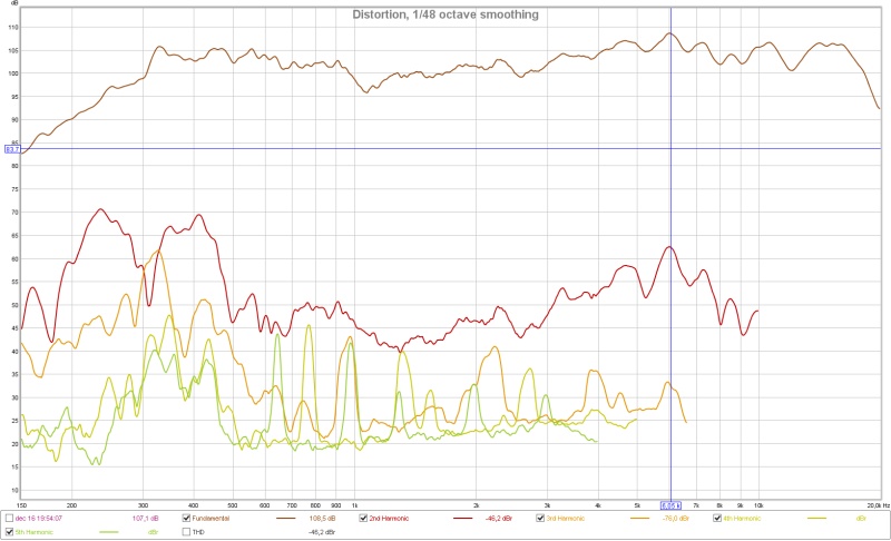

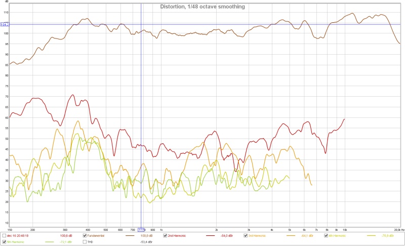

The first calibrated measurements using UMIK-1 together with REW for the membranes in post #562:
Left AMT:
Right AMT:
Pretty much the same levels as with Holm, but now I know that it is the actual SPL levels.
Note, again, that the distortion levels are in dBr, that is relative to the fundamental.
For instance, at 2,3 kHz for the Left AMT we have 103 dB SPL for 1 W at 50 cm, 2nd HD is -53,6 dBr, 3th HD is -64 dBr.
The SPL is within +7- 5 dB from 280 Hz to 18,74 kHz with a smaller dip at 1070 kHz.
The 2nd HD level is somewhat high at 6,0 kHz, but then the SPL has a dip at 12,0 kHz.

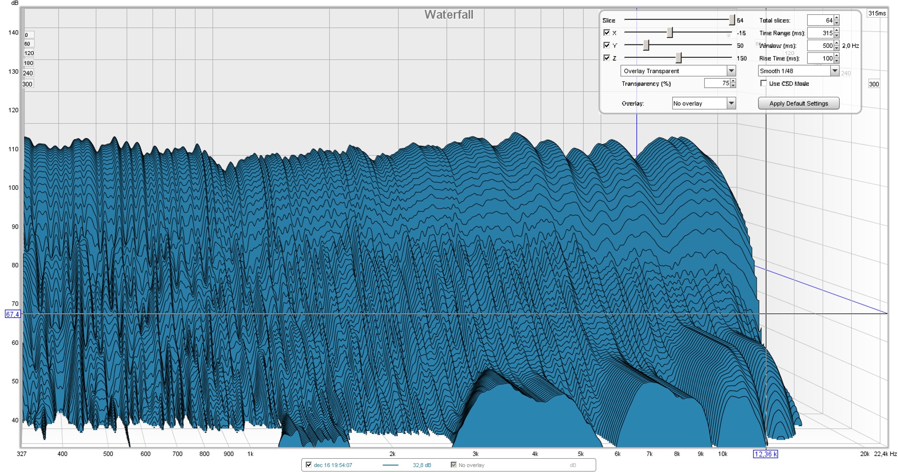

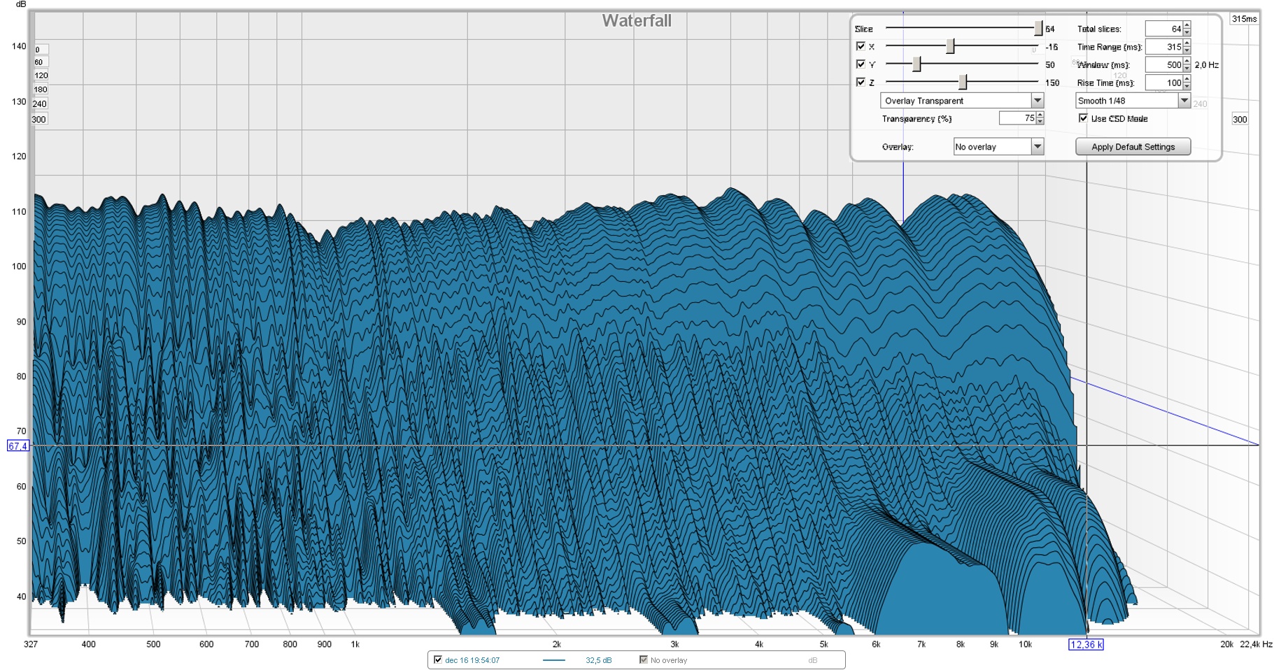

Need help with Water fall
I got Water fall generated from one of the 50 cm measurements above.
Without CSD:
With CSD:
How shall I interpret them?
Is there for example an induced vibration in some mechanics at 7 kHz or some multiple of its wavelength?
Without CSD:
With CSD:

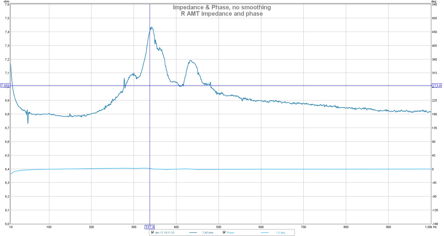

Impedance

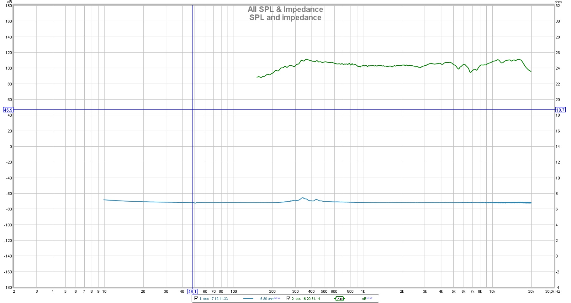

Also made an impedance measurement, first plot is a SPL and impedance overlay:
Second plot is a close up of the impedance around the resonance frequency:
Note that the phase was 0 degress across the whole spektrum.

Looking good. One idea could be to up the resolution drastically on the impedance measurement so that you can see any bump and wiggle as these represent some mechanical deficiency. This method has the good thing to leave a mic out of the process. Still, see to that you have silence and do it at night because the measured system will be one giant microphone 🙂
