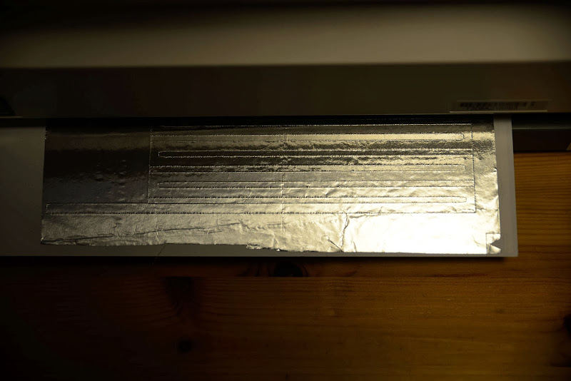

Have you tested the cutting machine on alu/paper?
If you think it is easyer to cut alu/mylar I can send you some 180mm wide.
Bernt Båndseii
You have made a lot of new stuf too.
Bernt Båndseii
Sorry, forgot my rhetoric skills
I´ve only done a first test to see if it can cut alu/paper at all.
And it can.
Problem is to get a good supporting material for the alu/paper as it is not rigid enough for the conveyer.
The cutting mat that was included was too sticky and I had a hard time removing the alu/paper.
The best way to do it is probably to have a heavier paper and spray adhesive on that and then glue the alu/paper with the paper down.
Do the cutting and then apply the mylar. Then the paper and the paper from the alu/paper has to be dissolved.
Perhaps it is better then to use the 7 um alu/paper as that paper comes off more easily just using water; you don´t need to peel it off manually as you would have to with the 10 um alu/paper from Vita.

Using the Silhouette Cameo to cut out AMT membranes
So I made a first layout by copying the design I already had:
Sprayed some remount on a A3 paper and attached the alu/paper on it and loaded it into the machine:
Told the machine to start cutting:
It took a while, perhaps three minutes, but it was done using a slow setting.
For sure it can be done faster.
Finished:
Finished:
