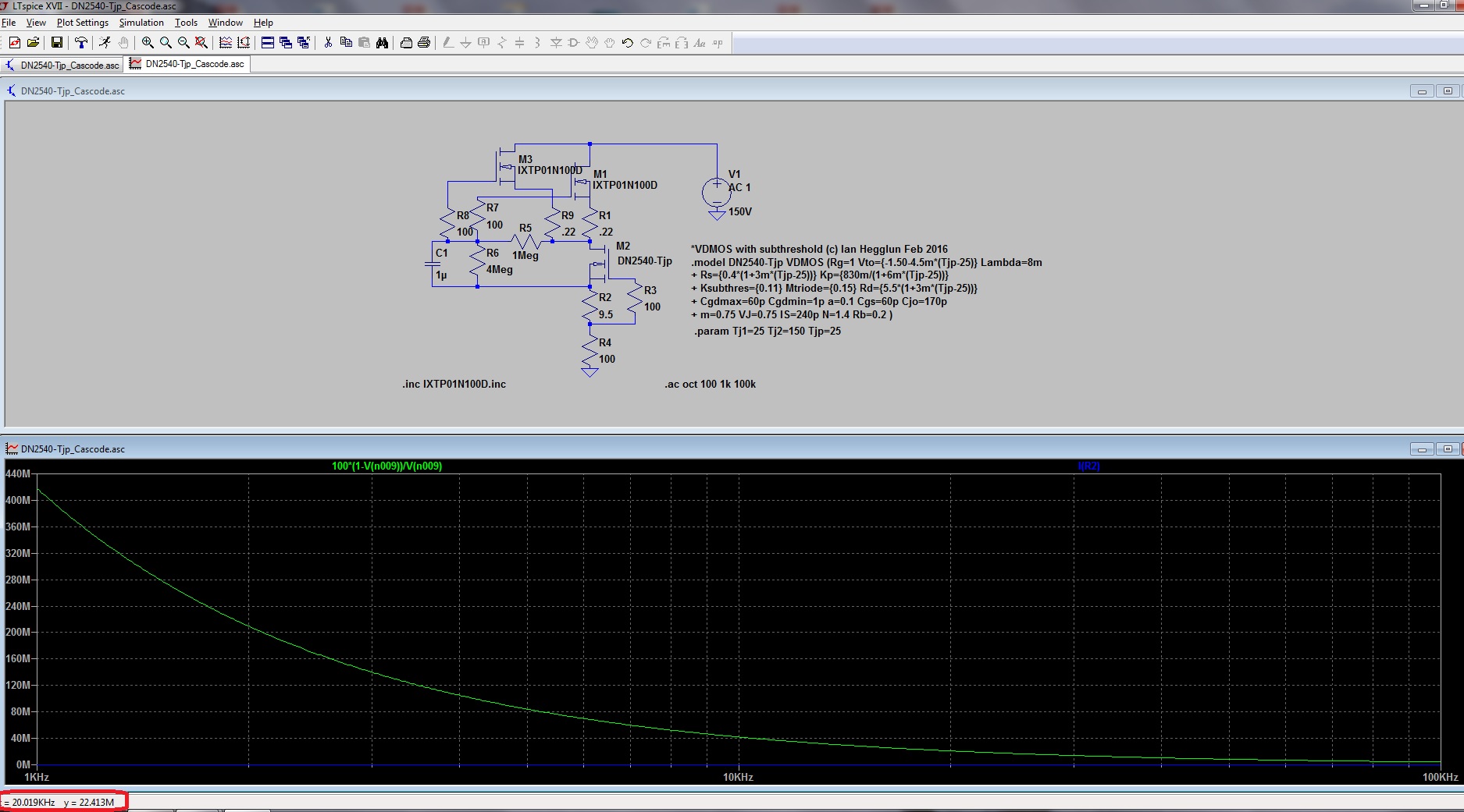

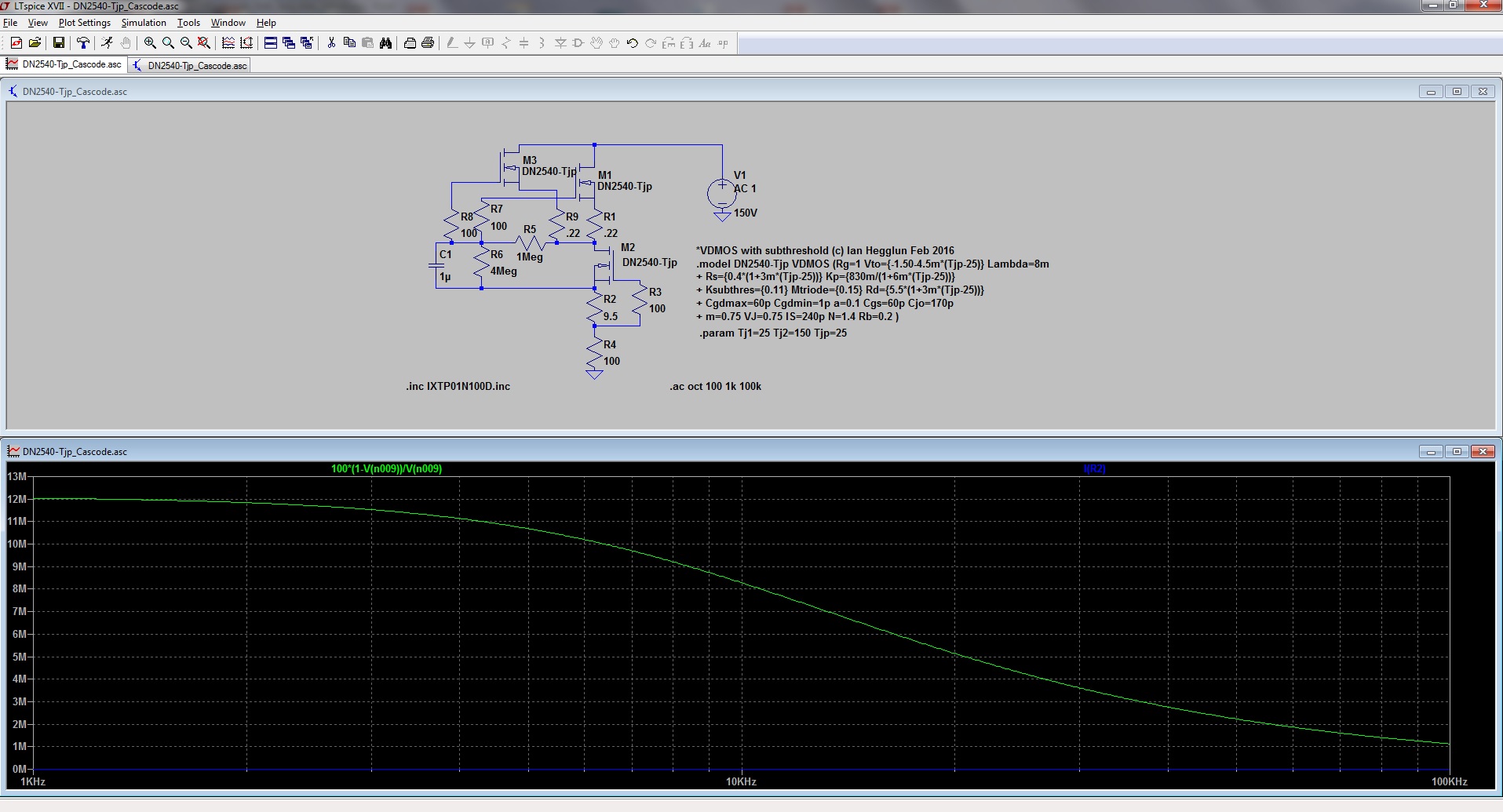

DN2540 cascode worsen significatively at 100mA
Yes, with that model performance even with the Walt Jung bias deteriorates after about 85mA.
However, you could still use two of these cascodes in parallel. At 50mA I am getting impedance of 15Meg for 20KHz.
Its probably too much of a bother, but maybe not? Do you need this for each channel? Also, the upper 'FET needs to dissipate over 7 Watts in such a cascode so keeping it cool will be a consideration.
Or maybe your last schematic will be easier to build...
ian

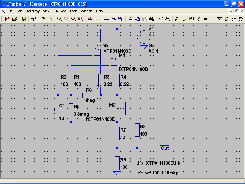

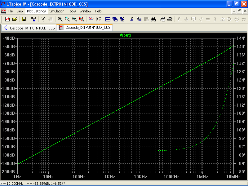

Hi Ian
What about this?

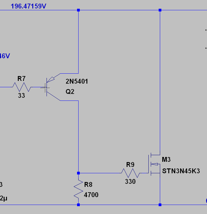

Hi Rod
Thanks again, you put things very easy to me with those approximations, from now I can calculate more things.
Due to the wrong mathematical model for NE5534, my opamp based shunt regulator is making water, and I cannot obtain a plain output impedance anymore.
As a final effort, can you please post a link to a PNP-N-channel compound output stage?
Here's the compound transistor.
You can feed it from a filtered zener stack, or even a gas-tube, and it will give very low output impedance.
Protect the FET gate with a 8.2-12V zener.
