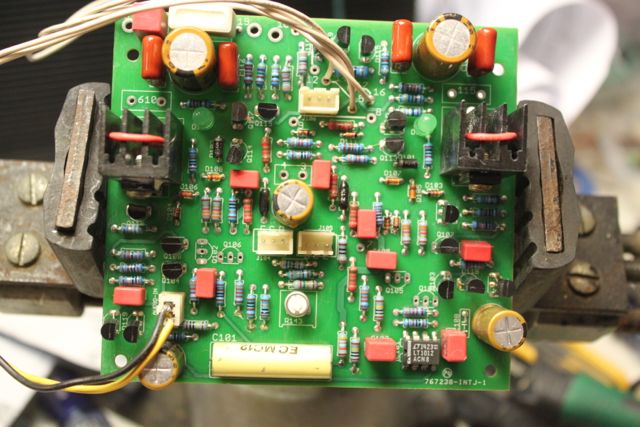

Stuffing the new board. About 70% complete.
Only issue I have found is that the holes for the heatsinks are mis-positioned slightly, so the heatsink sits about 1/16 inch back from the leads on the transistor. I could bend the leads, but then the heatsink interferes with the 5/11 and 6/10 lead connections.
So, I removed the pins from the heatsinks, and just have them held in place by the transistors themselves. Seems to work OK, and it puts the heatsinks in the right position. The amp isn't going to be under a lot of heavy vibration... so it should be durable that way.

Oops! Oh well.the holes for the heatsinks are mis-positioned slightly, so the heatsink sits about 1/16 inch back from the leads on the transistor. I could bend the leads, but then the heatsink interferes with the 5/11 and 6/10 lead connections.

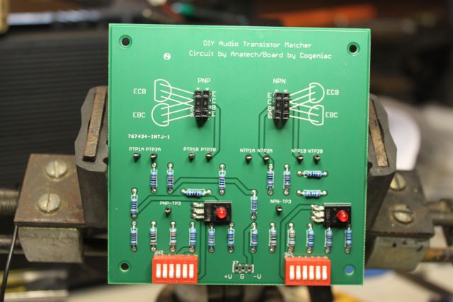

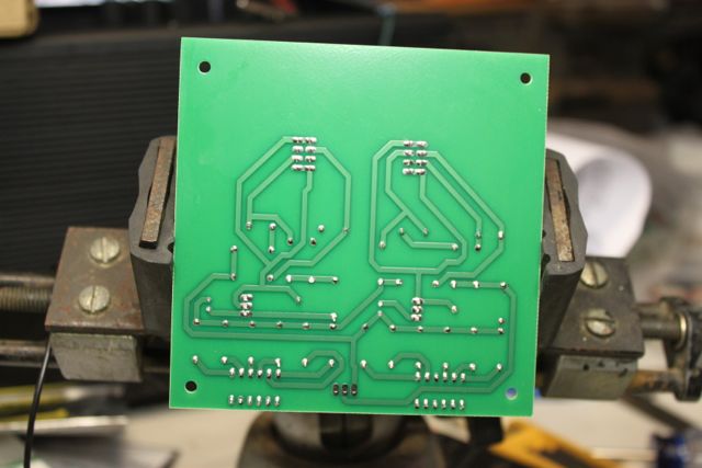

I am also mostly done with Version II of the 565 control board. I need to match some Darlingtons for it, and then it will be ready for some juice.
I'll keep you folks posted.
The sharp eye will note that C108 is "missing". It is actually on the back side in this iteration. The WIMA caps were a little fatter than I expected. I fixed this is in Version III.
Hi Scott,
That's a really nice board for both. You have a talent that I don't.
As for some components on the back of a PCB, I have done that from time to time to keep heat sensitive parts away from another hot component, or from rising heat. The rear of a PCB can be very useful for this type of thing. It's also a nice place for axial capacitors that are too large to lay out. Look how much room you gain by putting those on the rear of a PCB.
Let us know how they both work out. One question for you. Did you insulate the LED from ambient conditions with some foam, or not?
Best, Chris
Best, Chris
So far I have not insulated the LED or the transistor. Try as I might, I could not find an LED that actually fit in the TO126 hole. So the LED sits above the transistor, and I use a plastic cover over the board It seems to stabilize after about 30 seconds (much faster than my old breadboard setup!)
The only thing I would change is to put a ground test point lug on the board, and to label the test points so you know what they are in terms of the circuit (NTP1A isn't very informative...)
I am measuring about 0.2 micro amps of base current( 0.2 mV over 10K ohms), and about 1.25 mA of collector current, which computes out to a beta for the Darlington of about 60K..Does this seem right? That's a beta of about 250 for each junction, so it seems reasonable...
Board seems pretty stable and easy to use (other than the lack of a ground test point)> I'd suggest we include an Excel file with a test data sheet that computes offsets and overall match, as well as beta, and include some instructions for what data to take at what test points (basically a little procedure and a data sheet). To address potential offsets in the test board, I test the transistors using a matrix that ends up with each transistor in either position, so you test them one way, and test them the other way. The difference in the measurements then gets averaged out so you can back out any residual offset from the test jig. 2x the measurements, but 10X the accuracy.
I'll post the gerber files after I update the board.

Hi Scott,
The important thing is to tightly match the collector / Drain resistors and the base / gate resistors. I bought 0.1% resistors for those positions. The position of the transistor can't make any difference when you do it that way. Simplify your life if you didn't get that close in those resistors. The gain of the Darlington transistors don't matter at all. It's only important to balance the two in the jig, so hang your meter across the two 100 R resistors on the DUT sides. You want the lowest reading on the meter.
A 3mm red LED will fit in those holes just fine. The lower skirt will keep the diode from coming out as you solder it in. The pass transistor will sit off the board high enough for some closed cell foam in there. I used some pink foam that some parts are shipped in. Don't use the black stuff. I suspect that some kinds are slightly conductive and may disintegrate over some time.
If the 3mm LED won't fit in, file or sand the sides slightly so it fits snuggly. A little thermal compound will help the heat transfer. I forgot about that step. I used a drill press and a small modelers file to reduce the diameter of the LED. Just have a TO-126 transistor to fit the hole as you go. We want the transistor to heat the LED and there is a lot of heat loss through the LED leads. Also, the leads have projections so the LED will not go through the board all the way. This works for us in this case because a longer lead reduces heat loss that way.
For the sockets, use parts sold at Digikey, Mouser or Newark. The ones from China are terrible in that the leads don't fit well. They catch on the upper lip. Avoid. The capacitors exist to keep any DUTs from oscillating. The values are not critical. The resistors that set tail current don't have to be exact either. What works on one may not be right on another. The differences between pass transistors and LED voltage drops will direct affect the actual tail current. So don't fret if the values aren't bang on, and do feel free to change the values to suit. The only real desirable characteristic for the resistors is that they have a low temperature tempco. 50 ~ 100 ppm would be preferred. All you should care about is that the current is stable and somewhat close to the value they will be running at.

The tip of the 3 mm LED fits, but the body doesn't.
I ended up putting the transistors down, and then put the LEDs on top of them, holding them down to the board. That way the heat from the transistor will rise to the LED. I used a copper ground plane on the board, so it is all pretty thermally stable. I would think thermally insulating the devices would cause ether to drift independently, whereas making them all thermally connected would assure that everything drifts together.
I measured my resistors They are within 0.1%. This "should" result in an offset of less than 0.2 mV. However, I also tested two transistors in the two positions. In one position the collector voltage difference is -7.4 mV, and wight he devices swapped, it is +5.5 mV. This indicates that the actual match is very close.
To understand this we can make the following statements. We are seeking the collector differential voltage in a perfectly balanced jig. Let's call this Vc. We can call the differential voltage measured at the test points Vm, and we can assume that the circuit has an unknown fixed offset between the two legs at the current level being tested. Call this Vo. Now since we know that the collector differential voltage Vc will change polarity depending on which side of the jig each transistors is in. Put them in one way and you might measure, for example -7.4 mV, swap positions, and you measure 5.5 mV (these are actual numbers from my tests).
Now the fixed offset Vo of the jig doesn't change when we swap transistors around..So we can write out the following relations:
Vm1=Vo+Vc
VM2=Vo-Vc
Where Vm1 and Vm2 are the two different measurements taken wight he transistors in one position and the other.
We can, of course subtract these equations, and thereby eliminate the offset entirely. So we get:
Vm1-Vm2=2Vc, or Vc=1/2(Vm1-Vm2)
Using my numbers above, I get (5.5-(-7.4))/2=6.45 mV This is the actual collector match.
Knowing this, you can also go back and compute the jig offset, which in this case is 0.95mV
So, technically, having done this once, I suppose you could then just do the measurements on way, and correct them by 0.95 mV
