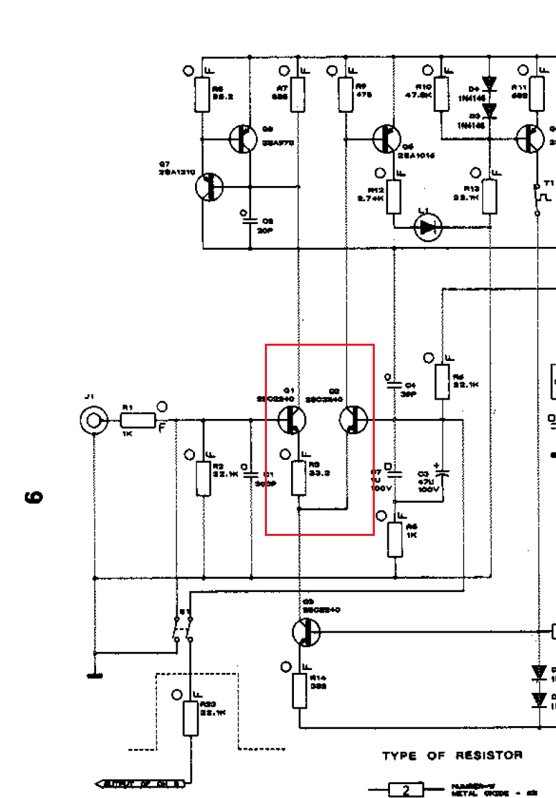

The schematic in the service manual shows something unorthodox: a deliberately mismatched long tail pair in the input stage. Check out R3= 33R2 , wowzers.

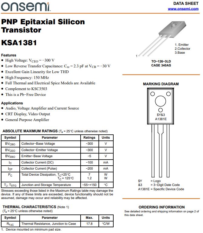

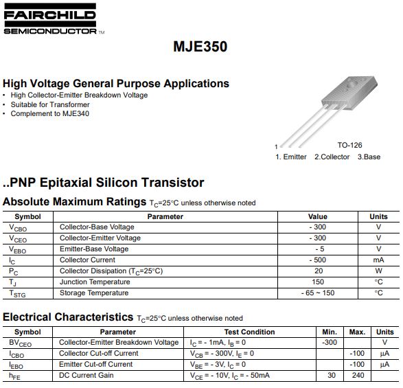

They will work. I have never used them to replace the *SC3503 and compliment.
Some important specs are not listed (I have them). Beta, Ft and capacitances.
MJE340/50 were the go-to VAS/predriver for +/-80V amps when the MPSU10/60 went Unobtainium and before “better” video output devices like C3503 and complements were available. Many low Cob linear video types of the day didn’t have a PNP. Good 340’s like ST run about 50 MHz fT. I’ve still got maybe 50 each of the old “SGS” labeled ones and they were the best of the bunch.
If it’s following that schematic posted earlier, C7 is a film type bypassing an electrolytic. The better the electrolytic, the less difference it will make to have it. With a modern Nichicon in that position I wouldn’t worry about C7.
Reactions: anatech
Yes. A bypass capacitor doesn't make much difference across a main filter capacitor. Local bypass is far more effective.
I used MPSW series parts for MPSU (42/92), I didn't have to try and use an MJE type. I simply have not had experience using them in this application.
It’s not the main filter cap, it’s the DC block in the feedback that C7 was going around. Often used to band aid pisspoor electrolytics. Might have been needed in 1982, but not today - at least not for ones you and I would use.
MPSW42’s are long gone now too. I tried to get them years ago and struck out, so I lifetime bought C3503/A1381 for critical application where sub 20 are pF Cob is a must and 625 mA TO-92s run too hot for comfort. The Toshiba TTA/C 230V drivers would be fine here as VAS. Better than what would have been used originally. Again, too light duty as actual drivers at these voltages/currents.
Ahh, okay. I didn't bother looking at the schematic. True, today's caps are much better. I don't think the bypass does much good anyway. The damage from dielectric absorption has been done. A little cap across the mess won't fix it.
I've been playing with Poly-Aluminum in that position. They aren't bad, a solid tantalum would be horrible. A wet slug tantalum is pretty darned good (but expensive!).
The MPSW were a 1 watt dissipation, same as the MPSU "uniwatt" case (still have a couple). C3503 and A1381 I have still. Differing pinout. I have used TO-126 in place of TO-5/39 cases, and sometimes MPSU. The problem with MPSU is the smaller pads you typically see, and pinout.
