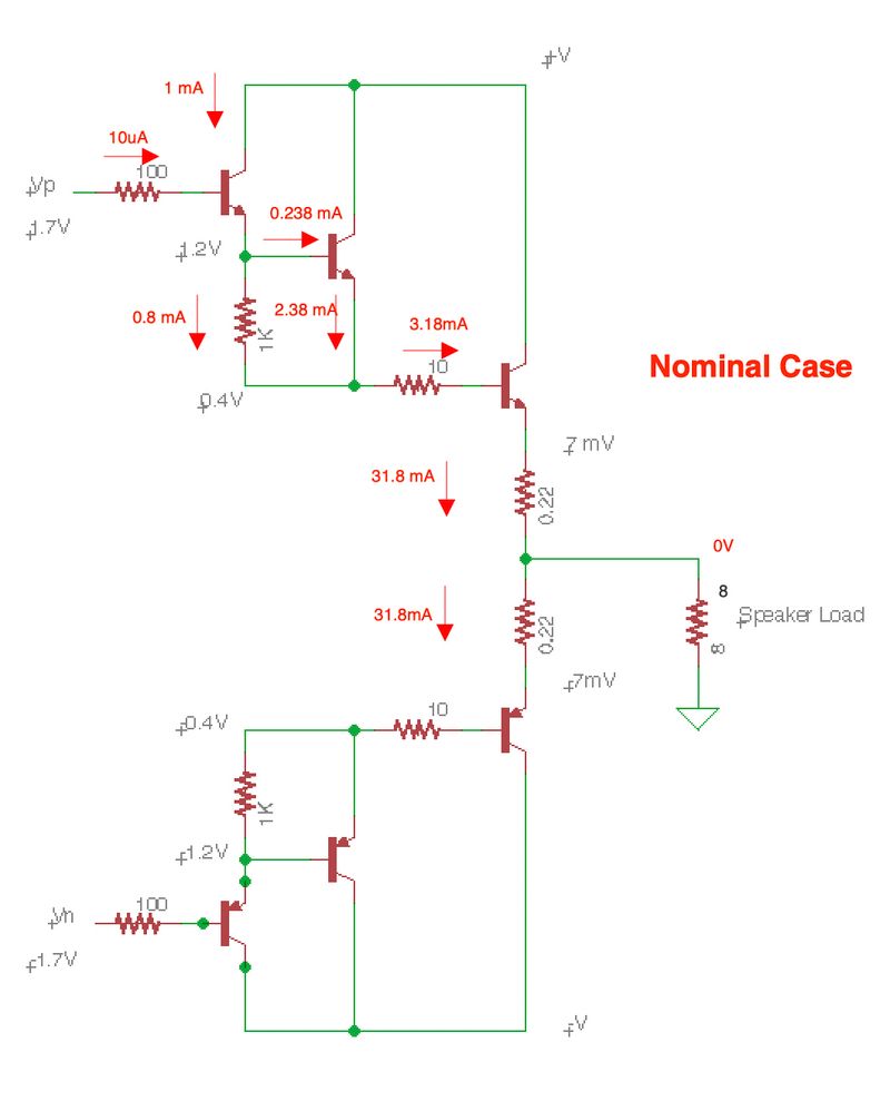

I guess I could wire in just one new pair of output devices for testing, instead of all the three pairs?

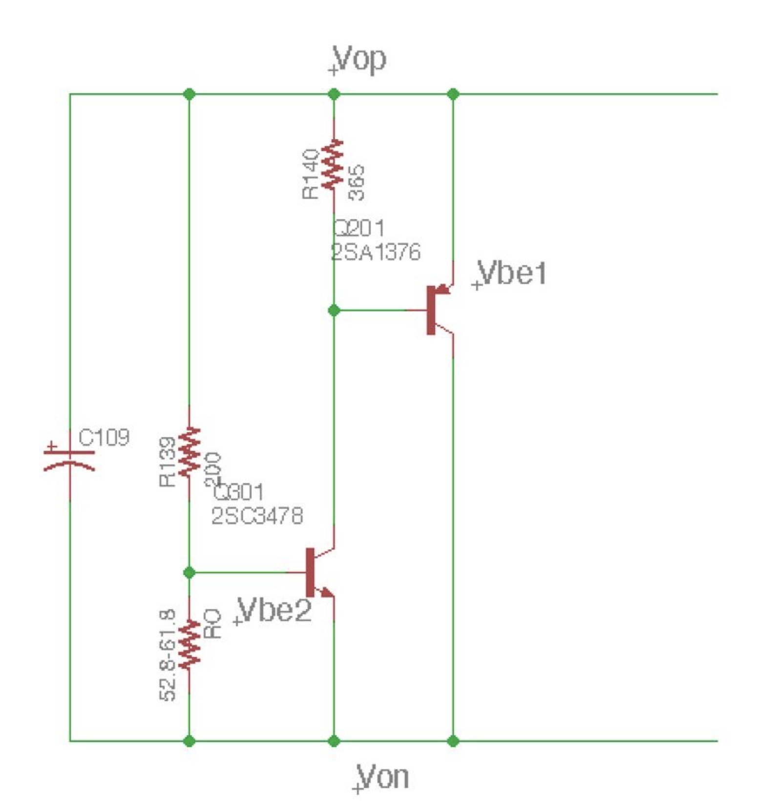

COGENIAC : The input signal will leak through the bias circuitry, but the positive and negative signal levels would be significantly different. The 4.7 uF cap is certainly a coupling cap.
Biases set the operating point for the transistor, and they should not waver, so there would be no reason to "smooth out" variations.
Yeah, I find that interesting. So they are using the Vbe change over temp to adjust the bias. What's odd here is that they only have a partial circuit for this. If you look at posts 381 and 382, I have the bias temp control for the 565. Here the Vbe of the transistors is used to drive the operating points down as the temp rises. Top is the positive bank input signal line, and Von is the negative bank input line. Q201 is on the positive bank heatsink, and Q301 is on the negative bank heatsink. The two transistor circuits are intertwined in an interesting way. Here is the schematic again, and I'll repeat the explanation with some added observations.
From this circuit, you can see that as the temperature of the junction of Q301 goes up, Vbe2 will go down, thereby increasing the current drawn through R139. The current through Ro will actually decrease, because the voltage across Ro (Vbe2) is lower, which means the base current of Q301 will increase. This will cause the collector current of Q301 yo increase, thereby increasing the current through Q201. This increased current will cause Vce of Q201 do decrease, which means Von and Vop will be pulled toward a virtual ground (i.e. each will be pulled toward the other). This lower offset will then reduce the current through the output Darlingtons, thereby lowering the temperature.
Similarly, if Vbe goes down (as the positive heatsink temp rises), the current through R140 will go own (because the drop across it is lower). However, the current the collector of Q301 is fixed by the other elements, and if they have not changed, this reduction in R140 current will increase the base current of Q201 and further pull the inputs lower.
As was noted by Phoodpants, in the 585 amp, they kept one of these transistors on the board, and only one was on a heatsink. I suspect they found that it didn't matter as long as ONE of them was on a heatsink, that temp will lower the bias in BOTH the positive and negative output banks. Thereby keeping them balanced and also reducing the overall current level.
This circuit is also supposedly used, however, to steer the bias between the positive and negative banks.
The resistor Ro in the diagram is actually a series combination of a fixed resisted and a pot, pretty much like VR601 and R643 in the 545 diagram. In this circuit, if Ro is decreased, then the current in the base of Q301 will decrease (because the current in Ro will increase). That decrease will reduce the collector current in Q301, which will cause base current in Q201 to decrease (because the Vbe of Q201 is fixed, and that means the portion of the Q301 collector current flowing through R140 must be fixed, and this means the reduction in Q201 current must be found by reducing the base current in Q201). This will cause Vop and Von to move away from one another (Vop becoming more positive and Von more negative). Moving the pot in the other direction will have the opposite effect.

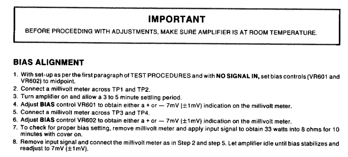

I find this interesting, since I had always thought the bias pot was used to steer the offset one way or the other, but it really looks like it just runs the biases up and down together, essentially controlling how much class-A conduction the amp has a zero input. I note that this is counter to what the manual says, so I may not be understanding the operation the pot properly.

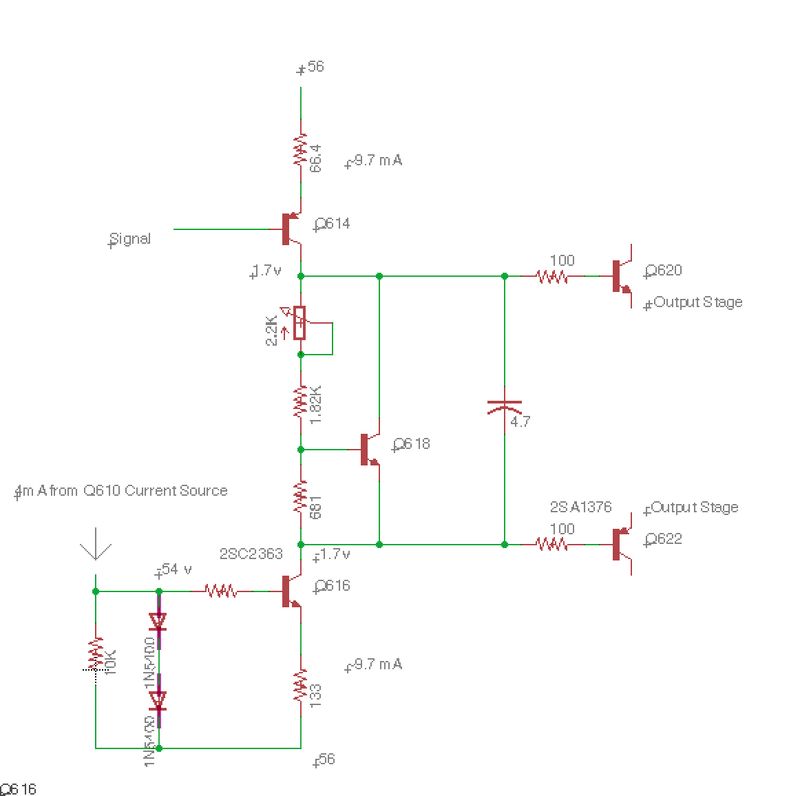

COGENIAC : Some additional thoughts on the bias control in the 545.
Based on the voltage drops across R636, and the series combination of R640 and R642, the current in the Q616 current source is about 6.7 mA.
The drop across R646 (681 ohms) is .7 volts, so the current through R646 is .7/681=1.02 mA. Since the current in VR601 and R644 is the sum of the base current in Q168 and the 1.02 mA flowing in R646, we can determine the nominal value of VR601 is about 827 Ohms. (odd that it is much bigger than 2x this. Might have just been what was available).
This means that in this nominal situation theQ618 transistor is passing about 5.7 mA.
If we decrease the resistance of VR601, then, in order to keep the 1.02 mA current flowing, the voltage at the collector of Q614 must increase. Since the current has not changed, the voltage on the current source is unchanged, so the voltage at the input of Q622 will not change. This means decreasing the resistance of VR601 will bias the positive side output bank more heavily.
If we increase the resistance of VR601, then the voltage at the collector of Q614 will need to go down to maintain the current flow through R646. So that will then cause the positive side output to be biased less heavily.
So far, we have assumed that the current in the base of Q618 is negligible. If we relax that constraint, I think what happens is that a reduction in the resistance of VR601 will slightly increase the base current of Q6128, thereby increasing the share of current that Q618 conducts. However, since the current source is fixed, it will respond by raising (less negative) the voltage at the collector of Q616. Thus, when VR601 is reduced, the positive output stage bias will increase, and the negative side will decrease. Similarly, if we increase VR601, the base current of Q618 will decrease, thereby reducing the collector current in Q618, and to maintain the proper constant current, the current source will reduce the voltage (more negative) at the collector of Q616. So decreasing the resistance of VR601 will bias the negative output side more heavily and reduce the bias on the positive side.
As the temperature of Q618 increases, its Vbe will decrease, reducing the current flow in R646, and thereby turning on Q618 more heavily. Since this transistor directly connects the two bias points, the reduced effective resistance between them will cause the current source to increase the voltage (less negative) at the output, and since VCE of Q616 will decrease, the current source will drag the positive side down. thus as Q618 heats up, the bias on both sides will go down.

COGENIAC : Seems like maybe it is not the actual output devices, but is the pre-driver. Q619 or Q621. If that device beta, and or Vbe change substantially with temperature, then as the amp warms up, the positive output will be driven less hard, and the output voltage could drift negative.
But check the voltages on the input resistors R647 and R649 (right channel) and R648 and R650 (left channel) first.
Seems like too much offset to attribute to VBE drift, since the output stage has unity voltage gain.

COGENIAC : Does the voltage swing only occur with the speaker connected? Or does it swing to -6 volts and then go back to near zero? If you turn it on with no speaker connected, then does the output stay near zero when you turn it on? (that is does it not swing too -6 volts at all?). After it has settled down, does it randomly swing negative again, or is the issue just at start up?
The offsets you measured are a bit puzzling. if the collector of Q614 (positive side of the amp) is higher than the collector of Q616 (the negative side of the amp) then I would expect that the offset would be positive, not negative. Double check the polarity of your volt meter.
The offsets at the collectors of Q614 and Q616 should be the same and opposite polarity. If the output offset is only at startup, then I suspect you are seeing the offset from those mismatched collector voltages and then the servo time constant catches up to the output and corrects it (that is, the servo may have a slow time constant - since you do not want it to react to the audio signal, and it may take a few seconds to react.).
Also, does Q618, or the heat sink itself, heat up?
Try this:
- If the pot changes as expected (maximum resistance of about 2 K Ohms and a minimum resistance of about zero), then remove and test Q618.
Q618 is supposed to change the bias on both sides up and down with temperature. However, if it is open, then this would probably mess up the balance. More likely though is that the pot is open/shorted or does not change its resistance properly.
If changing the trim pot changes the collector voltages (Q614/616) then adjust the pot until the voltages are equal and opposite polarity.
The other thing you could try is to disconnect Q618 entirely. In this case you will have a resistance of between 2500 ohms and 4700 ohms between the collectors of Q614 and Q616, and adjusting the trim pot should cause the voltages at the collectors to change in opposing directions.
-->What I am looking for here is if the bias offset control is working correctly (or is working at all).
Now, if the amp is stable and has zero offset without the servo, attach your volt meter to the speaker terminals, and connect a speaker to it, while it is powered on. if the voltage changes significantly, immediately disconnect the speaker.
-->What I am looking for here is if the presence of the speaker is causing the offset.
If connecting the speaker causes the otherwise zero offset to swing in one direction or another, then the issue is related to current flow (there is little current flow with no speaker connected.) You said that the output transistors were replaced with known good devices. Did that include Q620 and Q622?

I am still confused about labelling of the bias setting pot. It is supposed to set the class AB operating point, and as such should not affect the output offset. But here Adcom advises setting the bias so that it produces about 7mV across the output device emitter resistor. (I have attached the excerpt from the service manual.) But when that control affects the symmetry of the voltages at the collectors of Q614 and Q616, what does one aim for as the best option--symmetry of the +/- voltages, or the recommended bias current indicated by the 7mV level ??

Here is a simplified diagram of the output circuit, with the nominal currents and voltages noted. I would be interested to see what you are measuring both with the load connected and without.
Specifically:
# With no load, and the circuit balanced, what are the voltages across the 0.22 ohm emitter resistors on both sides? This will tell us what the quiescent current is.
# With no load, and the circuit balanced, what are the voltages at the collectors of Q614 and Q616?
This will tell us if you are compensating for some other offset causing source using VR602.
As noted in the diagram, the voltage drop on the emitter resistors should be about 7 mV, implying about 32 mA of current flow. If these are significantly different then this would probably be due to some imbalance in the overall currents flowing on either side.
I am not sure how the bias control is supposed to adjust the overall quiescent current. It clearly is designed to control the offset.
Specifically:

I am amused that the Adcom designer's labelling of the bias pot has flummoxed you also. Perhaps we shall explore that angle once the basic issues are solved. As I had stated at the outset, my wish is to disable the DC servo, set the offset manually and then enable the servo as a "belt and braces" arrangement. Once the amp behaves well (the present settling time of 2-3 seconds points to the servo correcting the output offset...?), we could perhaps take up exploring the setting of the offset manually. Then we would also need to find a way to set the quiescent bias too. Kindly keep that at the back of your mind.
