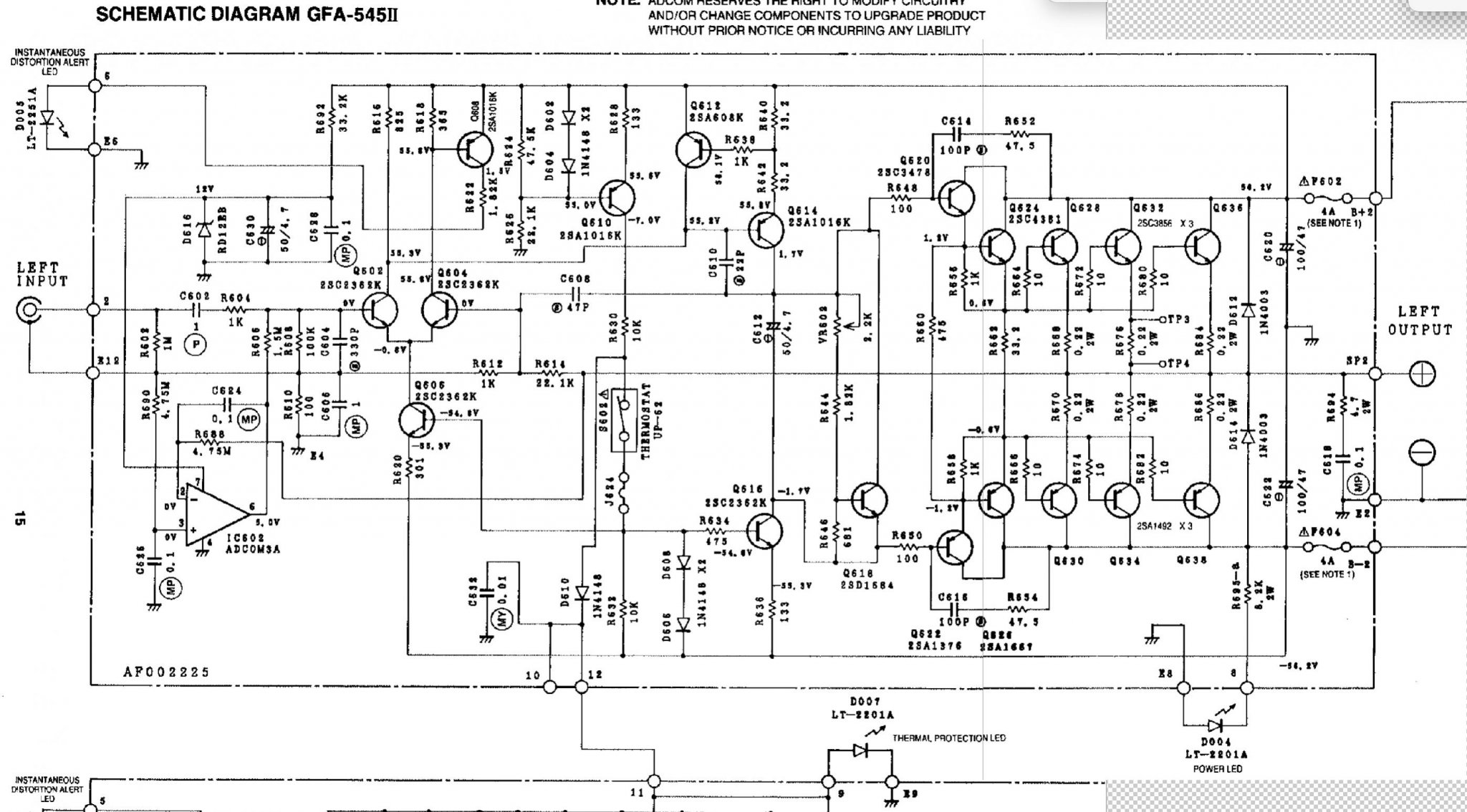

Many of us somewhat long in the tooth and who display our gray hairs with pride recall the fondness with which Adcom amplifiers were treated long back. Many of the early amps had the signature of master designer Mr Nelson Pass in their DNA and quite a few models were hot favourites with those who cared for good sound and the ability to drive a variety of speakers well. Recently, after a huge gap of decades, again Adcom gear is finding favour with many and I too acquired a GFA-545-II. Though in non-working condition, I was hopeful of restoring it as a lot of help was available online.
The usual cleaning up of the PCBs, replacement of the electrolytics, checking/replacement of critical components etc breathed new life into it. But the previous owner/service man had tried many things and the amp was not behaving normally. I acquired a copy of the service manual and set out to systematically restore the amp. Soon another 545, in a somewhat worse condition, was acquired with thoughts of cannibalizing stuff for the better of the two. This soon resulted in a working amplifier, but one that had some erratic behaviour.
I had noticed thread where seasoned and experienced Adcom masters were tackling issues with the GFA-565 and posted an SOS there. The resulting exchange is posted here as a new thread. I am also requesting the Admins to delete all the 545-related posts from the 565 thread to do away with the 'thread pollution'.
The posts started with Post #395 on Page 20 on the thread:
https://www.diyaudio.com/community/threads/yet-another-adcom-gfa-565-thread.286742/ :
In order to benefit others who might want to explore working with the GFA-545-II, I am re-posting the entire discussion here in an orderly (though slightly edited) form. Warm regards and much thanks to the masters for all the help.

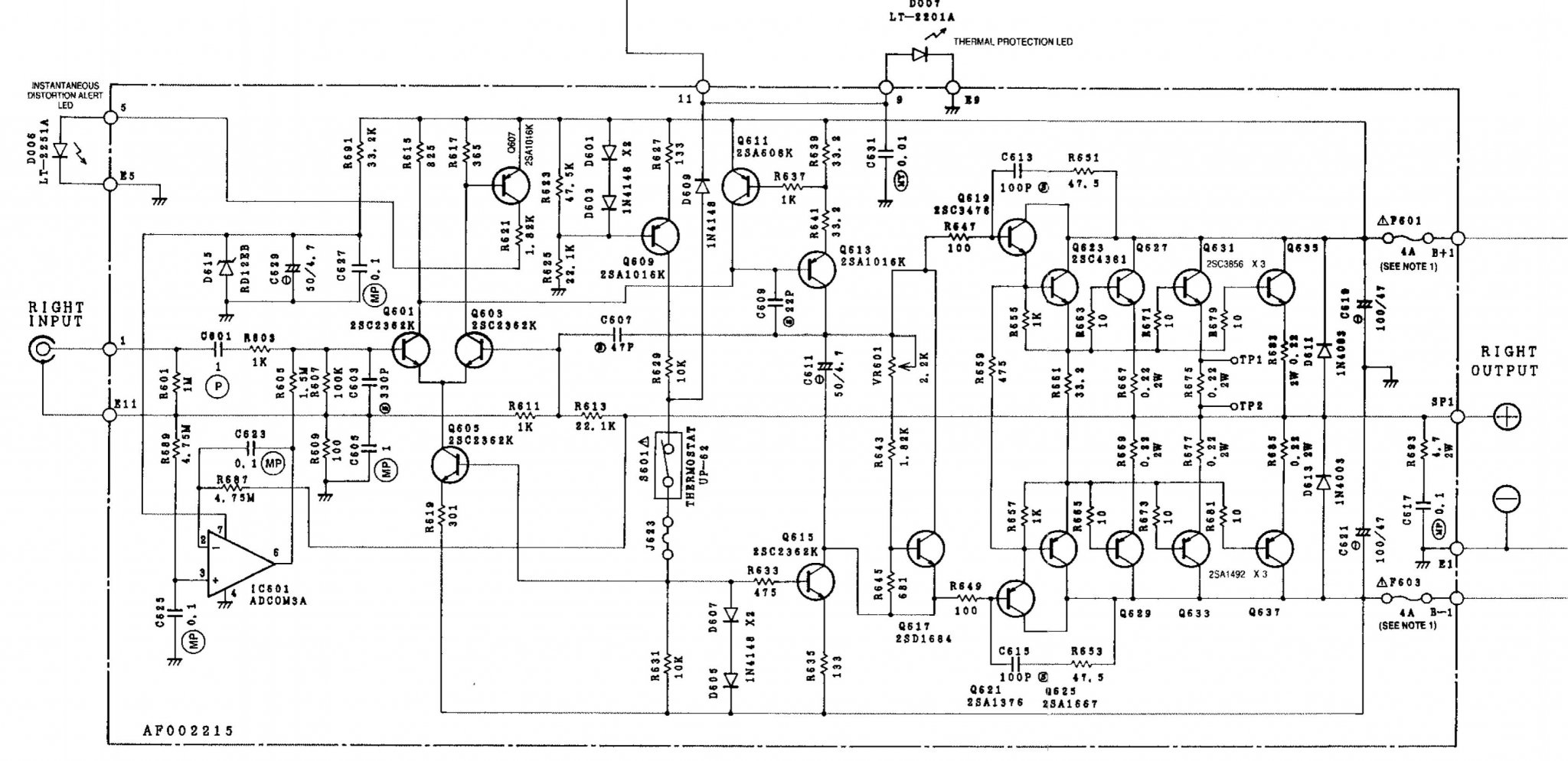

THE PROF: @cogeniac, Anatech and Phloodpants:
As an Adcom enthusiast, I have been following the thread assiduously for some time. From the early troubleshooting posts, I take it that it is probably best to remove the DC error amplifier IC, and then 'tweak/trim' the LTP so that DC balance is reached, and then restore the error amplifier IC so that a 'nudge' in the right direction will maintain DC balance and keep speaker-killing DC offsets at bay.
I am asking as I have a couple of GFA-545-II models that, over the years, showed erratic and high DC offsets. Replacing the LTP devices cured the issue, but I find that it is possible for the DC error amplifier to "lose grip" due to various factors.
I am banking on your vast experience and expertise to get some sane advice. Is it advisable to replace R616 with a 1k preset and trim the DC balance with the error amplifier IC removed? If not, what should be my approach to trim the DC offset to within the correction range of the error amplifier IC? Kindly help.

COGENIAC: Any offsets in the circuit are not a result of diff pair matching. The are a result of the bias circuits over on the right side. I would expect that, since that is all way after any real high voltage gain circuits, your high offset issues may be more to do with some other issues relative to Q614 and Q618.
THE PROF : Yes, I appreciate your idea that adjustability of the tail currents to fine tune the balance is probably the best. I get that regarding your mods to the GFA-565. For me the important thing is the ability to tweak the 'raw' DC balance first, and then activate the servo.
Kindly suggest a way so that I could do that with the simpler circuit of the GFA-545-II. I would definitely like to have a way to null out the imbalances first--with your expert help!
The outputs happen to be triple Darlingtons, which magnifies the errors much!
I have checked the following stage devices and they seem to be working okay, hence my quest for ways to tweak the LTP slightly. Is it advisable to put a trimmer between the emitters, with the wiper going to Q606? Do wise me up, please.

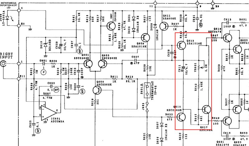

COGENIAC : This is just a hunch, and I do not have the time to spend fully understanding this new circuit, but it looks like the input diff pair is driven by a current source formed by Q606. The base current is set by the two diodes D606 and D608. The actually current is set by resistor R620. I can see why this circuit woudl have a hard time balancing, since it depends almost entirely on some complicated relationship between R161, 618 and 620. If you increase the tail current flow, by reducing R620, then the DC voltage at the collector of Q602 will go down. If your reduce it, the voltage will go up. So, if you are inclined to install a control element to adjust the nominal offset, then adjusting R620 MAY be one approach.
However, I stand by my observation above, that the amplifier is basically single-ended up to Q614 and Q168, so I suspect even changing the bias point of the diff pair may not affect much.
The current balance between the diff pair is not going to affect the DC offset. The triple Darlington is a current amplifier, but it will not actually affect the DC offset unless a device is shorted.
This amplifier appears to be Class A (single ended) up to Q614/Q618. After that some how is changes over to Class B, where one end is driven one way and the other the other way, and getting that balance right is the key, both to DC offset and to crossover distortion.

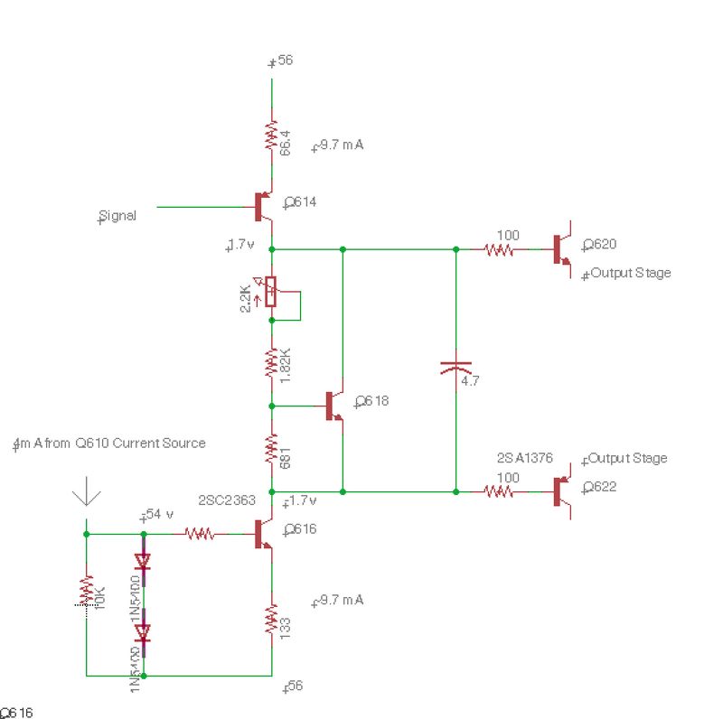

COGENIAC : Might help to explain, as much as I understand it, the circuit as it is shown. The differential input pair is a bit like an op amp. The input signal comes in the bas of Q602. Q604 is the non-inverting input. It appears it is there to provide some feedback. The gain of this circuit is roughly set by R616 (which is why a pot there would be bad). The amplified signal comes from the collector of Q602, and goes to the base of Q614. From there it goes out through R648 to some more of the output driver stage (off the schematic). That same signal ALSO goes through capacitor C612, and from there looks like it goes to R650 and off to the negative driver side.
So, up to the output of Q614, there is no positive and negative circuit path, there's only one circuit path. Whatever the bias circuits are for the two transistors (I suspect a 2SC3478 and 2SA1376) is what is going to determine the DC offset. This MAY be affected by the collector voltage at Q614, which may also be affected by Q618 and the circuit with the VR602 pot.
The good news, as I stated earlier, is that unlike the 565, you do not have tons of voltage gain taking small input offsets and amplifying them. The bad news is that this circuit is inherently not very balanced, and so the output stage bias will depend on the bias points of Q164 and the following stages.

THE PROF : I have put in a pair of C1845s for the LTP, and would like to tweak whatever imbalances there are as a result of the not very close match of the devices. The moment I disable the DC servo, DC balance swings one way consistently. It is this issue that I wish to address-- a way to bring the DC offset closer to zero first, before activating the servo again. Like I asked earlier, is a trimmer between the emitters of the LTP going to help here?
ANATECH : Hi The Prof,
Please read my post above.
The diff pair is designed out of balance, the DC servo is required. This is a weak point and it should not have been designed that way.
THE PROF : @ Anatech:
Sir, can you suggest a way to mod the circuit minimally to make the circuit balance somewhat?

COGENIAC : The interesting difference between the 545 and the 565 is that , since the 565 is full differential Class AB, from start to finish, each side (positive and negative) operates independently. So, introducing a small DC offset to the virtual ground between the positive and negative diff pairs allows control of the overall offset.
The 545 is somewhat different. The bias points of the output stages are interdependent, and may vary according to any of the components in the signal chain.
I suggest trying the R620 pot idea. That will allow you to shift the bias point of Q602 up and down, and that should propagate all the way through to the output stages. Try using a POT for R620. You can use that to turn the bias up or down on Q602, and that will shift the DC voltage at the collector. That shift will propagate through the entire signal path, and should allow you to adjust any offset.

THE PROF : ... I could do with a bit of "hand-holding" from the "circuit surgeons" here... my LTP devices match is not close...all I wish to do is to tweak it manually and leave it there...
COGENIAC : My suggestion for this was to adjust the bias on the LTP so as to move the collector of the LTP output up or down slightly.
From what I can tell, the 545 basically uses the output DC bias of each previous stage to set the bias of each subsequent stage (together with other components.)
The single ended signal finally gets split through an inverting unity gain stage and applied to the output stages. If the DC level of the two signals feeding each side of the Class B output stages is off, then the outputs will reflect that with a DC offset. I think the VR602 POT in the circuit is supposed to control that.
THE PROF : VR602 sets the quiescent bias for the output devices (according to the service manual).
I shall try trimming the LTP tail resistor as you had suggested earlier.

COGENIAC : The DC offset in the 545 arises because the input DC levels at Q619 and Q621 are incorrect. If one is higher than the other you will get crossover distortion AND a DC offset. If they are both too low, too will get crossover distortion, but no offset, and if both are too high, then you will have some Class AB operation (not a bad thing), but too much that and the amp will just be dissipating power as heat and cooking the output stage, since both the positive and negative sections will conduct at the same time.
The match of the input transistors (the LTP) is irrelevant to the offset in the 545. it is critical to the small signal performance of the amp, but it is not apparent that it can cause DC offset. So, if your concern is offset, then forget about the LTP. (but once the amp is working, don't forget to match them, or it may sound like crap).
It appears that Q605 and Q 615 are current sources, stabilized by diodes D105 and D107.
After the circuit involving Q617 (ending at R647 and R 649), the circuit is entirely complimentary (symmetrical for positive and negative sides), so any imbalance between them must be introduced at the point where the single ended signal splits to drive the complimentary output stages.
That split occurs at the collector of Q613. One branch goes to Q619, and the other goes to Q617 (I do not yet understand why Q617 is an emitter follower, since we need some sort of phase inversion at this stage to drive the negative side). I suppose if the input signal swings full positive and then full negative, one side will just go to zero while the other turns on, but man, that's a crappy approach...destined for crossover distortion...
Anyway, it really looks like the trim pot VR601 is there to adjust the bias between the two output sides.
Have you tried adjusting that? Do you know if it is actually working?
If the pot is shot, then you will maybe get some negative cycle swing, but it will be distorted. If Q617 is shot, then you may get some leakage signal through the pot and R643 to drive Q621, but again it will not be the same level as the positive cycle.
Try measuring the voltages at the input side of Q619 and Q621. They should be near zero, and if there is any voltage they should be the same and opposite polarity.
It is important to note that up to the output collector of Q613, there is only one signal path, so there're is no opportunity for any imbalance there. Once that signal path splits, them difference can arise that will result in DC offsets.
Here is the relevant section of the circuit:

COGENIAC : I spent some time today noodling over the bias control circuit of the 545 amp.
Adcom has a tendency to draw their diagrams rather badly, especially right where the input stage meets the output stage (remember in the 565, this is where that messy bias control circuit is).
Here is the bias circuit of the 545 redrawn. As you can see, the capacitor C611 just passes the signal through from Q614 to Q622, while shielding Q622 from the bias point of Q620 (the collector of Q614).
Q616 is a current source who's current is set by the two diodes in the base circuit. It appears that the current here is about 9.7 mA.
The real party occurs with the little trio of resistors (two resistors and a pot) and Q618.
Because the base emitter voltage of Q618 is always 0.7 volts (nominally), the current through the 681 Ohm resistor (R646) is always about 1 mA. Assuming the base current in Q618 is negligible, this means that the current in the resistor stack is also always about 1 mA. And this means that as the value of the pot changes, the voltage drop across the stack will change. So, when the pot is at zero, the drop across the resistor stack will be .001(1820+681)=2.5 volts, and when the pot is at max, the drop will be .001(2200+1820+681)=4.7 volts.
It also means that the current in Q618 is always fixed as well. Since the voltage drop across R646 (the 681 ohm resistor is the same, and the current through Q618 is constant, that means that the base current in Q618 is also constant, even if the resistance of the pot changes. to accommodate that, the voltage at the collector of Q614 must change as the pot resistance changes. And as the overall equivalent resistance of the resistor stack and Q618 change, the voltage at the collector of Q616 must also change (to keep the current constant).
Exactly how they change is not completely clear to me because the current flow through Q618 and the resistor stack are interdependent.
in a correctly balanced circuit, the input to R648 and R650 should be 1.7 and -1.7 volts respectively. If that is not the case, then the problem is upstream.
Two points:
1) my experience with previous owners is that many of them just fart around trying stuff and in the process end up making things worse. My first 565 had all manner of weird "fixes" that I had to undo before I could even start to get a handle on what was wrong with the amp. So, putting it back to original is a good place to start. Check for leaking electrolytic caps, cold slider joints, fried traces, burnt resistors, etc. I use a nice LED magnifying lamp to inspect the boards and the parts.
2) Caps C611/C612 are not bypass or filter caps, they are coupling caps. they pass the audio signal from one circuit to another while shielding the two circuits from their different DC bias points. If one of them is leaking (as in it has some finite resistance at DC), that will throw off the bias circuit. Probably unlikely, but something to check by lifting one lead and testing its resistance.
Two points:
