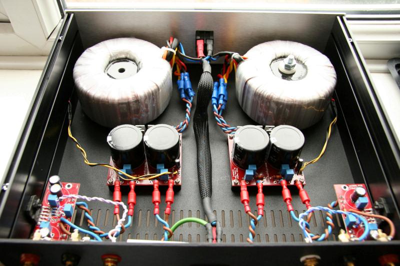

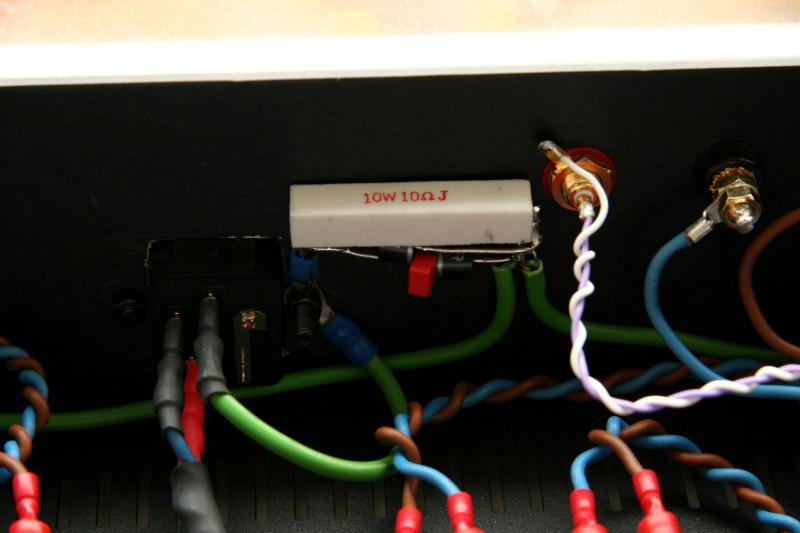

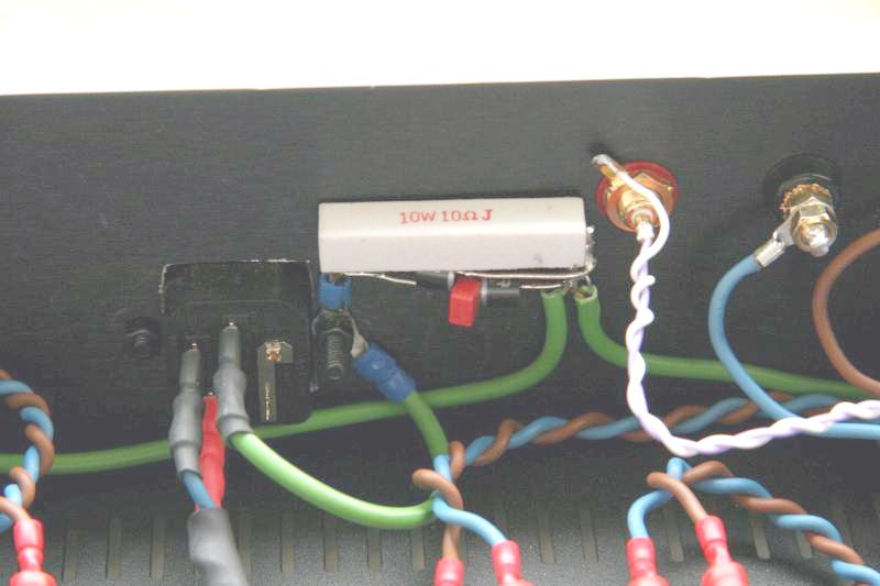

Hi Ian,
thanks to Keltic I can see that you have the safety earth and the disconnecting network both attached under the same securing nut.
I would recommend that you first fix the safety earth under it's own nut. and maybe even double nut it to remind you to NEVER take it off.
Then attach the disconnecting network with it's own fixing nut.
This way if you or a maintenance technician start to experiment with the audio ground the chassis remains safe. Remember the rule :- the safety earth MUST be PERMANENTLY fixed to all exposed conductive parts. We cannot easily weld (NOT soldered), so bolted is the next best solution.

Hi Andrew,
As much as it would be fun to potentially destroy a lot of hard work, I think I might give the live mains test a miss. If I had some spare parts I might be tempted, but as it is the only parts i have are in the box now and installed in the hifi rack, all neatly wired up and sounding great!
By the way, they are 6A diodes, so hardly small!
Keltic, thanks for brightening the picture.
I am using paralleled 35A power diodes (70A cf 6A). Hoping they will withstand a short term transient current up near 1000Apk.
Maybe I will just pluck up the courage to live test my audio to safety earth network.
If I were you, I would do a bench test with some spare components, unless you really want to risk killing your amp.

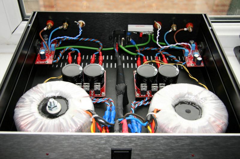

well I tested it.AndrewT said:Hi,
Maybe I will just pluck up the courage to live test my audio to safety earth network.![]()
Wired an IEC input socket/filter with the disconnecting network across Live to Neutral.
This is a double switched and double fused IEC socket, with both poles fused.
Put a T6.3A in the neutral line and T4A in the live line.
35A bridge cross coupled to run the diodes in parallel
10r 5W across one pair of terminals, 100nF ceramic across another pair and 12r 600mW metal film across the third pair (low inductance bypass). Earthing (Grounding) Your Hi-Fi - Tricks and Techniques fig3.
Switched on at the wall socket with the IEC switch off. Nothing.
Switched on with the IEC socket in the ON position.
Besides the bright white flash and the enormous bang that sent the fuse holder shooting across the room, not much else happened. All the disconnecting network components are intact, no heating, no discoloration and all measure correctly.
Surprisingly the T4A fuse survived, the IEC socket has some burnt terminals around the fuse locations. The T6.3A fuse has gone, except for one end cap still in it's holder. Everything inside the fuse compartment is blackened. No idea what it did to the RF attenuator parts??
Seems that the 35A bridge version of the disconnecting circuit can survive a close rated fuse (T4A) for upto 1kVA transformer on 240Vac

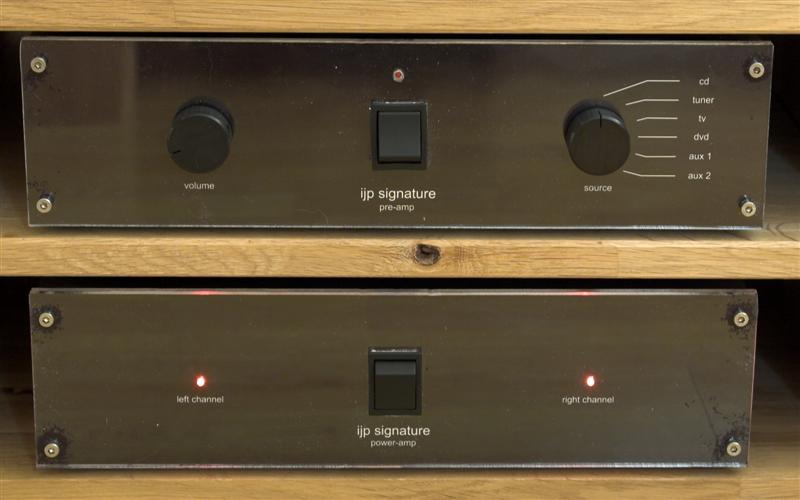

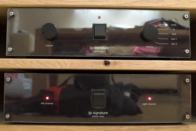

Update
I got round to replacing the front on my chipamp and my preamp, as they didn't really fit in with the rest of my gear with the silver fronts and also I had used pencil to indicate what the knobs were for on my pre-amp... classy eh? 😀
Anyway, I decided to borrow an idea I had seen used for some speaker lables by someone on this site and use two sheets of perspex with a printed lable sandwiched between them to give the results I was after and here they are!
