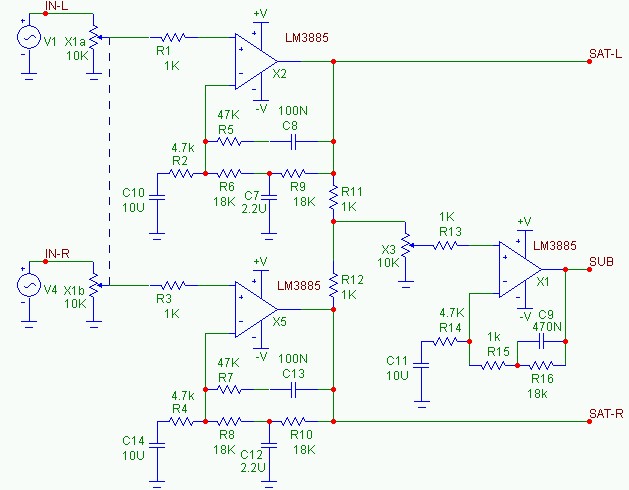

I made a 2 + 1 config with a few trick, Just completed in on wired board and sound is beastley. I added bass eq on the two satellite speakers that would give lift to compensate roll off. Then I combined the Left and right into a sub-woofer driver with a simple low pass in the feed-back line. I took lotsa trouble to ensure that the phese between sub and atellite is not screwed up.
I get good solid thumping bass wit fast attach and smooth transision to mid/bass - very nice, is pleased. I only need master volume and sub gain to control my every pleasure.
Circuit here:
Circuit here:
Curves show it all. Satellite has slight increase in low-end. Green trace. Bass has heavier gain in the low end to compensate for loudspeaker roll-off, and black curve shows overall system performance - loud with well controlled solid bass, not boomy or like a wet fart. It does not shake the house, but it moves your hart and make your foot tap the been involentary
