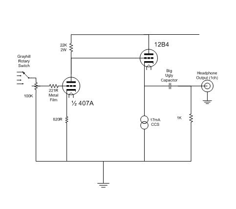

arnoldc said:I've modified my 12B4 pre according to the suggestions of Frank and what I hear was a bit more openess in sound with a touch more detail (lack of coloration from first cap?)
So far, this 12B4 beats my stock Foreplay preamp and as most have noted, this preamp gives out somewhat more natural sound with very very good detail.
Compared to my 407A preamp, the 12B4 lose out a little bit in bass depth and top end extension. But I am not complaining as the 12B4 has its own excellent sonic merits.

steve and lawbadman,
re: B+ for 12B4- in my breadboard it is 200V and that is where I made my comments on. the final version's B+ should be bumped to 250V but right now I already like what I hear
re: 407A schema - i played with it using TubeCAD and then "tuned by ear" so don't expect much 😀 i'll post the schema when I get it done on Visio.
