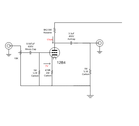

Another 12B4 preamp born
This is my prototype 12B4 preamp, which currently uses General Electric 12B4A. I like what I hear so far!
Power supply not optimized yet though as I only have 200V B+ and the tubes are running at a low 17mA.
I used whatever parts I have in my bin and this is the current schematic.
I should be able to modify it to CCS on the cathode as Brian did, but I'll enjoy the sound first.

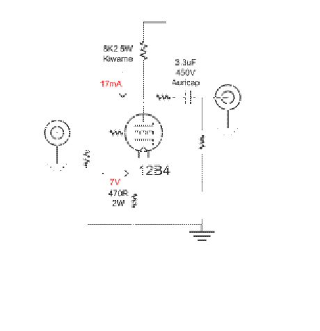

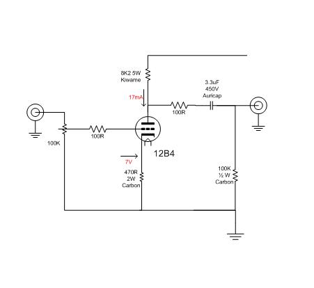

Some simple mods to give better dynamic range and slightly better SNR.
Cheers, 😉
I would however, retain my standby switch.
Put a mute switch at the output instead.
Cheers, 😉

hi,
what is the purpose of the 100ohm resistor between the plate and the output cap? also, why use 100k on the output as opposed to, say, 1M? i thought using a higher value would allow use of a smaller cap, which was favorable.

I've modified my 12B4 pre according to the suggestions of Frank and what I hear was a bit more openess in sound with a touch more detail (lack of coloration from first cap?)
So far, this 12B4 beats my stock Foreplay preamp and as most have noted, this preamp gives out somewhat more natural sound with very very good detail.
Compared to my 407A preamp, the 12B4 lose out a little bit in bass depth and top end extension. But I am not complaining as the 12B4 has its own excellent sonic merits.

If it was the same brand of cap I seriously doubt that you'd hear its ommission .
What you're describing is due to the added gridstopper (more detail), the output R tames a mild overshoot (way above what's commonly believed being the audio band BTW) and the 100K pulldown resistor forces more constant current draw.
The latter brings you better dynamic range, audibly so in most cases.
Hard to beat a 407 but I'm convinced that you can come very close with the right PS using such a pedestrian TV tube like the 12B4A.😉
Ciao, 😎
Thank yo fro trying out the suggestions, Arnold.
