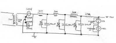

Do you mind sharing the schematic of this PS with us? 😉
Regards
Sure, but I need to draw up the schematic as it currently stands. I will try to do so this evening...
Briefly, it is a hammond 175VCT Transformer, with each leg of the secondary feeding a 12AX4 damper diode. There are two schotcky rectifiers off the plates of the 12AX4, forming a tube hybrid rectifier. The B+ is filtered through LCLCLC where all chokes are 20H Hammonds. The first cap is a 50uF unylytic (only b/c I ran out of real estate), the second is a 50uF ASC motor run, and the final is a 60uF ASC motor run. From the third cap I use an appropriate dropping resistor to series connected OA2 and OB3 VR tubes to ground, each bypassed with very small ASC cap, which regulates B+ at 190V. This feeds a Pimm self biased CCS which in turn feeds the plates. The amp is complete dual mono.
Sorry if this is more confusing than helpful. I'll get the scheme up tonight...

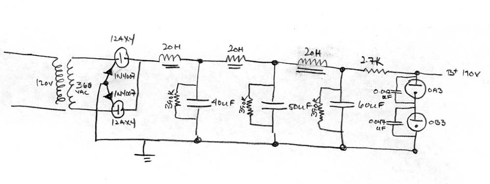

Hey Guys,
Here is a rough drawing of the PS as it is in my amp. I need to double check the VAC output of the power tranny, and confirm the dropping resistor for the VR tubes is 2.7K.
Never the less, this should give a clear idea of what I have done.
Hope it helps....
Bryan
Hope it helps....
Bryan

in my xperience - with shunt stabs -best way is when you burn AT LEAST same current in reg as your active stage ;
takin' in account that OA3 is capable of some 40mA max and calculating that 12B4 needs atleast 30 mA to sing,you are pretty close to margin
try to analyze few old books for paralell connecting of gas stab tubes or-even better - wire shunt resistor for 30mA in parallel to OA combo,and let them to burn just 20mA
(old trick

IRFP450? (is rated at 500V, 180W).
Take
As I designed the PS, the VR tubes tap 20mA, and the 12B4A between 20-25mA, so the load is equally shared. I have not done any serious measurements, but I can say that the supply is quiet.
If I was doing this again, I would decrease the B+ a little bit, as I am wasting a lot of volts dropping the B+ before the regs...
I do have a very slight amount of hum, but this is caused by the physical proximity of all the iron of the PS chassis (and maybe a little bit of messy wire which needs tidying up in the audio chasis). I cant hear noise from the reg tubes, and my hearing is pretty darn good 😉
Bryan
Bryan
