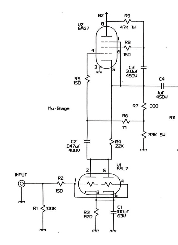

Here is a schematic showing a 12B4 with a cathode current source which I used in the output stage of a cheap, but decent, Pioneer DVD/CD player from a couple of years ago. The LCR low-pass filter is only needed for the CD application and should be deleted for line stage use. I found I didn't need a grid stopper and I won’t use them where they’re not needed. Your mileage might vary with a different grid circuit (like a volume pot, etc.) I ran this triode fairly hot (at around 3.6 watts of plate dissipation) because I wanted 30mA of plate current which is needed to give the 12B4 a low plate resistance and high transconductance. The circuit has worked flawlessly for two years and sounds superb. I plan to implement something similar in my Sony SACD player.

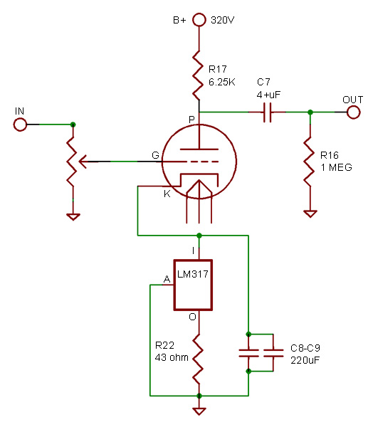

I drew this schematic up from the information that Brian Beck generously posted here. I was hoping someone could take a look and confirm some questions I have on it.
I took out the low pass filter for the DAC; there is no grid stopper so I believe it is a straight shot from the pot? Also, I put C8 & C9 in parallel to create the ~ 445uF
as noted.
Also, would 400V for the coupling and 50V for the bypass caps be about right? Are all the resistors ½ watt, what about the wattage of the plate resistor?
And I was reading Brian’s post here about optimally using a 20K input resistance on your amplifier. The design that I am using specifies a 100K, may a 20K be substituted here w/ no problems? Ultimately I would like to see this 12B4 preamp drive my tube amp and a future Aleph 30. And last elementary question is what value attenuator would be best suited here for the 12B4???
Thanx!!!

Sklimek,
You have a 100K input resistance to your power amp. This is what you’d plug into my earlier equation to figure the 12B4 coupling cap size.
For the 12B4 cathode bypass caps, I just used what I had on hand – a paralleled pair of 220uF caps, bypassed by a 4uF Wonder cap and a 0.01uF Wonder cap. Roughly 445uF. Don’t feel that you have to exactly duplicate it. This value gives a pretty low -3dB roll-off of 0.3 Hz. I’m a bandwidth freak – on both ends – don’t mind me. You can safely reduce the value to 200uF or even 100uF. But be sure the caps are decent and bypass them/it with a good film cap.
Your cap voltage ratings sound about right. Just make sure that your 320 volt supply doesn’t surge above 400 volts before the tube warms up. Power supply designs vary in this regard.
For the 6.25K, I used a 10 watt wire-wound, a rectangular sand-filled item, again what I had in the parts bin. (Actually it’s a standard 6.2K value, now that I peeked at the back of the CD player again, but no real difference). The resistor will dissipate about 5 watts, so keep it well away from any other components and maybe put it where it can ventilate. I put mine on the outside of the CD player, on the back next to the tubes which poke out horizontally. I built a guard to keep fingers from hot tubes, hot resistors, and high voltage on the resistor leads. Please be careful on this. And, no, I didn’t use a low-inductance resistor. It measures as expected.
Try it without a grid stopper. The need for a stopper will depend upon how well you wire your layout, keeping inductance low in the grid circuit. If you want you can try a 100 ohm stopper to see if it sounds different.
I tend to put a 1MEG metal film to ground at the grid after the pot just in case the wiper goes open or is momentarily intermittent with dust. This maintains the grid at a ground reference avoiding loud pops and scratches. Most people don’t bother, but it’s cheap and doesn’t appreciably load the pot. You can use any pot you want, but a decent one would be a 100K ALPS, blue or black style. A fancy stepped attenuator might be better, but a lot more money too.
Exactly! I did some listening tests and found that the need for the film bypass cap is an absolute must.... gives lower esr at high frequencies. In mine I used two Sprague 220 mf 63 volt caps paralleled by a .22uf 630 volt Wonder SETI cap.... luckily I have a bunch of these in the parts drawers. The difference with and without that film cap is amazing in itself... My output caps are Electrocube 5mf paralled with a .01 Wonder Cap. I might add another of the .22's across the output just to see what happens. The sound is now better balanced top to bottom.... even though the before was the best I'd heard out of my system... the .22's stay in mine!
