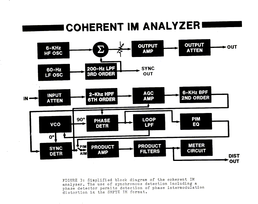

Pimm's measurement technique looks pretty solid for assessing the absolute value of the shunt C of a CCS. But measuring the effect of its variability within an audio circuit suggests discriminating between two forms of IMD: the conventional AM type, and the PM type, the latter being my main concern. My contention is that even very low levels of PID are obnoxious. A spectrum analyzer doesn't tell you which is which.
Cordell developed such a test set years ago, although I'm not sure it's sensitive enough for us tube-heads. I've been considering improvements. If only I had more time, dammit.
