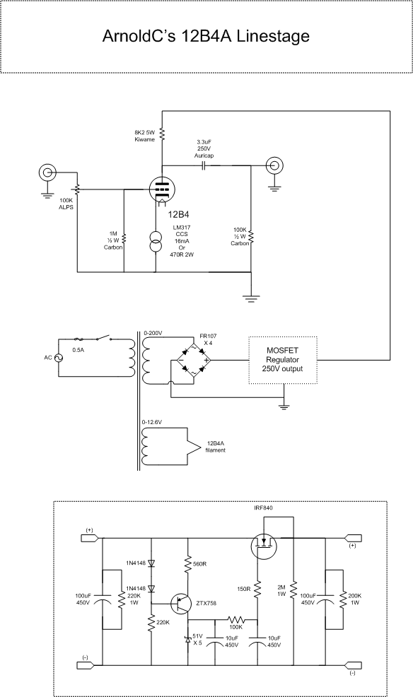

Here's mine which I shared to another member. My operating conditions are different from most you have seen here- I'm on the low voltage, low current side. You can start with this and tweak as you like. However, this *is* my sonic preference. Since I have a really small chassis (see my post several pages back, it's a stainless chassis), I
m using MOSFET regulation. Again, this *is* my choice.

arnoldc said:Here's mine which I shared to another member. My operating conditions are different from most you have seen here- I'm on the low voltage, low current side. You can start with this and tweak as you like. However, this *is* my sonic preference. Since I have a really small chassis (see my post several pages back, it's a stainless chassis), I

That said - Arnold, I'm trying to make sense of the VReg you posted (this is the first time I've looked at a SS VReg). There are two + and - points on the circuit. I'm not sure what to do with them.

adam, I'm sorry for the crappy schematic... the left side is the input from the bridge rectifier. The right side is the output to serve 2 channels.
The CCS is LM317 as posted by Brian Beck. Its bypass is a Black Gate 100uF capacitor. Just compute your resistor as 1.25 / desired current, i.e., 1.25 / 17mA = 73.5 use 75ohm.
pengboon, when that picture was taken, I have the LM317 in place. The LED stack goes into the same place. In fact, right now I'm using an unbypassed 470R cathode resistor. I'm trying to pick a flavor to match my amps, and which amp (I've got three)
