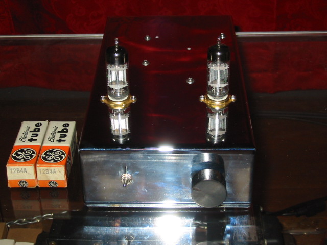

arnoldc said:I decided to put my 12B4A preamp in a different chassis-
Zen Mod, ugly enough for you?
ugly!
