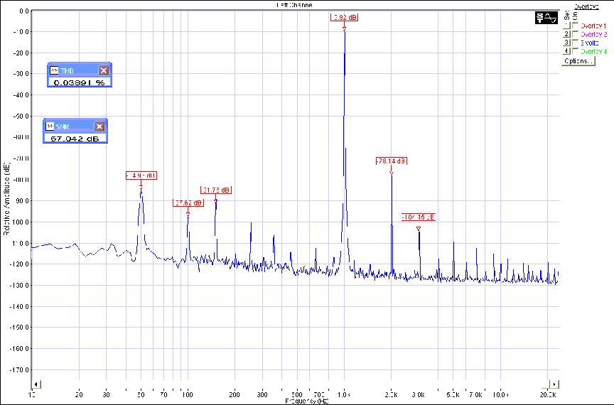

Here is the EH 6922 plot.

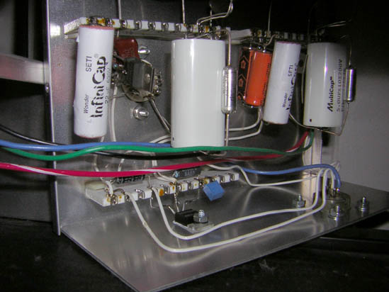

The toobe filaments draw alot more current at 6.3 volts. I run both mine from a single 12 volt adjustable regulator I.C. and its not referenced to B+. It can bee seen in the picture below. For me this has worked out just fine and the line stage is dead quiet even with your ear right at the tweeter! So personally I reccomend using 12.6 volts DC on the heaters. I did run mine from 6.3 volts but had regulator I.C. failures as a result. Warm up time at 6.3 volts was also ALOT longer.
Welbourne should be able to supply you with the correct transformer for their power supply running at 320 volts. Personally I've kinda been down a similar path already with a dofferent solid state regulator board from Germany... using 2 0D3 gas regulators in series per channel sounds ALOT better than the solid state board did and is less expensive. My main B+ supply is an Eico variable DC bench supply and it's main supply is choke filtered before it's regulator toobes.
I am using 2- 220 mf standard 63 volt rating Sprague electrolytics in parallel for the bypass electrolytics but also paralleled with a .1 Wondercap SETI. My output coupling caps are Multi-Cap PPMFX 5 mfd bypassed with a single .01 Infinicap. Note that my line stage is built on some Tektronix ceramic/silver terminal strips salvaged out of an old scope.

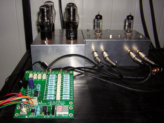

My most recent addition to the 12B4 line stage thanks to Luckylyndy is the Jos Van Eijndhoven remote attenuator. Jos is an engineer at Phillips but likes to design audio related stuff in his spare time. This attenuator is the best thought out design I've ever seen..... the attenuator allows just three resistors in the signal path per channel to adjust level. Only 6 relays and 12 resistors per channel are needed to give a 64 step continous step in level over a 70db range at 1 DB per step. A 2 digit LED resdout indicates the step of the level you are at as well as which input is selected. This is another huge improvement in sound quality and blows away my modified Daven series step attenuator switch. Jos's board also includes 4 input select relays. This is all controled through a standard generis remote that will put out Phillips RC-5 or EC-6 signals. There is also a combination encoder/push switch that also allows one to control volums and input select from the front panel. Changing to this attenuator was like rolling up a window shade in front of my speakers and the full remote control of level, input select, and mute is also VERY nice!
Jos's web site is here
