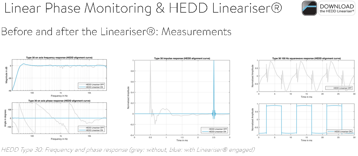

This is a follow up to my previous thread about HEDD speakers, & their VST Phase Lineariser. Zero-Phase-Shift & Lineariser Soft & System
Today i was able to go a store where they sell HEDD speakers, & get a demo of the Type 07 pair. I had full control of the free HEDD VST plugin that Totally linearises the phase. The VST plugin was activated through a DAW.

The HEDD Lineariser(R) - Heinz Electrodynamic Designs = The graphs below CLEARLY show the results
When activating the HEDD Lineariser®, transients are reproduced in perfect accuracy and the spatial qualities are being increased. Acoustic recordings will impress with their natural and intriguing character YouTube

Hello, I am Klaus Heinz , in charge of R&D at HEDD Audio. Having read the last posts I want to make some comments on our approach to linear phase monitors.
Speakers show irregularities in the frequency domain from different reasons, thus – inevitably – introducing changes in the phase response as well, a consequence of the Fourier or harmonic analysis. This is elementary physics and not in question. High and low pass properties of the drivers, filters, voice coils, even the low pass caused by the cabinet lead to nonlinearities (desired or undesired) in the frequency domain, thus altering phase response in a calculable way called Fourier Transform. So in the analog world one cannot have linear frequency and linear phase response at a time. There are mechanical approaches to improve the situation like staggered tweeters and coaxial drivers, they make the problem smaller by compensating the group delay, which however is the derivative of the device's phase characteristic only, not the phase response itself.
The situation changed when the DSP´s stepped in: they allowed to “store” the incoming signal long enough to delay the higher frequencies until the lower – and slower ones – had arrived, then sending the packages in a way that the time relations of the incoming signal are reinstalled and reproduced exactly, really tricky. So one thing is for sure: a linear phase response is more correct than an unfiltered response. Whether one can hear it ? Yes, no question, our customers and we in the lab have gone through the experience many times with reproducible results. Whereas the measurements of impulse related signals like square waves and Dirac (needle) impulses are improved drastically the audio effect is more subtle. However if you listen to linearized music for like 5 minutes and you switch back to normal you will be surprised how much sound and spatial imaging are improved. It works especially well with runtime oriented stereo (like all the old 50s and 60s recording are) where it delivers stunning results.
Last not least it has to be mentioned that the HEDD Lineariser® works in the frequency domain as well, due to the already rather linear frequency responses we have in our monitors this has a minor effect.

There are mechanical approaches to improve the situation like staggered tweeters and coaxial drivers, they make the problem smaller by compensating the group delay, which however is the derivative of the device's phase characteristic only, not the phase response itself...
