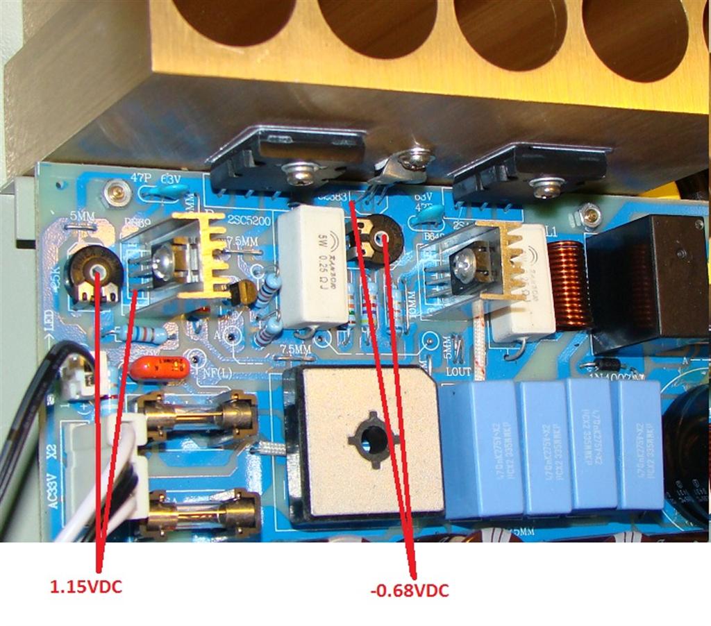

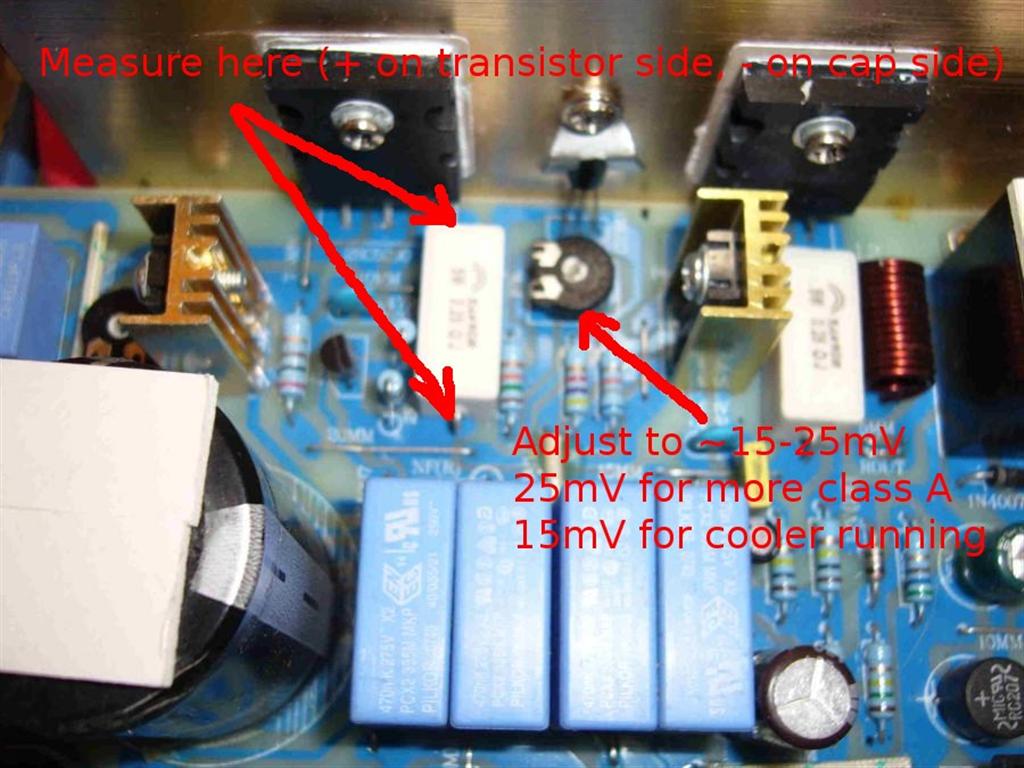

For the Bias just look to the DOC

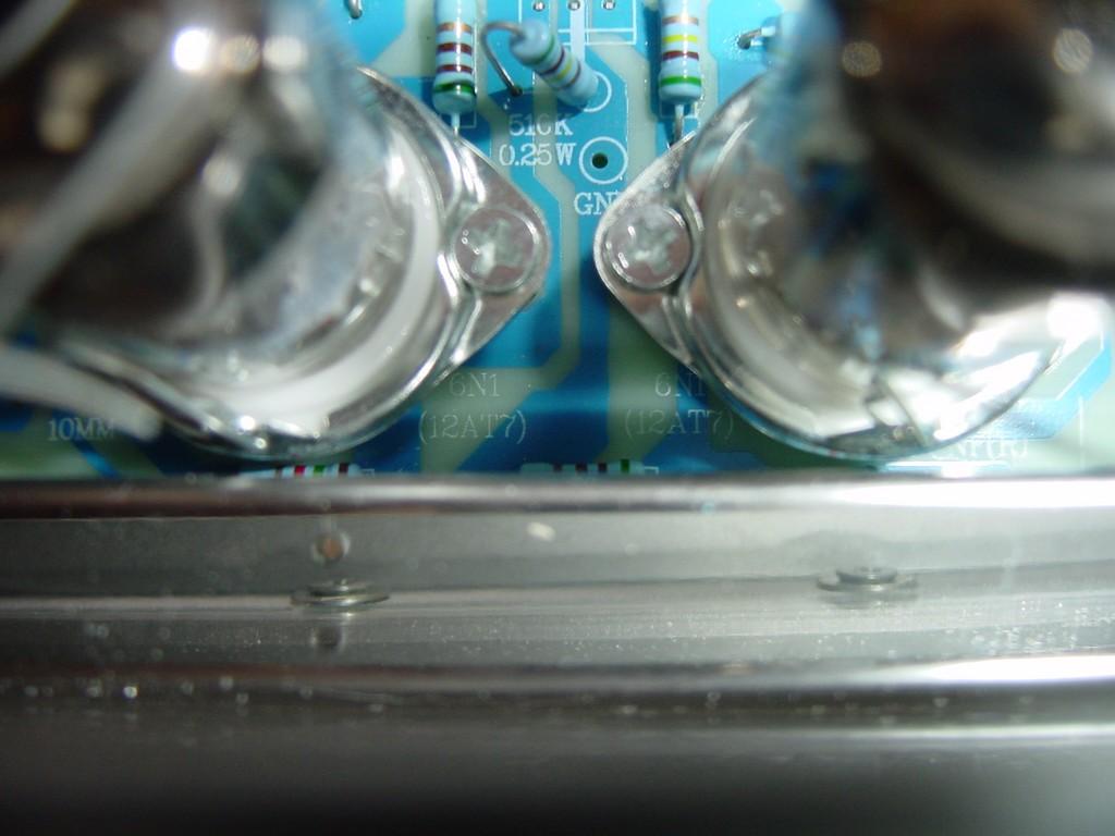

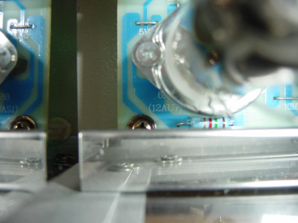

My PCB is marked for both the 6XX and 12XX tubes. Can I just drop in a 12XX without rewiring the heaters?
When I checked the DC offset on the speaker terminals, I got a fairly steady 287mv on the left and on the right I got 1v, then a quick drift down to 244mv. I did not have a load on across the terminals.....should I have had one?

I've put the link for the bias manipulation in this tread before and here it is again: Let me google that for you

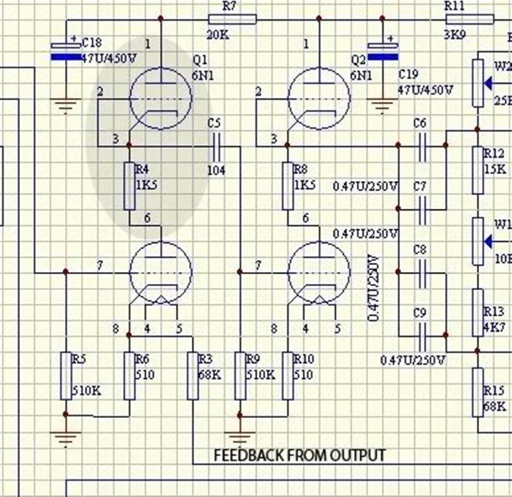

Did somebody pay attention on the tube part? SRPP is very strange.
Grid ot the load tube (second part of triode) is connected not after, but before resistor R4 or R8, pins 2 and 3 are closed.
I checked it on my amp, it is really done, as in drawing.
Does sombody know about that "SRPP"?

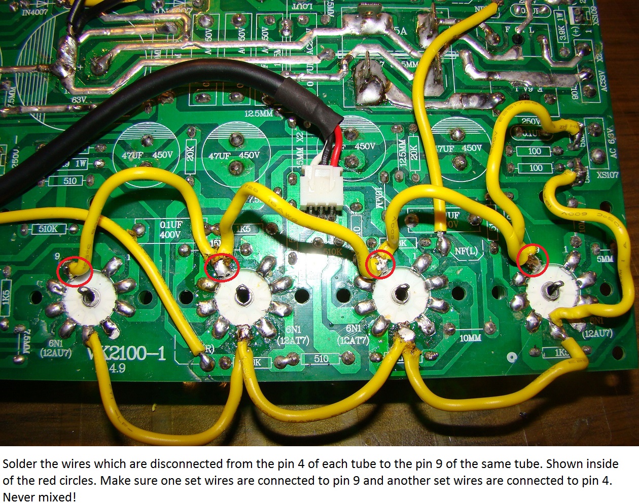

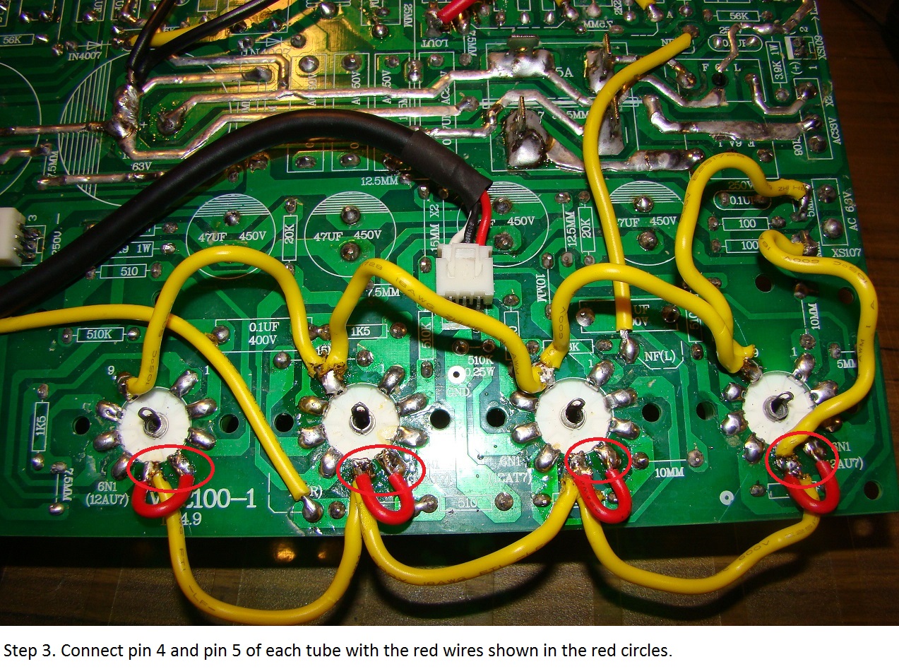

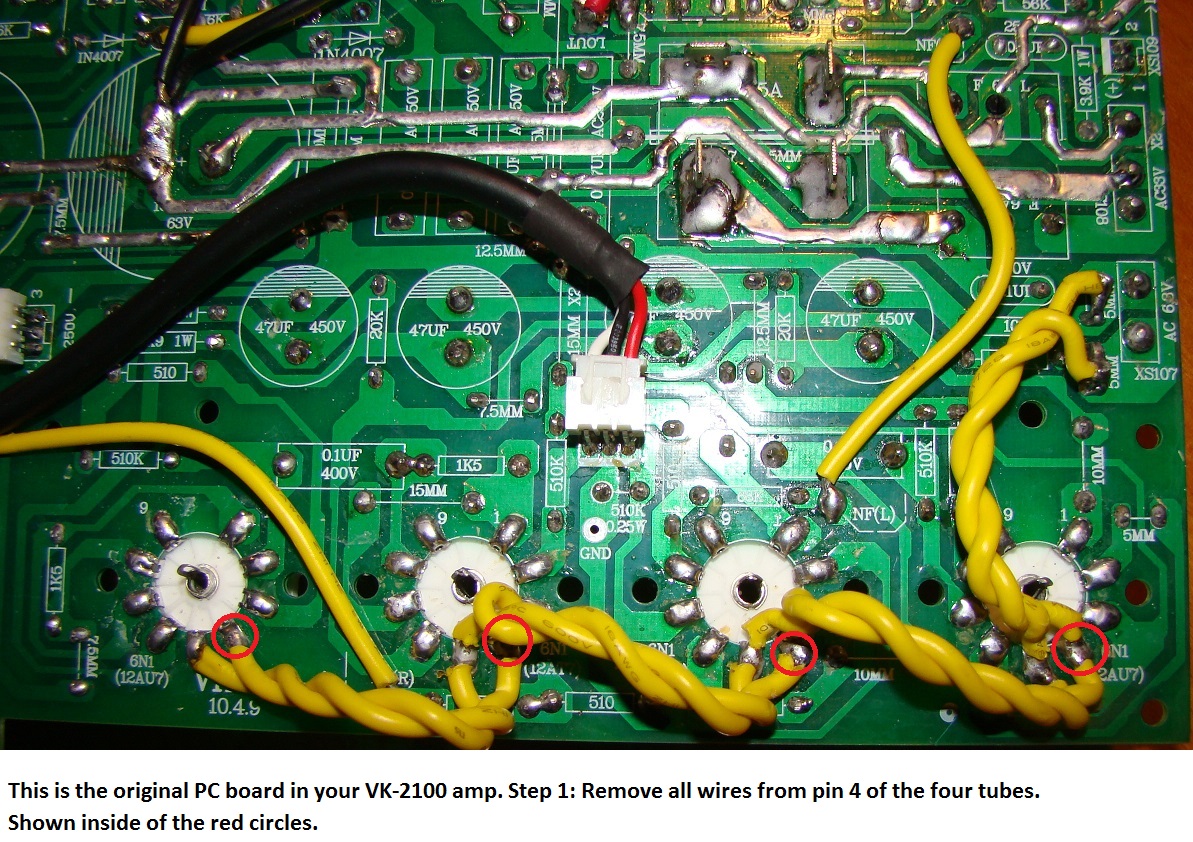

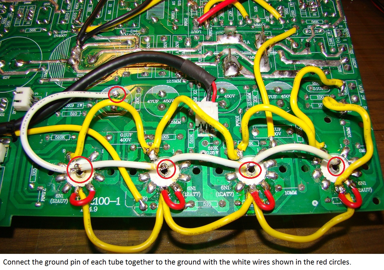

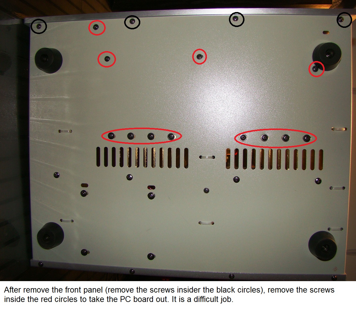

I will post all the pics and info I have and wanted to state that no matter what's printed on the circuit board, your vk-2100 is only wired for 12x pre amp tubes based on the year it was manufactured. DO NOT REPLACE OR ROLL TUBES UNTIL YOU CAN DETERMINE WHAT YEAR MODEL YOU HAVE. I have 12AU7 and 12AT7 printed right on the board, but mine is only wired for 6N1 tubes. According to my distributor and seller (Song in Canada- tabnac on Ebay), Yaqin never bothered changing board markings.
12V or 6V?
I am a little confused. After rewiring the tubes the way you have illustrated, is it going to be suitable for 12AU7/12AT7 tubes or 6N1? Please clarify. Mine is wired same as your first pic (pre-mod) I have two 12AT7 tubes installed at middle and two 6N1 tubes on the sides. It works great but 12AT7s dont glow at all while 6N1s glow orange beautifully

Are the 6N1’s compatible with both 12AU7 and 12AT7? I plan to substitute the 6N1’s.
Absolutely not.
