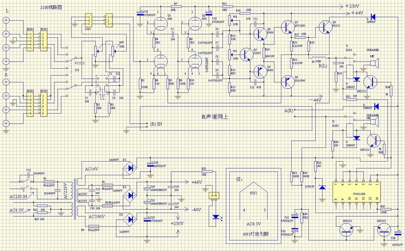

I had tried to find the hum noise fo mine.
In result, I removed C15(104, 2ea) like pic..
And add a left-right balance VR..

Hello !
I think it's a bit hazardous to swap one tube to another, without any changes in the circuit..
6nxx tubes have heater powered vith 6.3v
12xxx tubes are 12.6v powered basically ...But you can use 6.3v if you change some circuitery...connecting to-half parts of the filament //,
Relate to heater voltage, is heater current, you must be sure that the transfo would give you more power when changing from 6n1p, to 6n6p (change from 600mA to 750mA x 4 tubes )
I'm not sure about the schematics : about Q1 ...I think Pin2 is not connected to 3, but would be to 6 (symetrical SRPP)
Would someone would confirm ? and also about R4 and R6 values (colors) ?

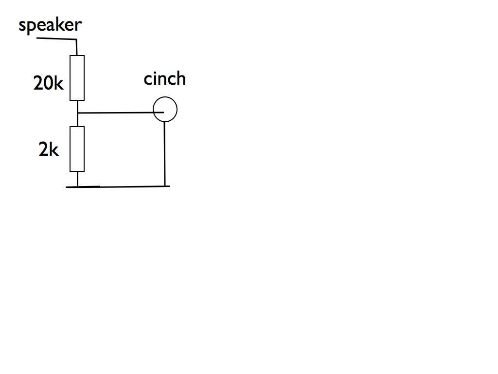

Pre-amp output for subwoofer VK-2100?
Folks -
I'm the plowed new owner of a VK-2100, which sounds really quite nice & tasty driving an older pair of Metronome 3's.
But, since I cannot stop myself from tweaking - I'd really like to add a preamp output to this poor, inoffensive piece of HiFi kit to allow for a subwoofer to kick my ribs about.
I poked about on the amp's mainboard, and found two 5mm jumpers labeled 'ROUT' and 'LOUT' - and since routing louts is ALWAYS a good thing, I had some hopes that these jumpers were going to offer a quick and dirty solution.
Sadly, it looks like these jumpers aren't at line-level, but seem to be unfiltered signals headed towards the output transistors - the waveforms there look pretty dirty and full of ripple on my scope.
From a cursory look at the main board, it looks like these two points are just ahead of the air-wound inductors that couple to the final stage. I suppose one could grab signal from the jumper points, or after the inductors, but I think that you'd need to build a buffer stage before feeding anything out into the Real World.
Any ideas or comments - anyone already done this mod?
Alternatively, I did run across another post on the tubes forum that shows a simple, and apparently effective little resistive network which, when taken off the main output provides a fairly low-level signal to drive the subwoofer amp. This solution should be a reasonable hack until a more permanent, or at least more elegant, solution is hit upon.
Cheers & TIA for your comments
Jim

Hello, everyone!
I apologize if I am going to sadden some of the people with my comments but I think you should know some facts about this amplifier; they will come from somebody, who is working with analog electronics for last 20 years and at least it will bring some technical clarity on a number of topics here. Or so I hope.
I bought one about 2 years ago with the idea of having a workbench for trying some ideas in hybrid sound amplification. Upon opening I found immediately that the design is not really friendly to major mods, so I will need to think of something more creative than just adding a web of wires to the amplifier.
As far as architecture is concerned, it is indeed a gain stage with current buffer and global negative feedback. Now, some numbers. 2x 6N1 back to back are producing a gain of app. 1,200x and very deep NFB reduces it to app. 30x. So, we have >30dB NFB in the amplifier, which means it does not matter if it is the tube or a solid state design - you are listening to NFB. Also, circuit diagram has a major error in 6N1 section, good thing the PCB is routed properly.
BTW, the heater circuit is wired separately at the back of the board with thick yellow wires, I am quite sure switch between 12.6V and 6.3V heater supply is done by just wiring it differently but in any case, there is no automatic selection between different heater voltages!
Also, TOSHIBA is not manufacturing the output transistors of that type for, maybe 10 years now. What is used in VK-2100 is Chinese knock-offs.
VK-2100 sounded noticeably worse comparing to entry level BRYSTON solid state amplifier.
I would definitely recommend before investing into silver wiring and audiophile capacitors to make some other basic improvements to the amplifier if it is itching to get the sound improved on VK-2100. Note that my guinea pig ended up quite different from the original architecture and it will take time, some skills and patience to make all the changes, would you decide to follow my route.
FAIRCHILD manufactures replacements to 2SC5200/2SA1943, they are FJL4215/4315, they are quite inexpensive and they also have better linearity. I purchased a handful from DIGIKEY, matched two pairs and replaced the output transistors. That greatly improved the stability of DC offset with temperature and now it is running at 3-5 mV of DC offset at all times.
If you are planning to still have deep NFB, adjust the output stage quiescent current to app 50 mA. The pots used could drift away during the transportation stresses and it takes literally single degrees of rotation to misbalance the transistors.
6N1 or 6N1P (note that 6DJ8 is not a direct replacement to 6N1P!) simply can not produce any decent sound at something like 2 mA of plate current, wich is a factory setting. Power supply does not have a lot of room for improving on that, so I left only one tube per channel and increased the plate current to 5.5 mA. That was the single best improvement I had from all the mods. Note that in this case the existing NFB loop is useless as the gain stage has become inverting, so you would need to come up with the decision on either to keep the NFB but modify it or not to have NFB at all. I opted for the latter and had to deal with amplifier instability caused by the poor topology of the PCB. NFB hides that problem of VK-2100.
Indeed all 0.47 uF capacitors need to be replaced; mine were from a Korean manufacturer, who makes no secret that these are from low cost computer grade family.
Well, I think I would better fast forward to the end and describe what I ended up with.
With new power transformer and 18V power rails I have AB output stage with 0.8 A quescent current (that is maximum the heatsinks can handle without going to dangerous temperature. Replacing heatsinks is something I did not have courage for - it is really complicated), no NFB, 1975 6N1P-EV from VOSKHOD factory runing at 5.5 mA. Output impedance is at app. 1 Ohm, maximum output power is close to 6W at 8 Ohm.
It sounds really pleasant now, I compared it to 6C4C SET with HAMMOND output transformer and it is not losing it by large margin if loosing it at all; I am switching between them from time to time just for fun. Source is MARANTZ CD player and NAD turntable with CAMBRIDGE audio phono stage. Speakers are open baffle 15’ MAGNAVOX with horn tweeters, both from 1970s production.
BTW, my original idea was to use transformer feed of solid-state output buffer from a tube gain stage but that will have to wait for better times.
My conclusion is VK-2100 is not worth attention as a component in a stereo system as-is, extensive mods to architecture and component selection indeed could help stepping up quite significantly. It is actually not expensive to make those changes but it would take time and I would not recommend doing them without prior experience of repairing or modifying audio equipment.
