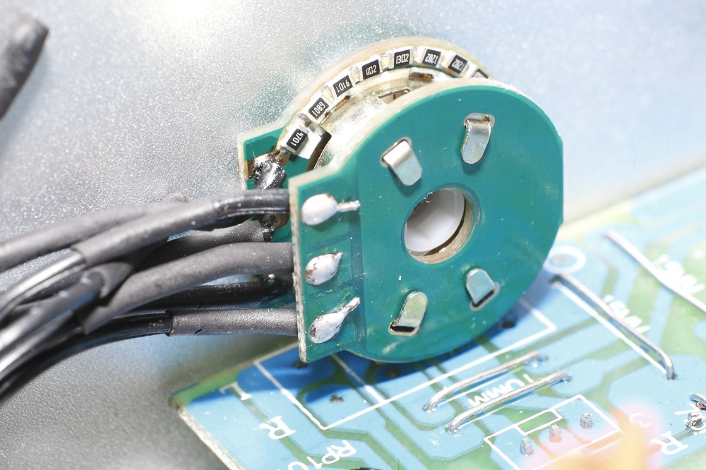

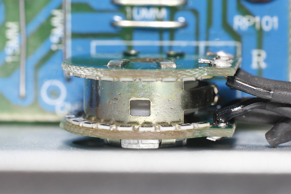

I changed the volume pot for a 100kohm stepped attenuator with SMD resistors bought cheap on ebay, I gained A lot on highs and soundstaging, tha amplifier became much more detailed and airy,initially the pot was 50kohm, with the change to a 100kohm one, the volume change is now much more progressive than before, which is very handy !
to resume, this gave the biggest immediat improuvement among all the small things I did to the amp, so very recommended !!
finally this potentiometer can be soldered directely to the PCB, it is small, I'll do that next time.

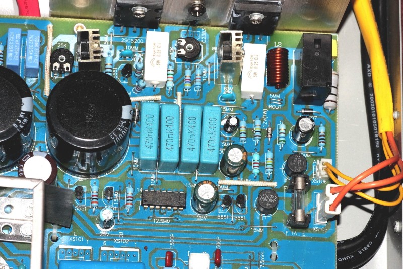

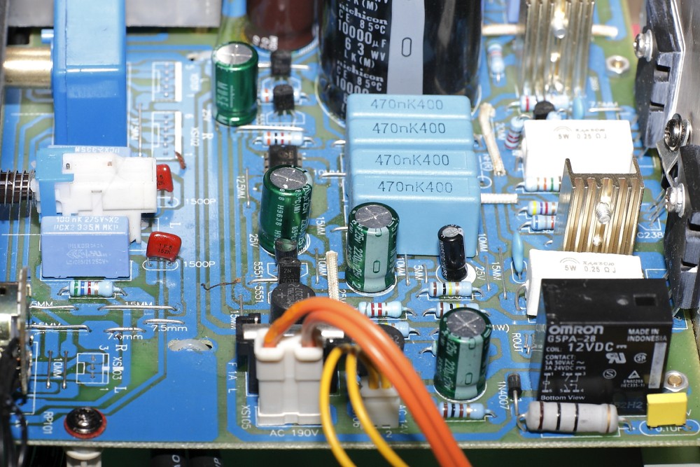

I replaced some caps in the amplifier, I do not really know what did they serve but anyway I made the move and i'm glad I did !!
this removed completely the POP and sounds in the speakers when booting the amplifier !!, now it is perfectly silent for 10 seconds, the relay clics , and voilà, no hum or hiss like it did before (seems to be an issu for all the possessors of the amp) completly cured !!:
This was the situation before :
Also I decoupled all the big capacitors in the amplifier by some russian PIO NOS K42y-2 capacitors I had, this gave me better bass, and better separation.
I dont have a pictures they are stuffed under the PCB.

The new volume pot :
the new capacitors :
old situation :
