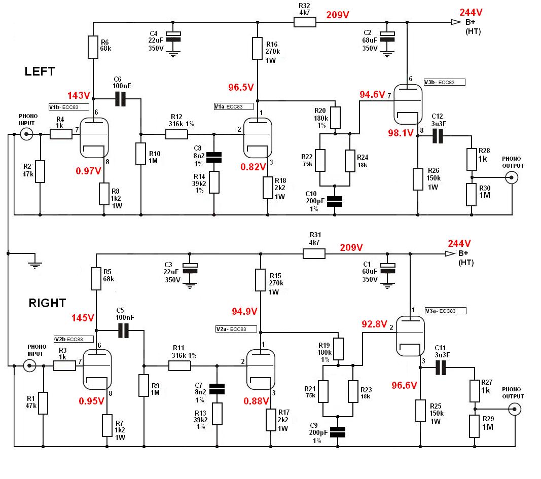

When making the conversion to the third valve version will this third valve have as much of an effect on the final sound as the original two valves? Or with other words could I retain one of the original Chinese valves in the new position and upgrade the other two without degrading the sound of the new valves?

ok, I have finally succumbed! been looking at hagerman and bottlehead kits, and have decided do do the "LES" but there is so much taken out of the YAQIN, I am thinking of doing the whole thing from scratch, in a larger enclosure with a toroidal transformer.
Now my problem is it has been 33 years since i have had a soldering iron in my hand and finished my electronic engineering course!

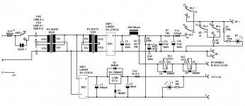

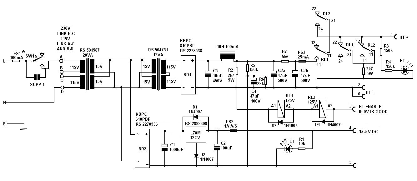

So i am planning to copy the les schematic entirely with close tolerance components, but has anyone got a schematic for a power supply using a toroidal that i could use for this?
I know it is cheeky , but i am so rusty on my electronics it would be great if there was a component list also. I am in the uk so 240 mains would be used for the input, I am not worried about LEDs on/off indicators

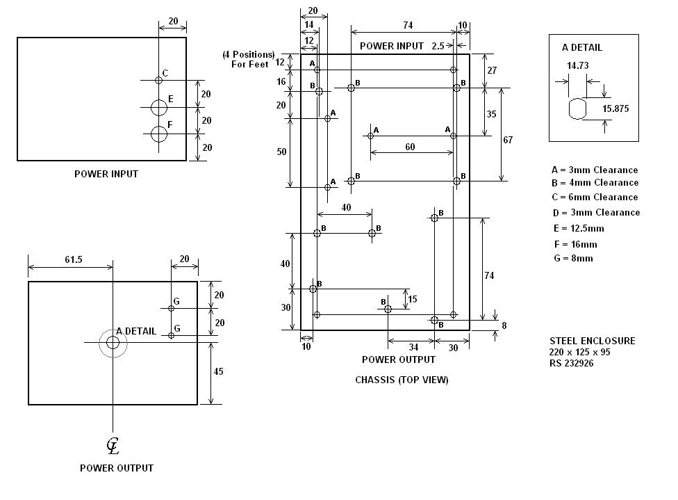

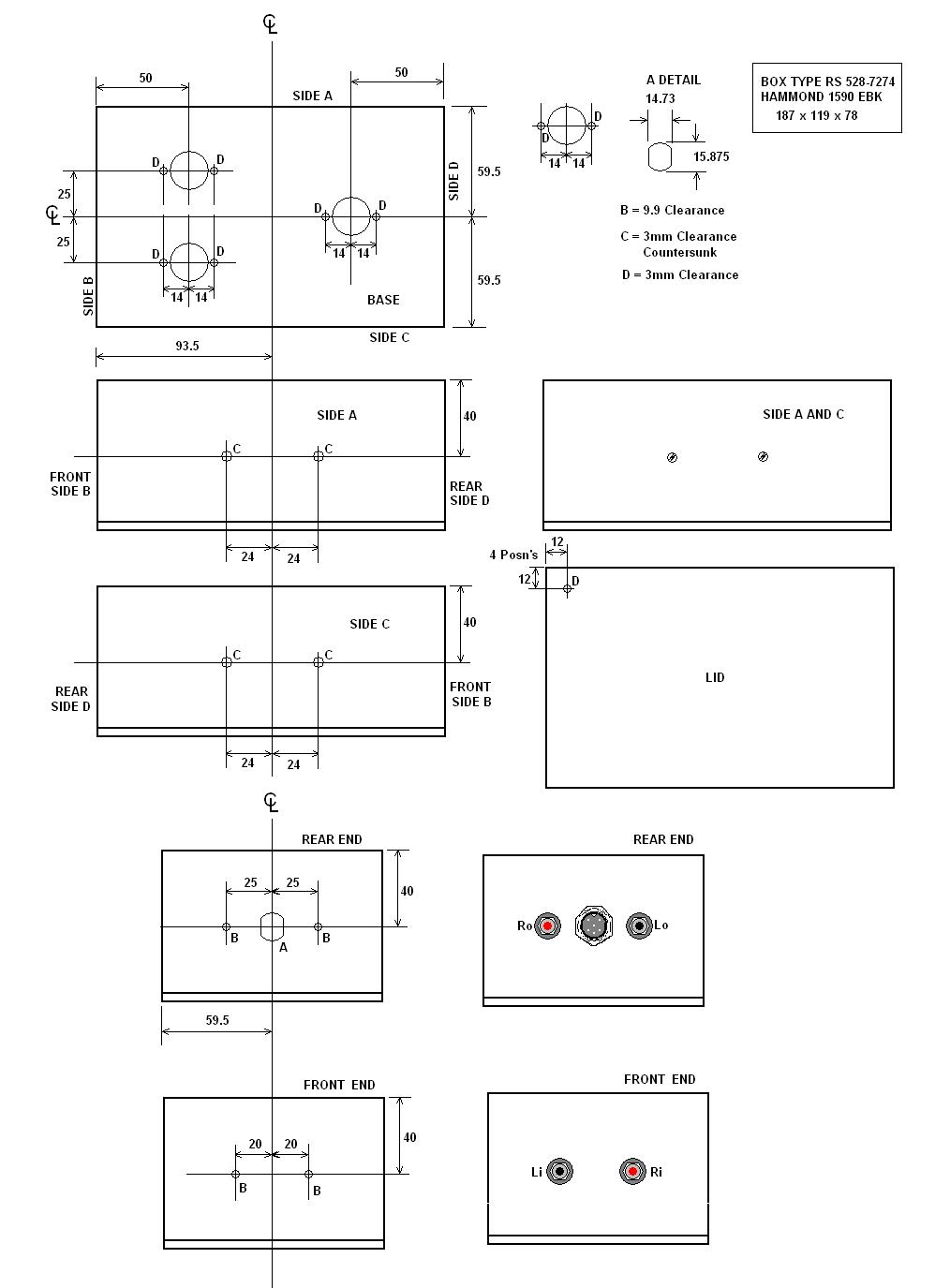

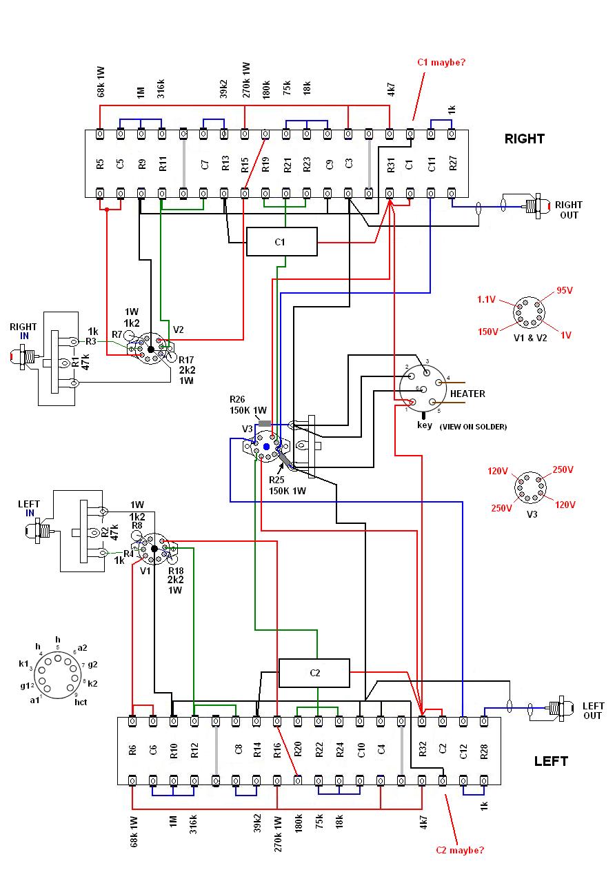

I am thinking of putting the PH16 in one of these High Quality Enclosures for Audio, DIY Hi-fi & Electrical projects
and drilling the top so the tubes are exposed, would that be enough ventilation with the side vents for the circuit?

I suppose it's a matter of taste, but I would leave the tubes inside, they don't glow much, and putting a wire mesh above them for ventilation. That sure is a nice looking case.
