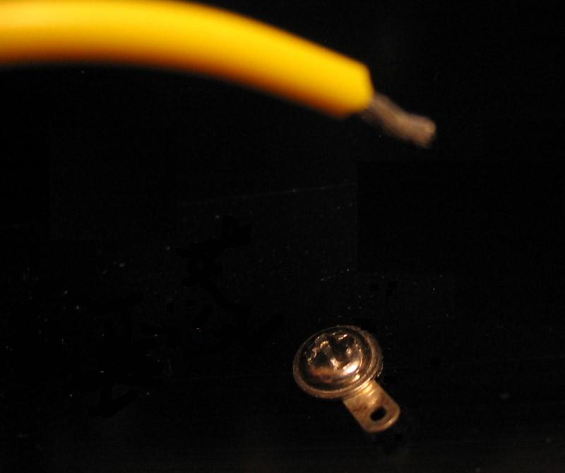

WARNING ALL MS-22B OWNERS
I found this whilst doing a recent upgrade (No- not yours Bill or Rod).
This wire is the only wire connecting any of the metalwork to the Earth pin of the power connector. With this open circuit there is an extremely high risk of an electric shock! All owners are advised to check that there is an adequate connection between the Earth pin of the power connector and the metalwork of your unit. Note that no solder has been applied to the tag 😱
Also if you are in the UK - DO NOT use the 13A plug that comes with the unit.
It has an illegal sleeved Earth Pin 😱 and no visible fuse in the plug 😱
Dump the lead and fit a proper British Standard approved item.
Bill, Rod and Steph you can relax as your units now have a 5 point earthing arrangement. 🙂

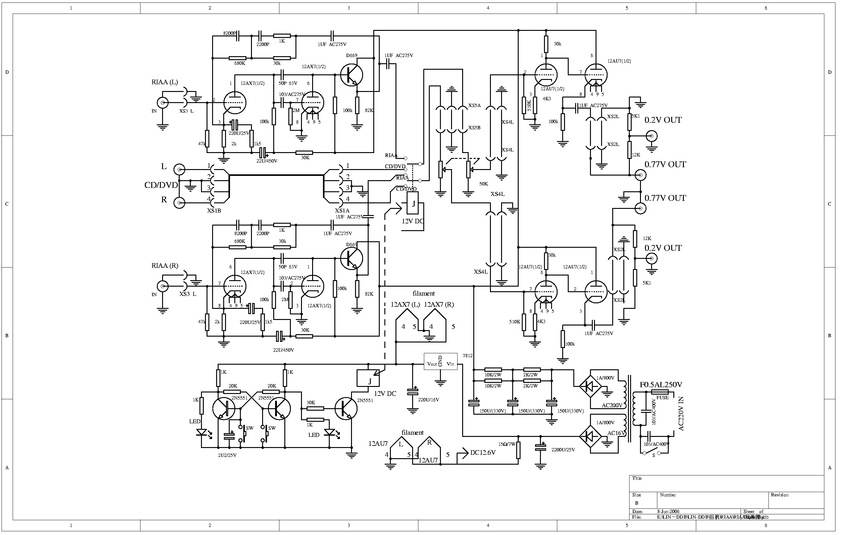

I just finished converting my MS22B and wanted to thank Les for his design. I always thought the MS22B was missing something, like there was a big hole in the sound. I have very little experience working with electronics and was a little hesitant about doing the conversion. Now that it's finished I can't imagine ever buying another phono pre. Thanks a bunch Les.
Another MS22B rebuild by Les (Hi-Q) - apparently Yaqin had fixed the hum on their latest model - but with the extra tube and a host of new components as detailed in Les' comprehensive PDF guide (see above) the difference is literally between Night and Day. I was somewhat underwhelmed with the original unit - now I'm hearing stuff in the mix I didn't know was there and a kind of brittleness most noticeable on vocals is essentially gone - I'm back to enjoying my vinyl. Thanks to Watford's DIY audio genius! 🙂

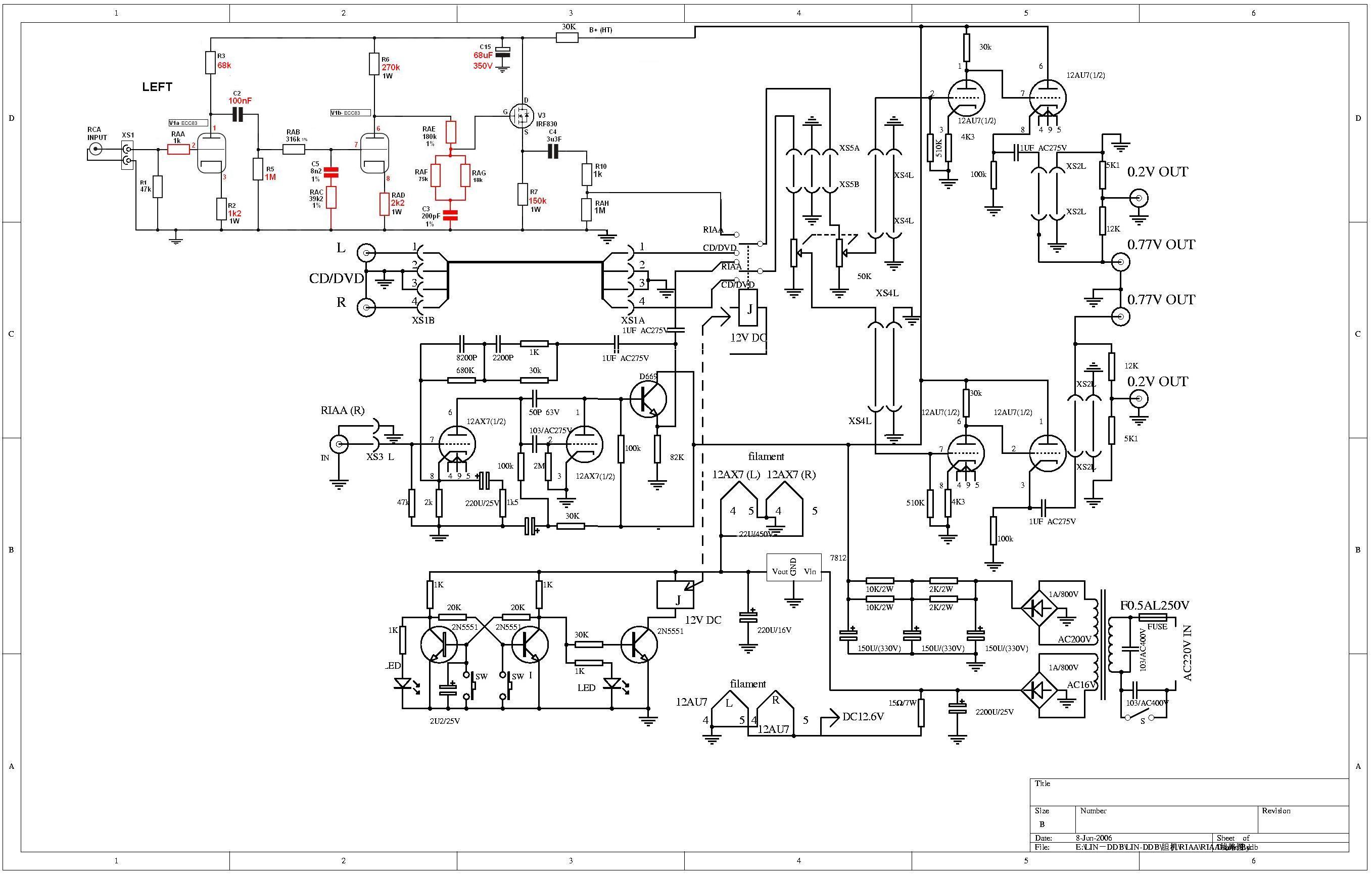

Les,
I used the MOSFET. Didn't do much of other changes. I also believe it is still possible to improve 12-B further.
regards,
Kanishka

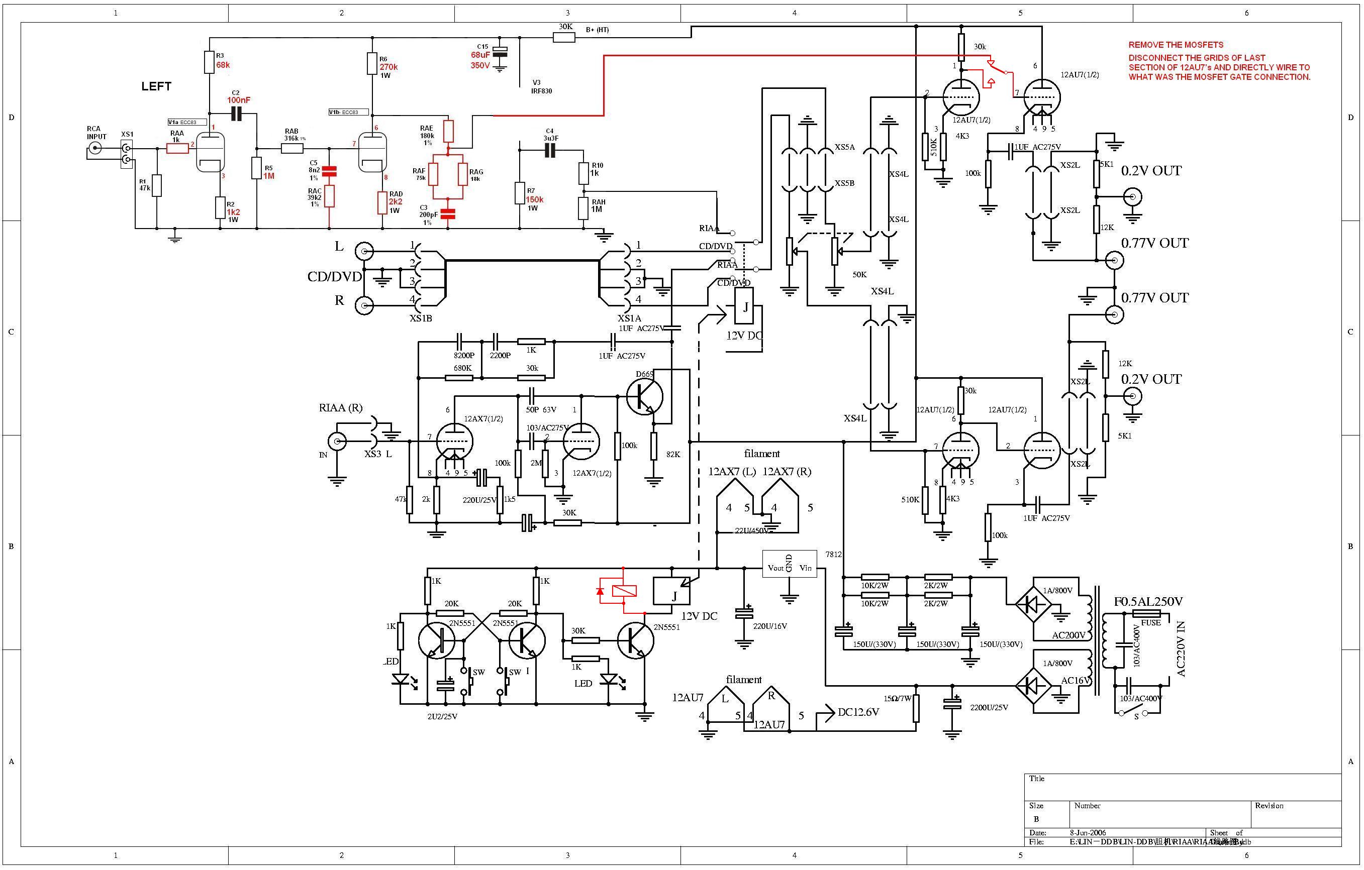

Yes Kanishka, you could do it by isolating the grid of the last (Buffer) Triode using a switch which then connects it to the Gate connection of the Mosfet, which you would have to remove. However, the volume controls would now be out of circuit. The alternative is to hide, if internal space permits, another double Triode inside with the Plate, Grid and Cathode connected in place of the Mosfet at its Drain, Gate and Source pads respectively. Les
Les, Thank you for these valuable suggestions. Do you have any schematic done for these changes? I don't mind trying them and see the magic 🙂
Hi Kanishka, It all depends on what conversion work you have done so far, I assume it is as depicted in the first Jpeg.

Thank you Les for this detail explanation. I did the exact changes mentioned in first schematic.
Apart from the changes you suggested, 20K B+ series resister was reduced to 10K (B+ is 204V which I did not try increasing) and bypassed the 5K1 resister in the output and replaced the 12K with a 270K. Hope these changes are fine. Please share your thoughts on this.
BTW, in your opinion what would give more superior sound out of these two methods (direct connection+replacing 12AU with 12AX Vs adding the 5th tube)? 5th tube seems to be a cumbersome task considering the space but don't mind trying this if it gives far better SQ. Otherwise if SQ is marginal, I would stay with the first option. Appreciate your advice on this.
Hi Kanishka, I think using the present output 12AU7 would be the way I would go as you would then remove an un-necessary stage of buffering. Of course this would involve using an extra relay to do the switching. The internal volume controls would be out of circuit for phono use of course but you could preset the phono volume using your main amp controls and preset the CD input using the MS12 controls - just a thought.
I have amended the circuit with the extra relay, I am assuming that on switch-on the ms12 defaults to Phono/RIAA input. You may need to select a good sensitive double pole changeover relay with a high resistance coil as the present transistor only has a gain of 30 though the maximum collector current of 200mA should be adequate.
Please Please place a diode across the relay coil! Yaqin should have done this as otherwise the back emf from the relay when it turns off does not do the present transistor a lot of good.
Even if you don't fit another relay, please put a diode (1N400x series) across it as shown, cathode (normally marked with a silver ring) to the power rail.
I agree with your increase in resistance to 270k on the output and you may have found a slight increase in Bass by doing this.
If you adopt using the 12AU7 as the final buffer it will free up a 1uF capacitor and I suggest that rather than waste it, you place this in parallel with the present one fitted on the final buffer.
Feel free to remove the Mosfet though on each channel and hard wire to the 12AU7 grid wire just to hear what it sounds like. Then if you are happy, you can proceed to add an extra relay or suitable switch.

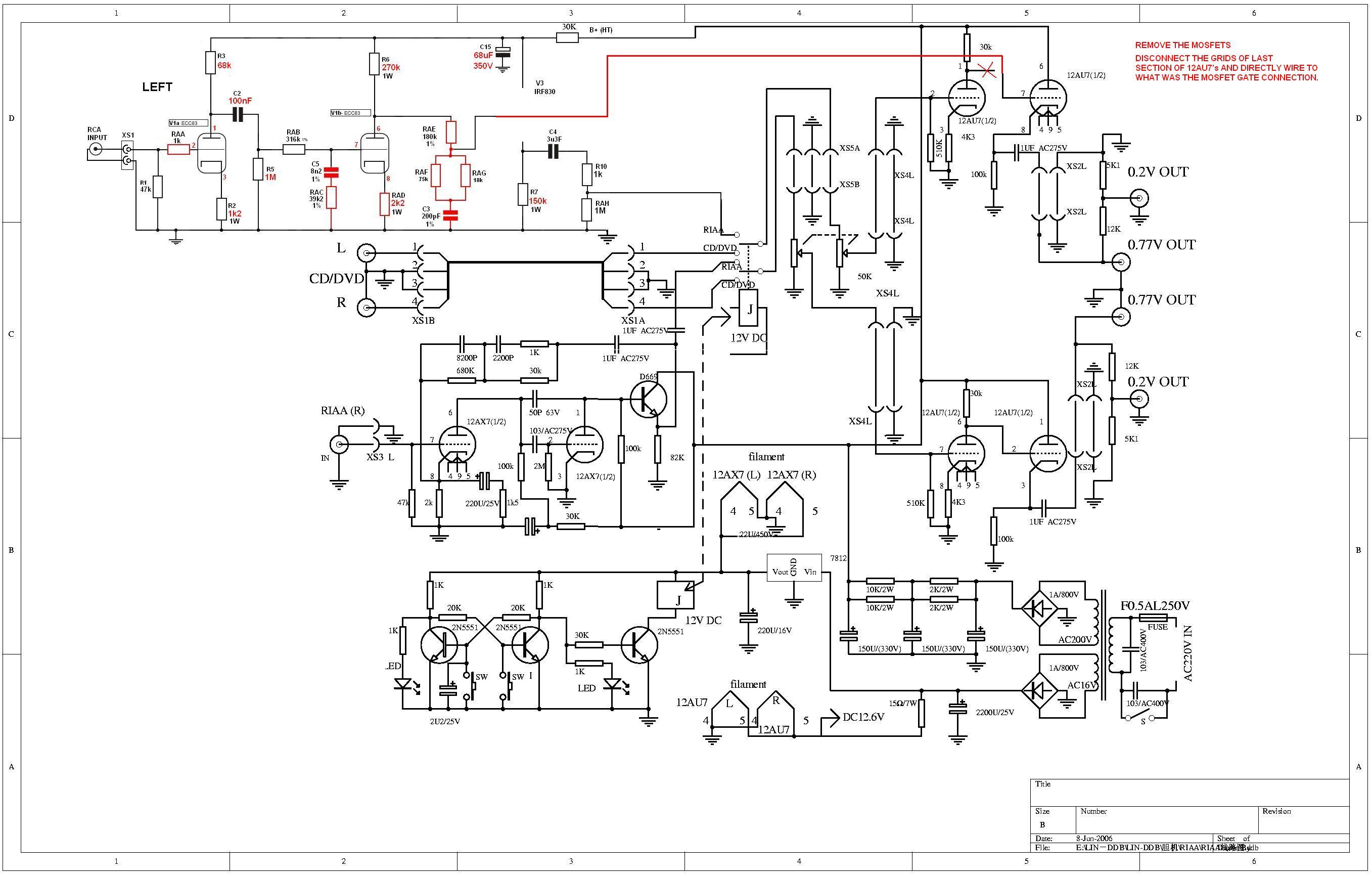

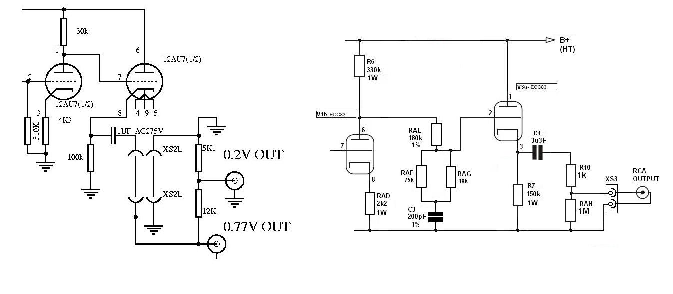

Thank you Les. You are really helpful.
Since I don't use much of digital audio, I would rather reserve my 12-B completely for RIAA. In this way I could avoid putting anything additional in between the signal. Just connect the gate to grid and have a happy listening. Just order the "Winged C" so by the time it arrive, I could keep my 12-B ready I suppose.
However I have a small query on your earlier suggestion of replacing the final 12AU7 with 12AX7. Wouldn't this require changes to B+/heater supply?
Kanishka
Les, apologies for asking too many question. Hope you don't mind clarifying below my queries too.
1. Don't we need a coupling cap/grid leak resistor for 12AU7 in the latter half?
2. Is it feasible to use the first half of 12AU7 seperatly as a CF buffer for CD/DVD input as below? We could use 0.2V out for this by decoupling it from the rest of the circuit I suppose. In this way I think it is possible to eliminate the use of a switch/relay.
No No Kanishka, no grid leak! Both the Yaqin and my circuit are DC coupled directly to the preceding Triodes Anode. In the case of the Yaqin this is direct but in my circuit it is via the 180k resistor RAE.
This is what makes it much easier to try. Les
P.S. Don't forget to remove the Mosfet first🙂
