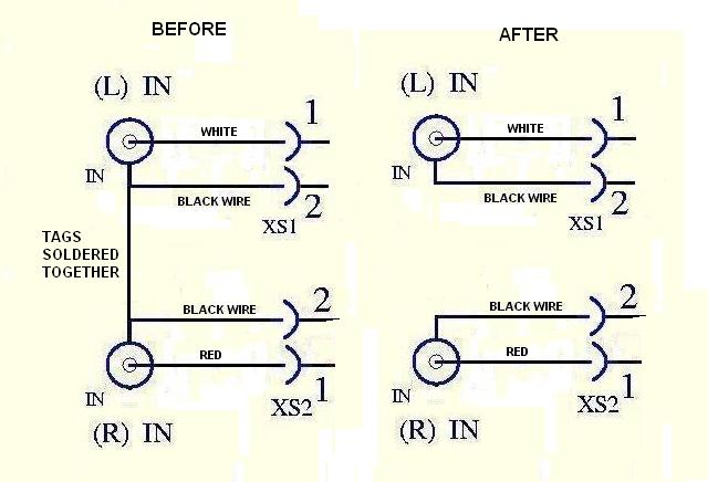

Hey everyone. I have the ms-22b with a pretty good hum and I also sometimes pick-up radio stations. I wanted to try the things mentioned here, but I needed a little clarification.
Earlier someone said they disconnected the yellow wire that was connected from board to chassis and the hum disappeared. Then he said he installed a mini 69 circuit to this wire between board and chassis. Does this mean he reconnected that wire? If so, why since it fixed the hum problem by disconnecting it? Is it safe to disconnect it?
Second, somebody split the incoming phono input ground leads. After I unsolder them, where do I then connect them to? Same place or somewhere different?
Thanks for the help,
Evan
Hi Evan, personally I found the 69 circuit unnecessary if you isolate the input grounds. When you gain access to the rear of the RCA sockets you will find that on both the input and output sockets, the manufacturers have soldered the ground tags together and terminated both Black wires (one for each channel). What you need to do is temporarily remove the Black wires then unsolder the two tags away from each other. When you have done this, reconnect the respective Black wire to its Ground Tag. Hopefully the attached simple sketch will help you.
You may have a different issue with RF interference, this is not due to a Ground loop but something else. Have you tried using the Ground post on the MS22B as this may help. Les
Hi Les, thanks for getting back to me so quickly. The diagram seems pretty clear to me. So I won't be desoldering them from the board, but from the tabs at the jacks at the back of the unit?
The RF is less of a concern because I usually can't hear it unless my ear is near the speaker, also the hum drowns it out! I am using the ground post on the yaquin and it helps to slightly reduce the hum.
Evan
Hi Evan, I did both input and output but the inputs are the important ones. You will not cure hum completely due to the power transformer magnetic fields inducing it into the front end Triodes. If you are lucky, you can prove this by vertically dangling a large screwdriver between the valves and the transformer housing, moving the screwdriver around and you will hear variations in mains hum level. At least you can reduce it to an acceptable level doing the wiring change. It is not a very clever design, which is one reason I re-designed it. Even the heater regulator is fed from the wrong place as it sees some of the smoothing capacitor ripple current - such a basic mistake to make with the PCB tracking!

Thanks Les, I just saw your post, but I went ahead and did both input and output last night. Glad to hear that's ok. After changing just the input grounds, the hum did not go away, but after doing the output too, it reduced it significantly to a level that I'm pleased with.
