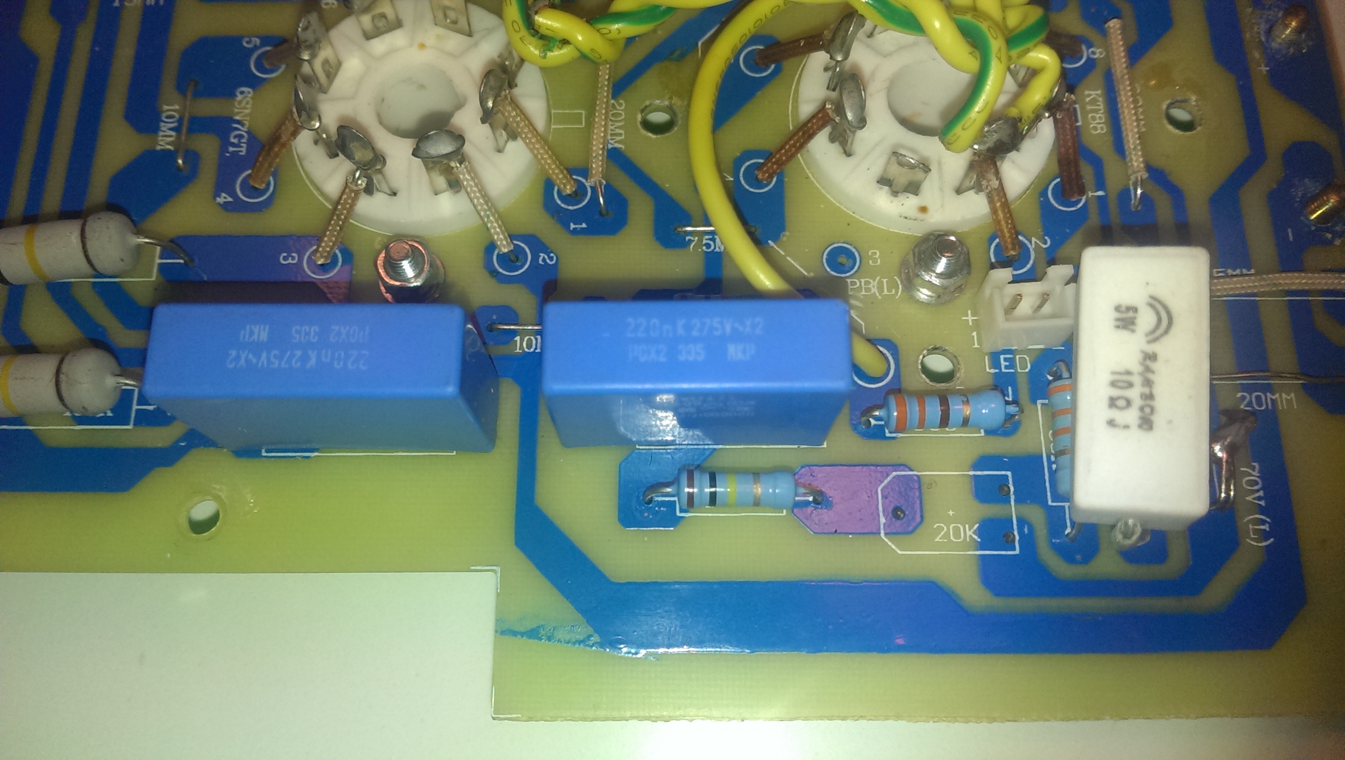

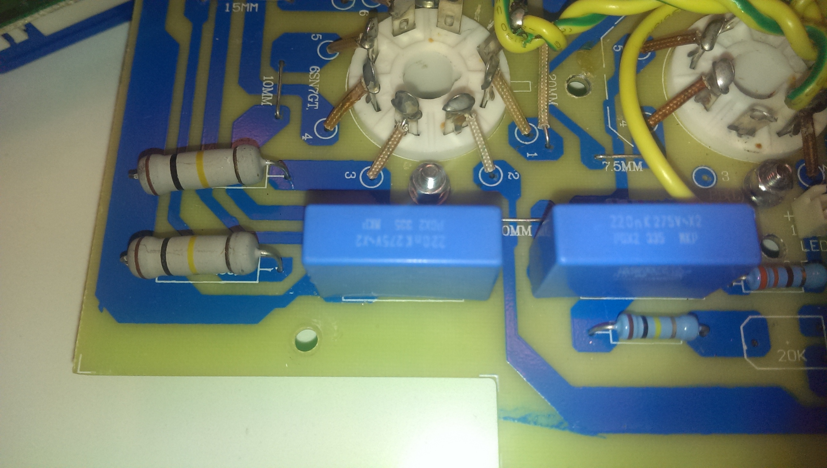

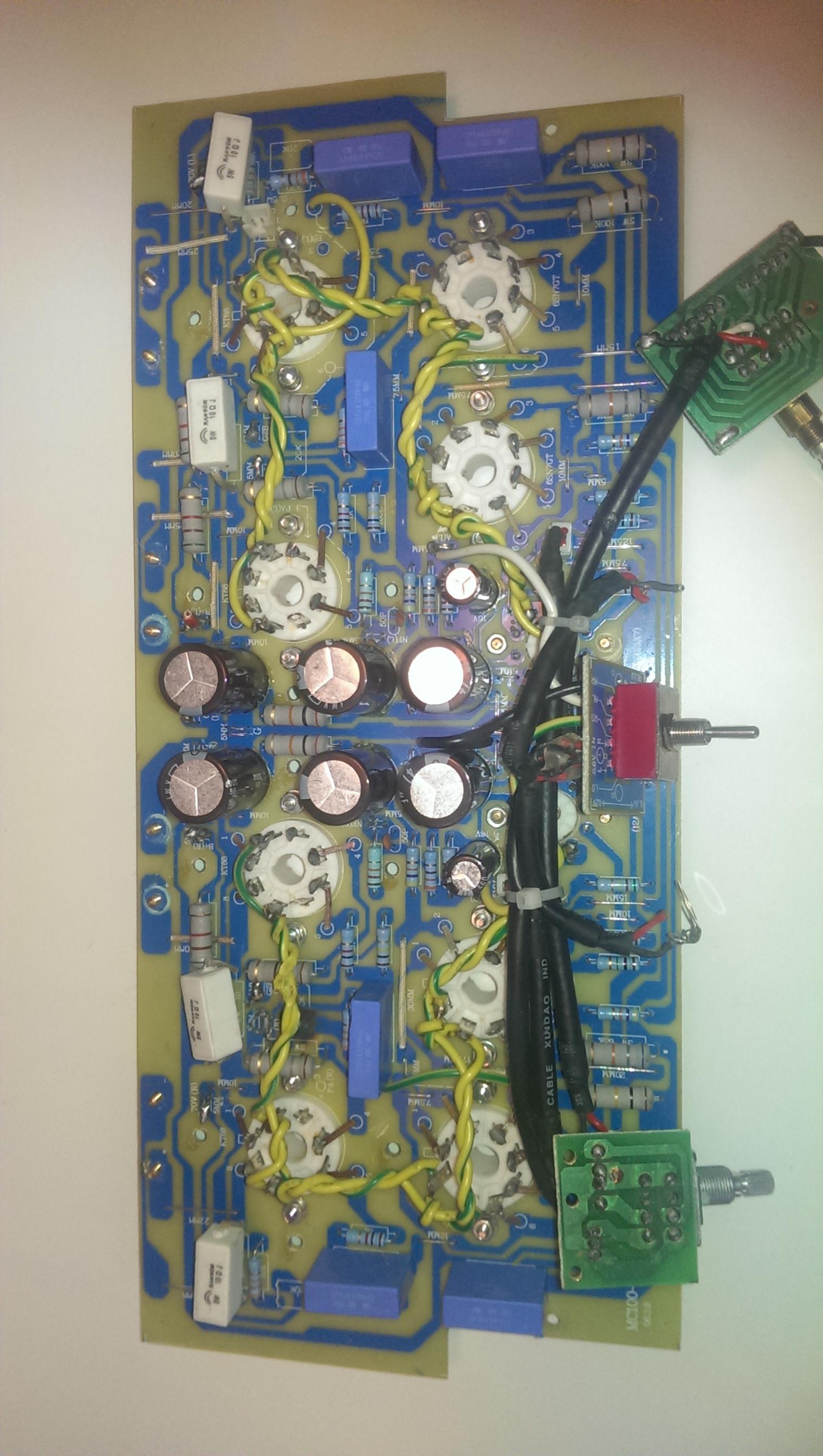

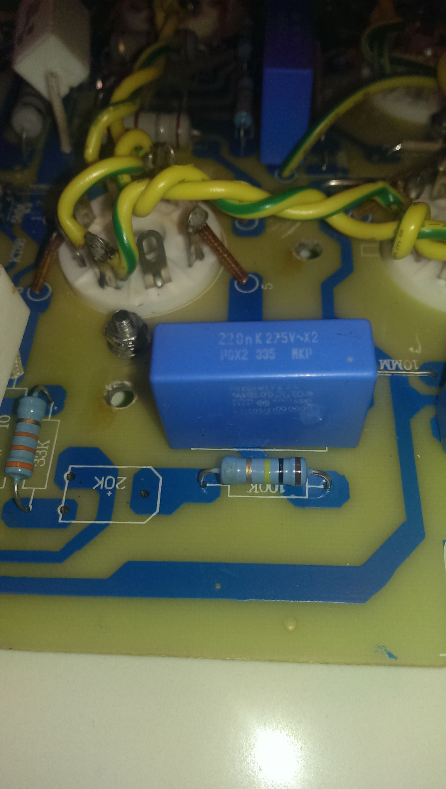

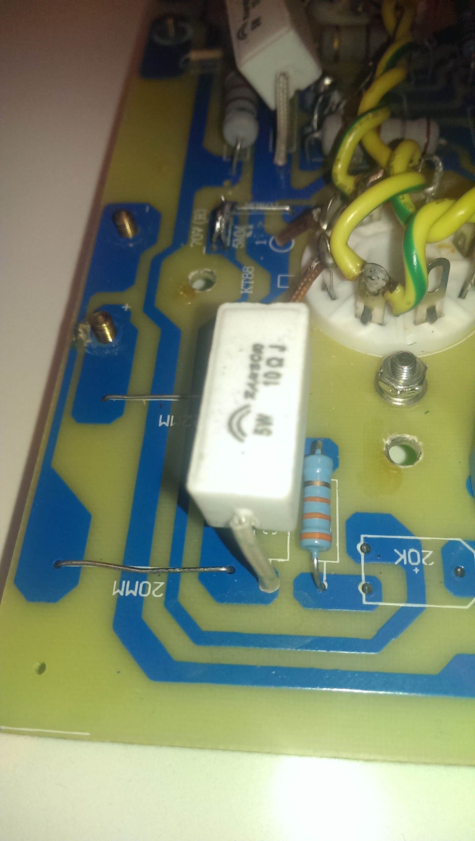

Help asked upgrading yaqin MC-100b caps and resistors
Greetings from Spain and happy new year¡¡¡
I am the proud owner of a Yaqin MC-100b. So far I am fully satisfied with the amp, it sounds incredible good to me, much better than expected. Let me start by saying that I am not a technician at all. I just have very elementary electricity concepts, some soldering skills and of course lots of care. When adjusting bias for the first time I realized one of the pots was broken. Therefore, with some Christmas holidays ahead I decided to take the PCB to replace it and, once being there, I thought it would be worth upgrading the amp caps (I’ve read very good reviews about the Murdoff/Solen oil films and the Wima caps) and ceramic resistors as suggested by many of you in this forum. Which brand and specs should I use to get more bass and if possible greater definition?. The amp does currently have 6 PILKOR X2 0.22uF(220nK) 275v OFC caps and four 5 watts 10 ohms ceramic resistors (regardless of the PCB legend saying that they should be 3 watts 10 ohms¡¡¡). Should I change all the 6 caps to get the best possible results? What about the resistors, any suggestions? Should I go for 3 watts? I am very sorry to post such an elementary question to you guys, but as said before I am a newbie in this world.
I will try to post some pics for further clarification,
Kindest regards, Marianom

Couples/Pairs 6SN7 are specular: V1-V4 and V2-V3 ??
Hi The couples of 6SN7 are specular: V1-V4 and V2-V3 ???
or the pairs are V1-V3 and V2-V4
That's in order to use 2 different couples of 6SN7
And someone knows the plate voltage of KT88 in the MC100-B (for 230VAC) ??
That's to calculate the bias adjustment;
the 0.55 V suggested by manufacter at what % of plate dissipation put the point of work for the tube??

Do not chanve capacitors and high power resistors. There is very little value in it. Try mods I described in my three posts here. You will be much better satisfied with results than simpy swapping components to a different type.
